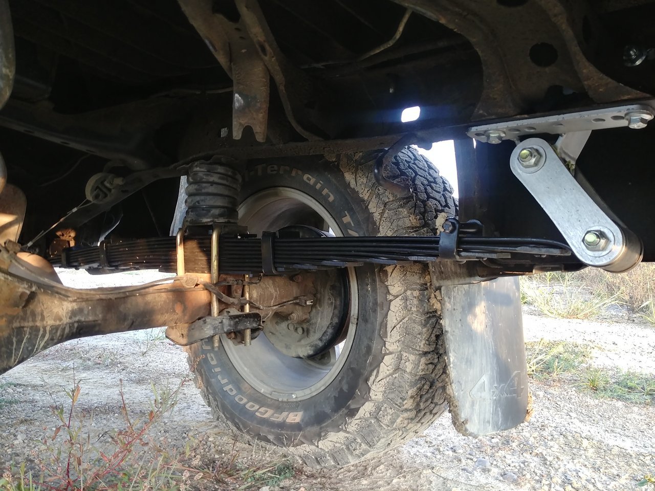

    Custom painted 6112's Fox 2.0 12" in the rear Allpro expedition leafs (garbage) Pelfreybilt aluminum single hoop front Full size pickup bedslide modded to fit Satoshi grill Ubolt flip kit Archive garage shackle flip 5" Sumo supersprings 1500lbs SPC uca's Full set RCI skid plates Weld on sliders ABS killswitch Pop'n'lock power tailgate lock Falken Wildpeak mt on FJ rims Plastidipped emblems Ebay projector headlights Smoked aftermarket tail lights High output led reverse lights Hella horns 330w 5d led bumper bar 18w spots on track facing rear (fuck you lights) B&m trans cooler Bussmann fuse box ECGS bushing Big 4 (0 gauge ofc wire) upgrade Mechman 240 amp alternator Jl 10w7 in a 1 1/2" thick wall custom box Alpine 1000w rms mono amp Group 31 AGM battery installed next to sub Yaesu 2800 Bearcat 980 in dash with wireless mic and stainless whip Diff breather mod Hilux snorkel Turbine pre filter Baja Rack low profile cab rack Rifle case on rack Shovel and axe on quick fists in bed Flat and spade shovel mounted in bed Highlift mount in bed Tech deck with magnetic ram mount Tab s7 on ram mount
    Bumpstops are sumo springs for a tundra
    Wheeler's extended stainless brake lines
    I modded my brackets for the parking brake for more slack
    Longer ubolts
    If I remember anything else I'll let you know. Buy a set of carbide bits.... Cheaper than buying singles. I destroyed the 1/4" bit but the rest are still usable.

    Thanks man. Appreciate the help. I'm not even mid travel yet.. :( I won the archive shackle flip kit through their Instagram contest.

    did you add these to provide lift or better articulation off-road?

    Both. I had a 2" block+aal which gave me 3.75 lift in the rear and some long ass shocks. I wanted to replace my stock leafs so I jumped on the allpro expos when they were on sale. That only got me to 3" so I decided to replace the shitty shackles and mounts to bring me to 4". I didn't want to run another block. The times I have gone we've only really done rock crawling stuff. Plus not being locked means the more tires on the ground the better.

    Can you tell me your hub to fender measurements with the flip. I have the expos and was wondering how much list the shackles would create.

    25" 7/8. Foremost position on the mount (1 new hole drilled) with 5" shackle. The stock kit comes with a 4" shackle. Looks to be a 35 degree angle on the shackle.

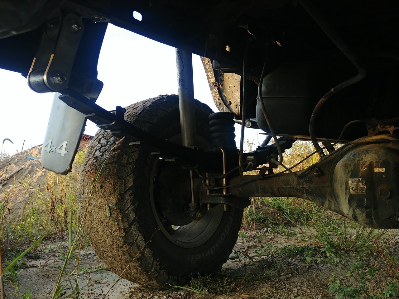

    Do you have the PN to those Fox shocks?

    Fox performance series 2.0 shocks
    BDS suspension rear shocks 4" lift
    Pt#98224953-1
    They seem to be part of a lift kit by bds. I had a hard time finding info on them by themselves.
