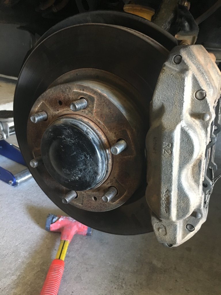

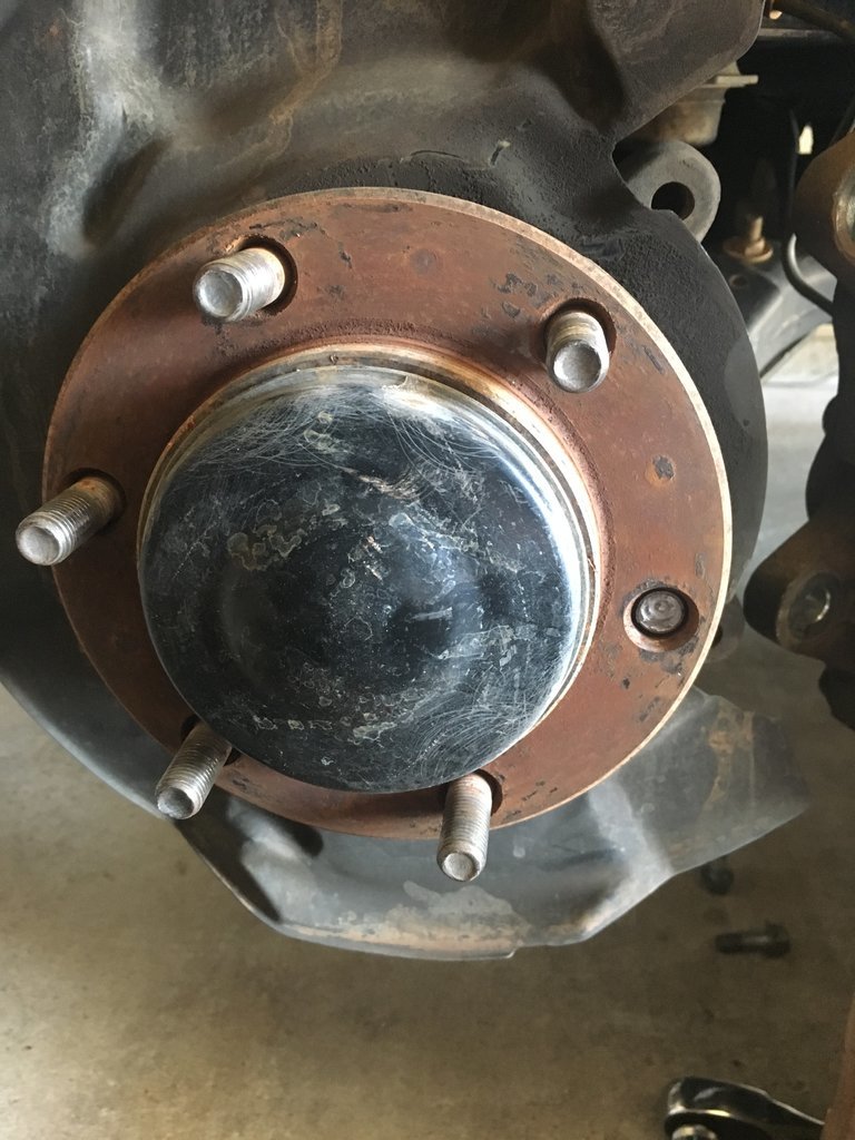

    Looks like a 3 inch lift, P285 70 R17, BFG A/T KO2

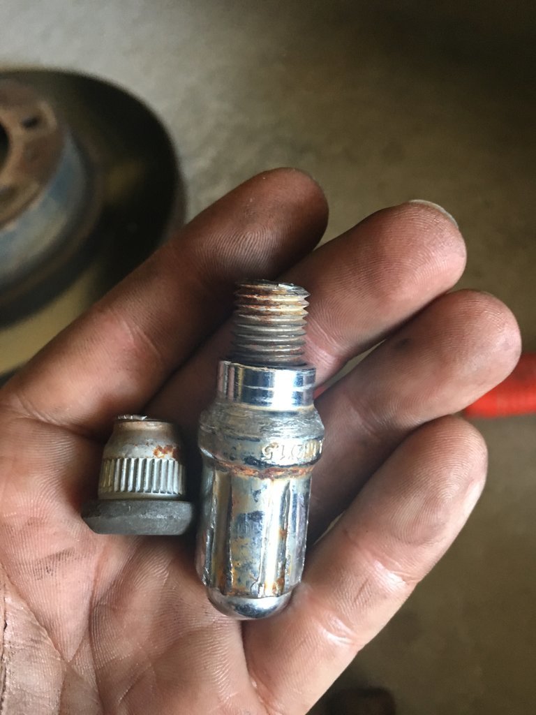

    How did you break it?

    I had a broken stud with those same lugs

    Yea, those lugs appear to be from Gorilla Lug Nuts with lock key. I have those on my wheels but have never had any problems with broken lugs before (and don't plan on having any either).
    Could be that at some point they were "excessively over-tighten lug nuts"....or :notsure:
    Also this is where using basic "torquing down lug nuts" on your wheels is of importance and "in correct order" regardless of what type of lug nuts you use.
    But overall if one is destine to break....it's going to.

    Mine happened to be cross threaded by the shop i brought it to when I had the tires rotated and aligned.
    Rode around on 5 lugs for about a year. NBD

    I broke a wheel stud once, many years ago, that taught me the importance of proper torque. Now they always get installed with a torque wrench and anti-seize. Never had one freeze up on me since.

    Discount tire had to over tighten it, I always take it there for my free rotation and balance. Took it today and couldn’t get it out so I tried it and snapped. Bet they knew it was about to happened..

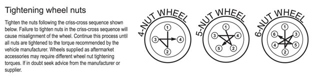

    This is why anytime after getting new tires, rotation, flat changed, etc. the first thing I do is drive straight home and "torque the nut lugs" in the proper "sequence order" and with the correct torque value on each nut lug so that at least I know that it is done the right way, more like piece of mind.
    Yes you can ask them to torque them down and they say they do but I really don't believe them. Not only that they don't follow the proper sequence order as well, when doing so (that is if they do torque them at all).

    Lug nut locks and impact tools do not mix.

    Yeah those are either installed wrong or the designer did them wrong.
    Stars should always be toward the front.

    I know exactly what you mean. This is why I carry a click type torque wrench specifically for this purpose cause well you never know if you might just encounter having a flat tire, blow out, etc. and when changing the tire, the nut lugs get torque down in proper sequence.

    This info is what I found off the internet concerning this subject of nut lug sequence:

    If the people servicing your car are using rattle guns without torque sticks to put your lug nuts back on you need to stop doing business there.
