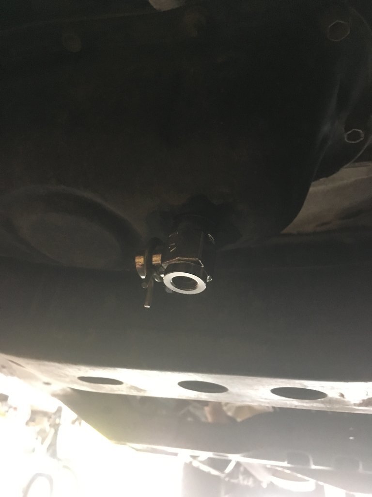

    Not very familiar with it. Is there any danger of it hanging up on something and dumping your oil out?

    Probably has about an inch of clearance under the crossmember.i dont do any gnarly wheelin so is very safe.

    If you wheel then a good chance of damage but that's what aftermarket IFS skids are for :thumbsup: However if yours a mall crawler/pavement princess then I wouldn't worry.

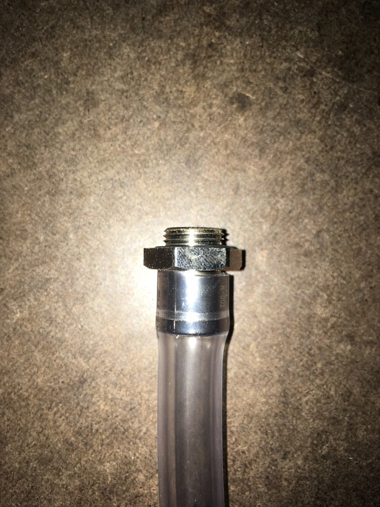

    Must be the week for it...just installed mine that has been sitting in the garage a while waiting on the 180,000 oil change. I went with the nipple version, but it has a threaded end. I just left the nipple in the hose and will thread it in when needed and out when not so as to not hang down any further. Best of both worlds. Rest of the change was Mobile 1 full synthetic and an OEM filter.

    Yeah mine looked like a washer was welded on as well when I installed it 4 years ago. I didn’t put the included washer on. Been fine since.

    It is the EZ-103 from http://www.oildrainvalve.net/Toyota/
    Same principle as the Fumoto just like having the option of the threaded nipple.
