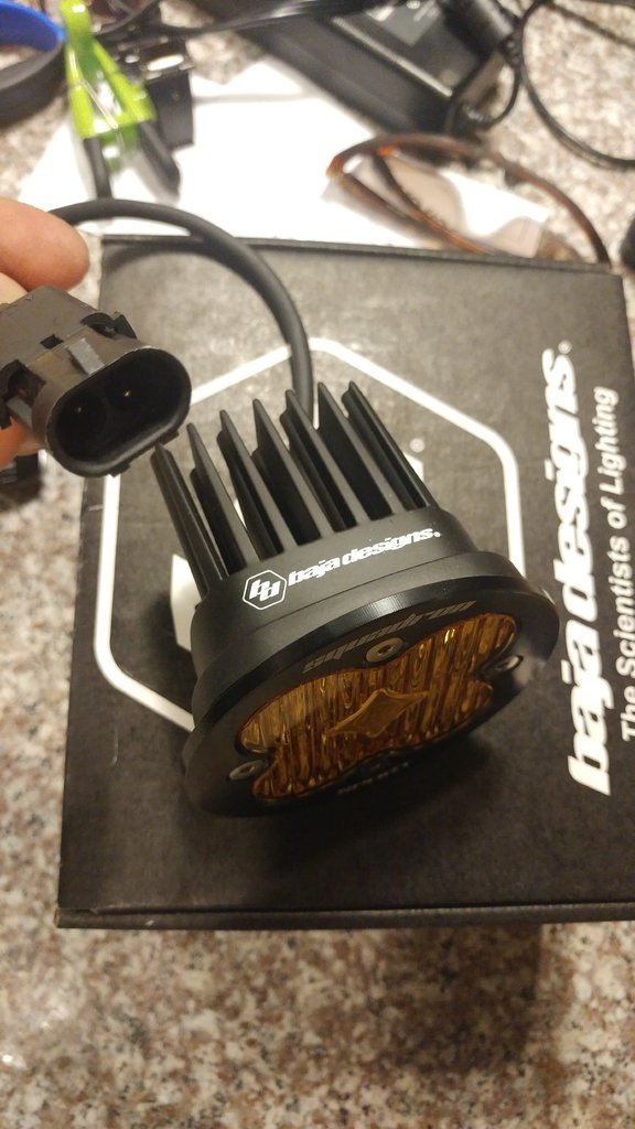

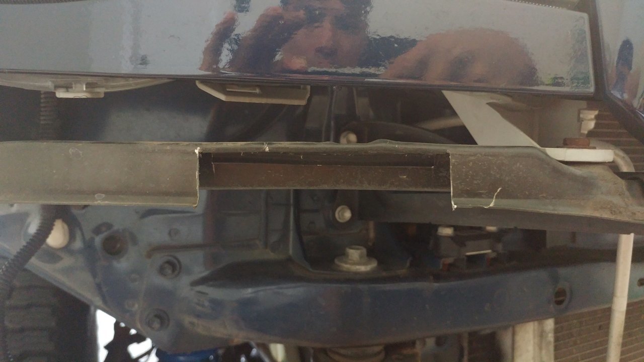

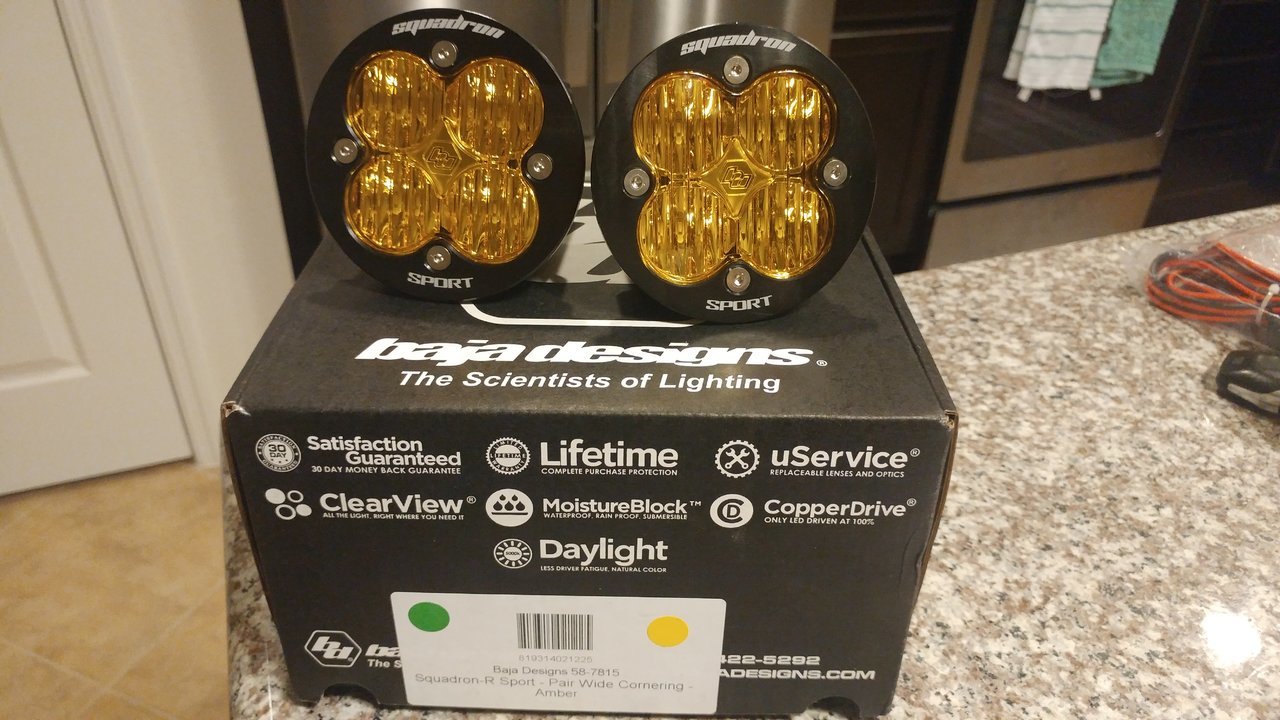

    my squadron sports by baja designs came in last night. tackled the install this morning when I woke up
    First I started by cutting identical notches on that metal bracket just below the headlights for clearance.

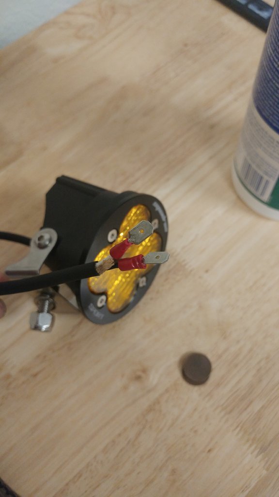

    I then decided to cut off both connectors on my oem fog light harness and the squadron sport fogs and crimp some male / female connectors on them and just wire them straight to each other seeing as I didn't have an adapter. Correct me if i'm wrong but I read somewhere our stock wiring puts out 55 watts? The squdrons only call for 20 watts so I figured they'd be fine just straight wiring them and running the stock 15 amp fuse.
    Before:
    After:
    I then shrink wrapped each lead individually so that they would not come in contact with each other and to also help a little with the moisture and tucked them up under the bumper with a zip tie. Finished product.

    Looks awesome! But for any electrical connection that is exposed to moisture or the elements, I think a solid sealed solder connection or these marine adhesive butt connectors would be a better option... Your truck, your call though.
    -Coming from someone who has had to chase down a lot of marine electronic gremlins!

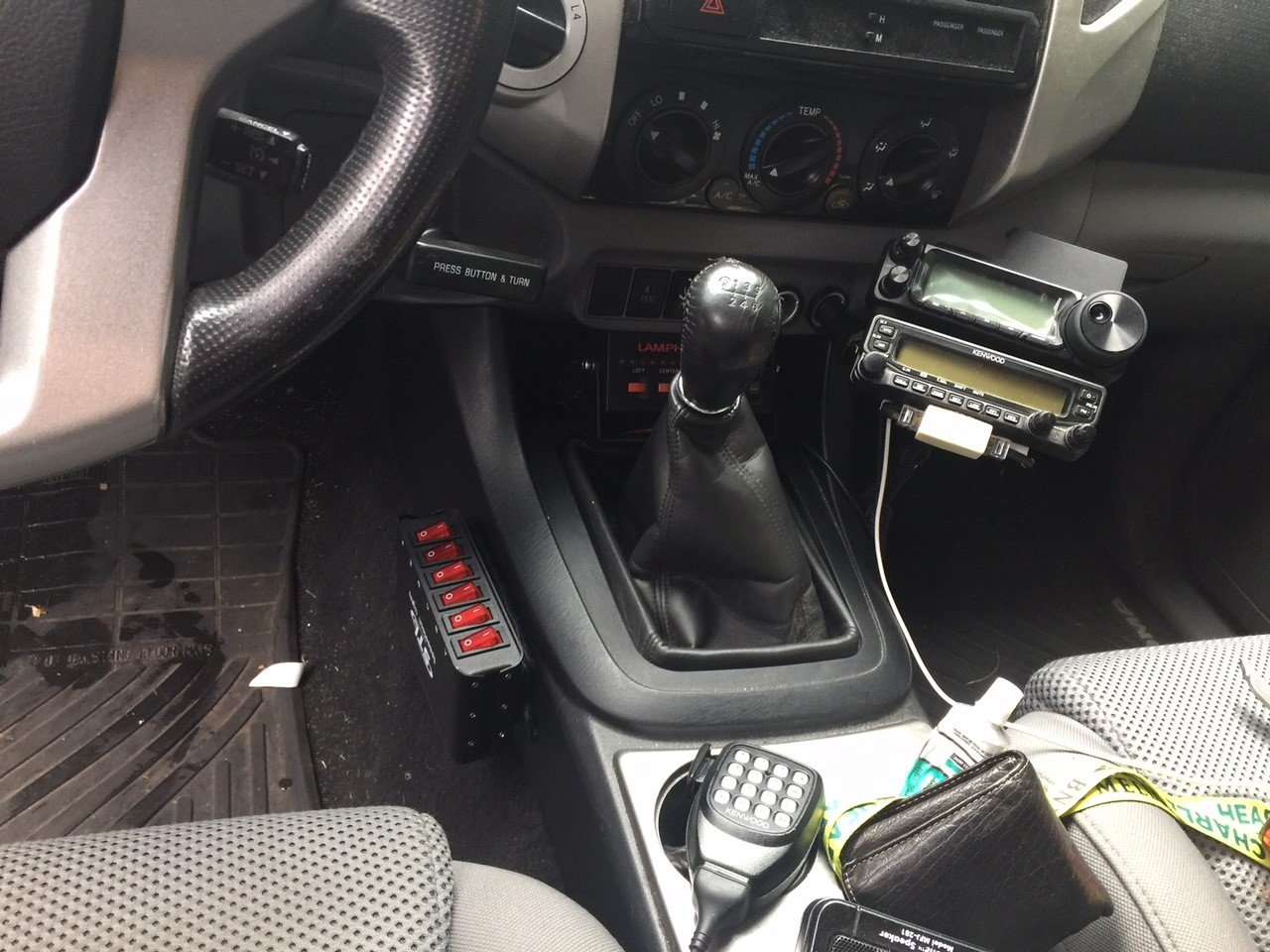

    I just put some lighting (albeit emergency, lighting is lighting) on my truck a week or two ago. I went with a small switch box with rocker switches that illuminate when actuated. It was $30 from Amazon, and I used some silicon adhesive to attach velcro straps to the driver's side of the center console trim panels near the foot well.
    (Okay, so the 6 switch box is sold out now, but they still sell the 5 and 4-switch boxes. https://www.amazon.com/SpeedTech-Li...d=1508255080&sr=8-6&keywords=speedtech+switch)
