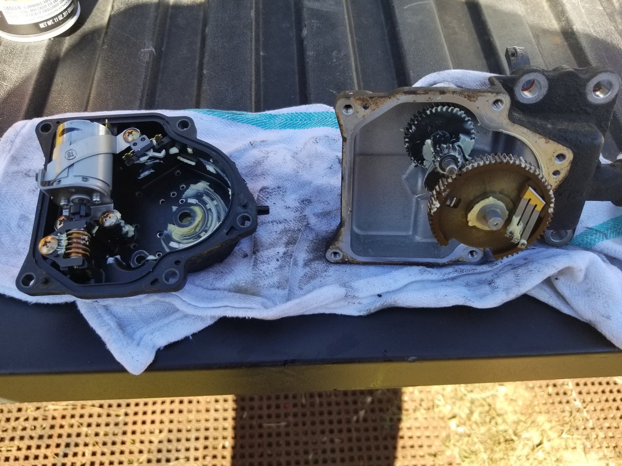

  13. Oct 22, 2017 at 9:07 AM
    Ted Yoder
    Ted Yoder Well that didn't work
    Jul 29, 2016
    #193220
    462
    06 DCLB
    In Progress
    So I know this has been covered in other threads but it's worth showing IMO. I tore my front ADD apart today since it will activate just fine when the trucks cold. But drive it for 25 or 30 minutes and I get the 4hi blink when I try to engage. 204k on my truck and this is what the inside of the ADD looks like.
    Looks brand new but I haven't been gentle on this truck.
    Then I noticed this.
    I'm going to do some cleaning and bending of contacts, add a little contact grease and see what happens.
    No arc marks on the motor either but I still might solder.
  14. Oct 22, 2017 at 9:20 AM
    MNMLST
    MNMLST Well-Known Member
    Aug 22, 2017
    #227659
    1,891
    Earth
    tinfoil lined cab runflat headlights pee-thru seats
    I tore a starter solenoid apart on my '99 some years ago at about 150K mi. Everything was scorched as hell inside, not just the main contact, but the relay/solenoid plunger thingy contacts... the point: clean any and all contacts you can get to in the whole circuit, beef up and solder everything you can reach, grease or lacquer the connections wherever you can... good, 'clean', 'fast' current.
  15. Oct 22, 2017 at 10:24 AM
    Ted Yoder
    Jul 29, 2016
    #193220
    462
    06 DCLB
    In Progress
    Yessir...no pics but done and done. Even applied power using the Power Probe. Smooth operation. Even busted out the good grease.
