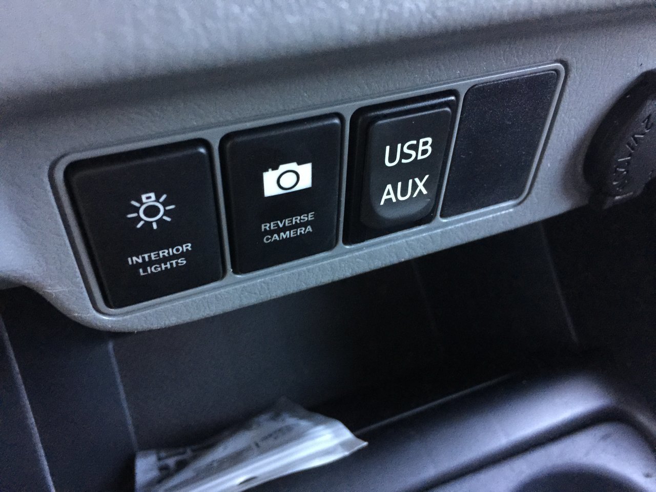

    What year is your Taco? I have the reverse camera switch, but I haven’t wired it yet. Do you have tips/video/instructions?

    2015.
    Nope, had some friends of mine over at Crow Concepts do it for me.
    I got my switches from Air On Board.

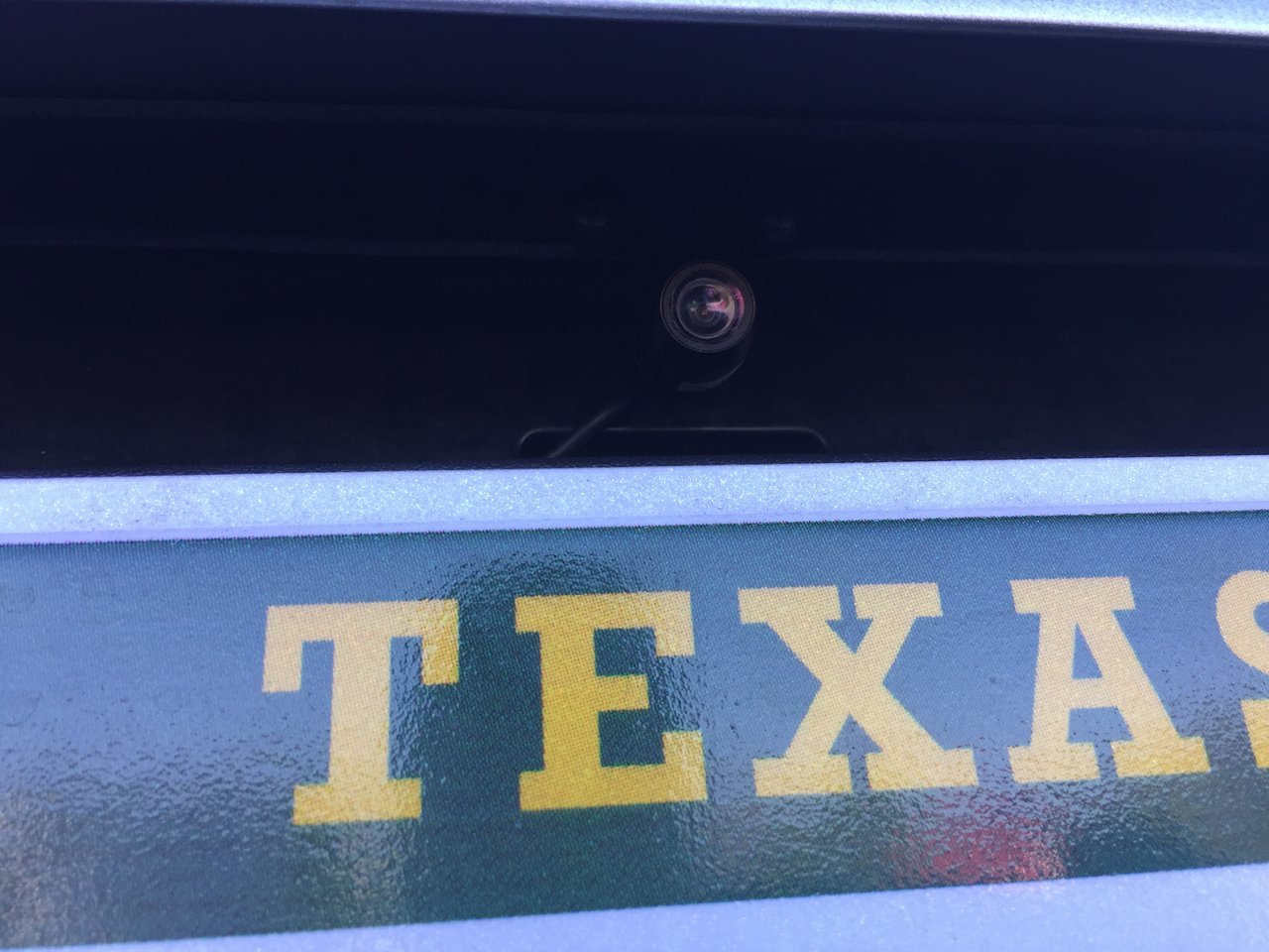

    It's so fun to watch the camera while you drive. Dangerous, but fun has to be dangerous aaaaaammmmm iiiiiiii rite?

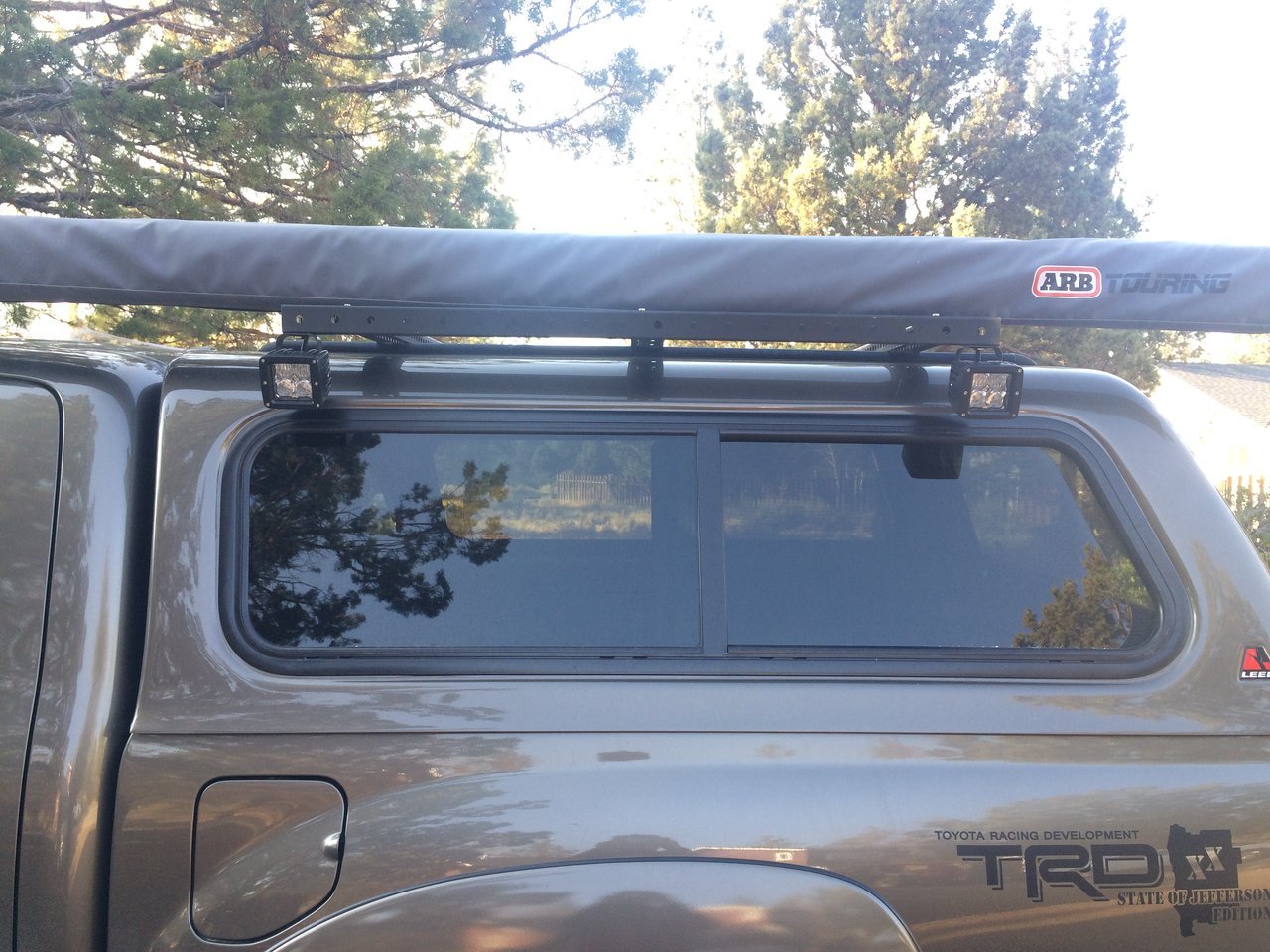

    Mounted up some bright ass camp lights but looking for the best way/route to get power with keeping wires hidden, think I’m gonna need to drill a hole in the camper shell...any ideas?

    pictures of the lights and where they're located would help.

    Hit post before I was done it was on accident pic is up

    Mine is a 2015 as well and my switch is from air on board. I just don’t like doing wiring.

    I hate the idea of drilling holes in the cap personally. I believe I'd look into running the wires up between the cab and the bed, put a quick connect just below the level of the bed, and run the wires up to the cap rack and out to the lights. If you use a duetsch connector it'll be water tight and you can get the little things with the sticky bases to stick to the bad and cap that you run zip ties through to secure the wires. That way they'd also be tucked mostly out of sight and look nice and neat IMHO

    This also being with the wires in some sort of loom or covering

    I like it now I’m getting ideas thank you for saving a hole in my cap!

    Well it's just a thought. I figured the quick connect would allow you to remove the cap in one piece and the wires would be at least some what hidden. It's kinda hard to explain I was just thinking you'd have your relay for the lights mounted in the engiine compartment then youcould just run the wires under the cab theough the frame and up the front of the bed to the connection. If you ran them up the front of the cap they'd be in between the cab and cap and fairly out of view then they could just be run over the cap along with the track on the roof, to the rack and out to the lights. Not very visible and no holes
