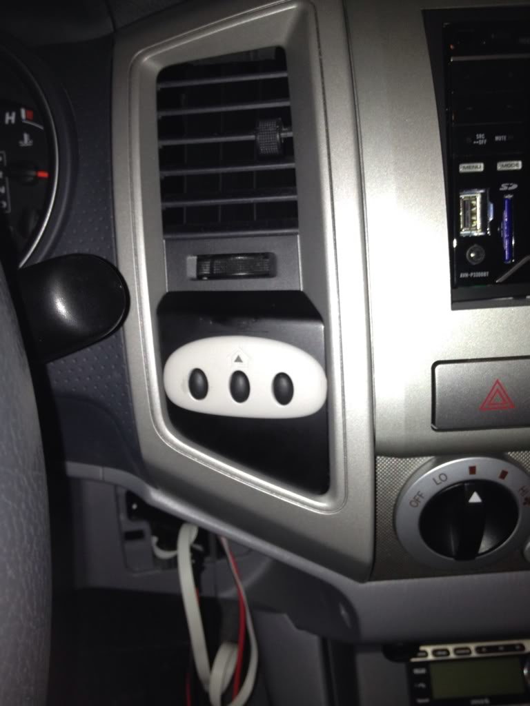

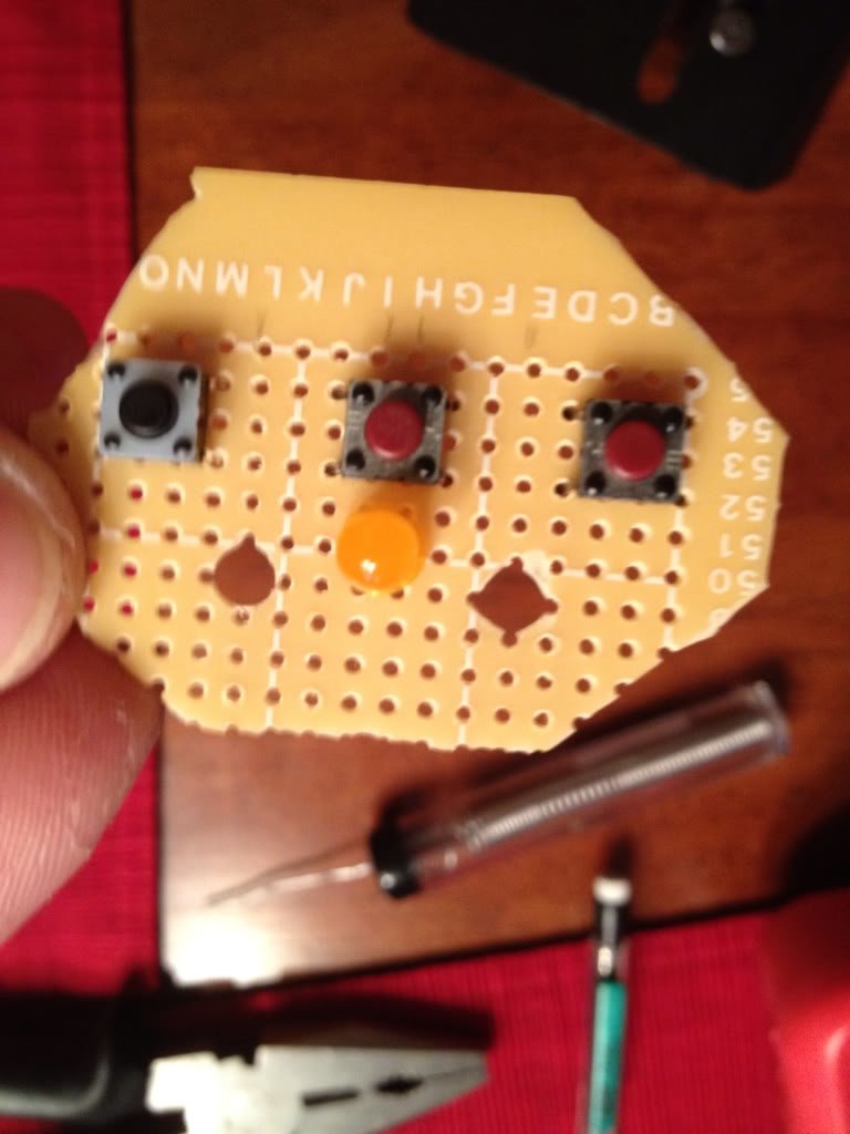

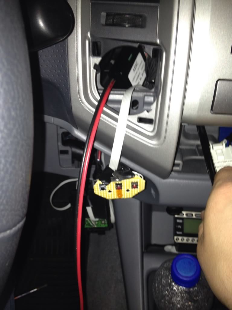

    Didn't do it today, but just got around to uploading pics. I put my homelink in the blank on the left hand side of the radio! Only good or 2wd's, but another option for those not wanting to cut into the headliner. 325d44c0_81ca53eb126a79db6c1e57be974ee0520e17f72b.jpg

    Very neat installation! Which kit did you use?

    Nice, I have the homelink modual and was wondering if I could place it there. Thanks for the example. I'll start mine soon.

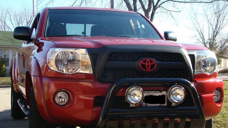

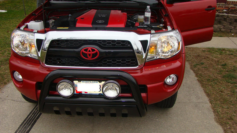

    I decided that the chrome grill had to go. I now need to replace the headlights with
    some cool black projectors.. Before and after pic is included.

    How did you get the box to mount to the back of that?

    I ordered a rolling code Homelink off of ebay. They run 15-25 bucks. I hated having to fumble around the separate one, and the range is way better with the Homelink.

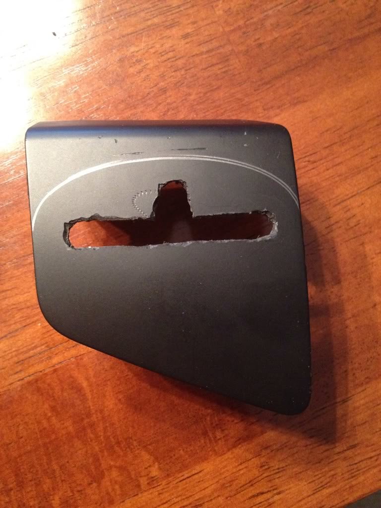

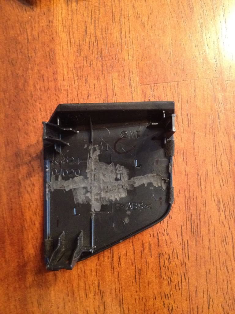

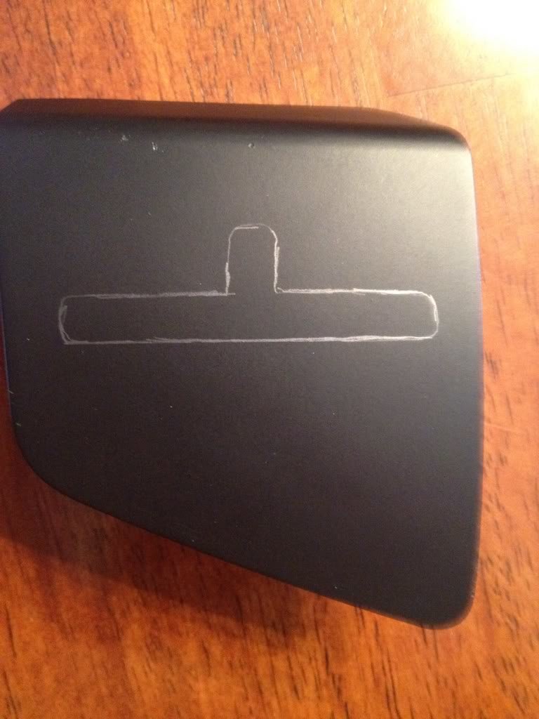

    I made a separate panel and mounted it remotely from the actual homelink box. I used a couple ideas from the threads here on TW, and this link: http://www.lieblweb.com/homelink.html
    I cut the part of the Homelink box that mates with the trim and buttons to snap it together onto the stock trim piece. I had to use two #8 screws and grind the heads flat (they sit behind the trim) to hold my board to the buttons. It took a little work, but it came together in the end. Here are some more pics:
    *Rough Cut*
    I'll try to do a full write up this weekend, if I can find the time!
