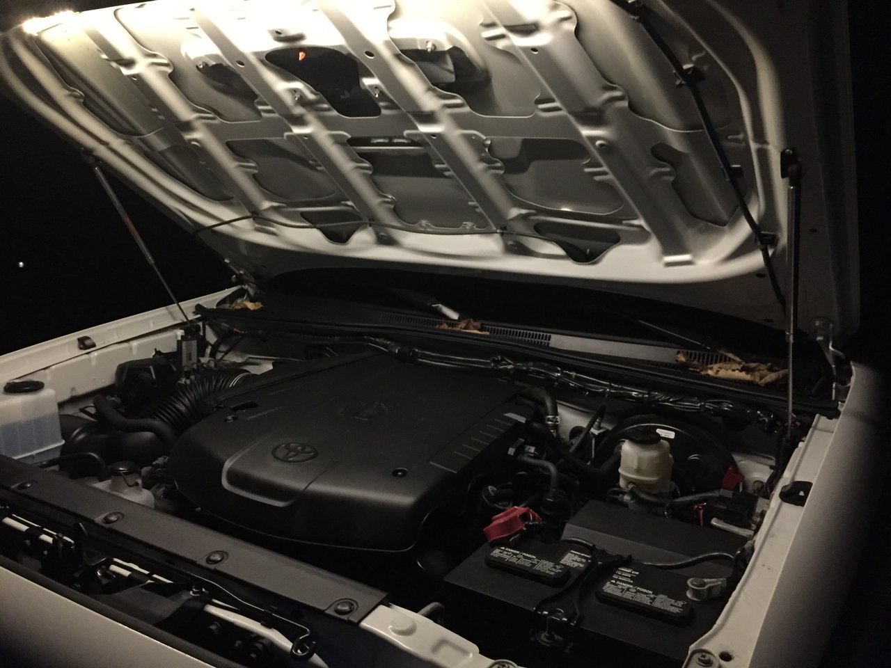

    While I was at it I thought I should finish a few other nagging projects. Amazing how much time the truck can get with the wife away for the weekend. Installed redline hood struts. While I was there I decided to install some lights under the hood. Found a handy switch that allows the lights to only come on when the hood is open. All considered about a 2 beer project.
    Finally no more clumsy hood prop!
    Satisfied with neat-enough wire routing
    What a handy little switch
    And at last, let there be light! And lift!

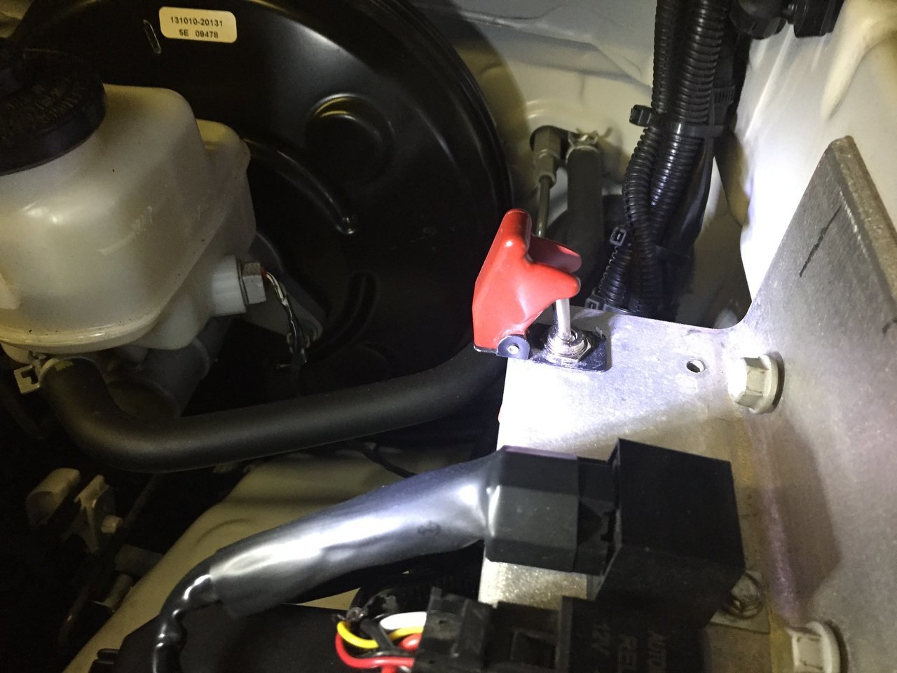

    I just did the underhood lighting a little while ago and the hood struts. I had the same switch but wasn't happy with it after a little while having the lights always on so rerouted the wires to the auxillary relay panel end installed a toggle switch with a protector "hellicopter switch" now I just turn them on when I need them on. Nice clean installation man cool job

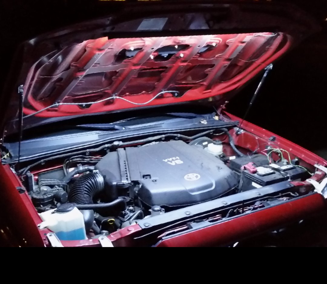

    Screenshot_2017-11-12-18-31-11-1.jpg Just finished up Mr Geckos hood light kit. Its waaaaay brighter than what I thought it would be , which is great . I havent finished hiding and tucking wires yet .

    What wire did you tap into in the dtrl circuit for the Raptor lights?

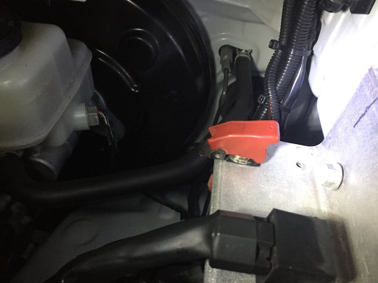

    Sorry I was cooking dinner and eating
    This is the switch in the closed or off position
    This is the open or on position. You lift the red gaurd and flip the switch on seperately the guard just prevents it from being turned on by accident. To shut it off lust close the guar and it shuts the switch off as well.
    The plunger style switch usually works by interupting the ground circuit, at least mine did. I just grounded to the body ground by the battery. I attached the positive directly to the battery with an inline fuse and then ran that to a 2 pole toggle switch and then out to the lights.
