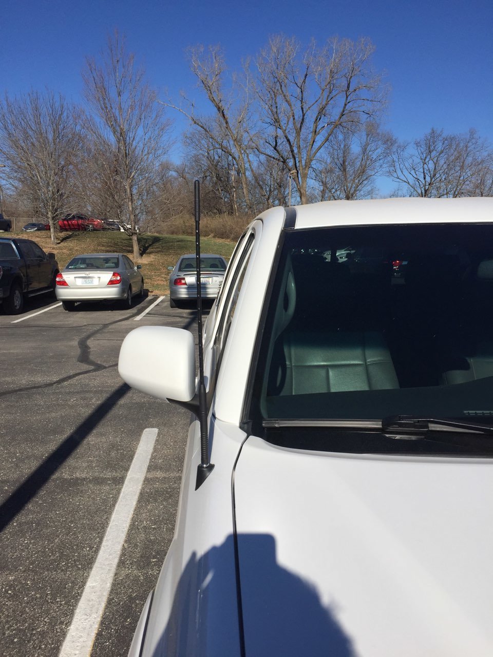

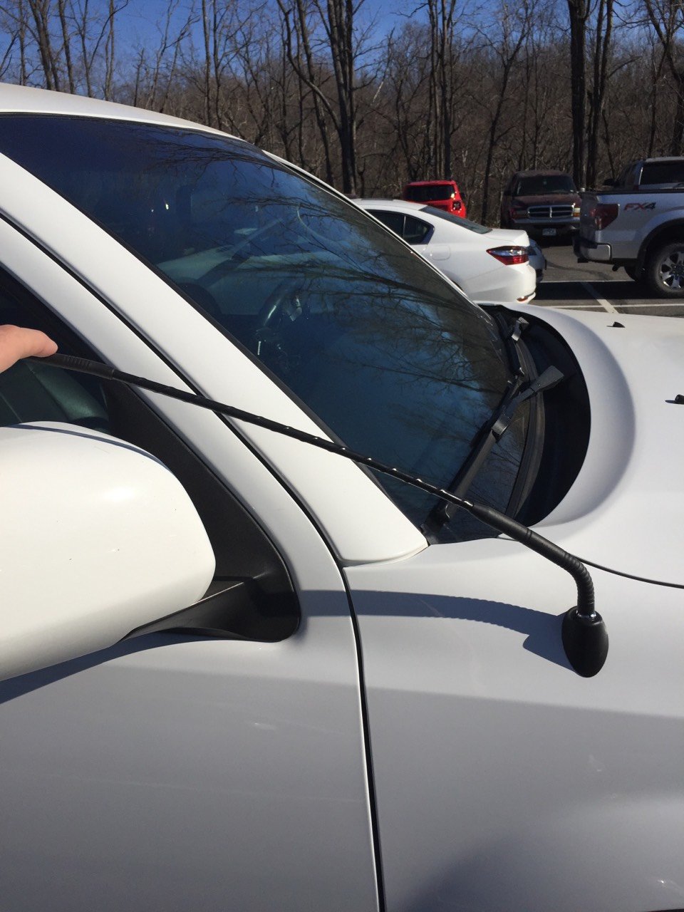

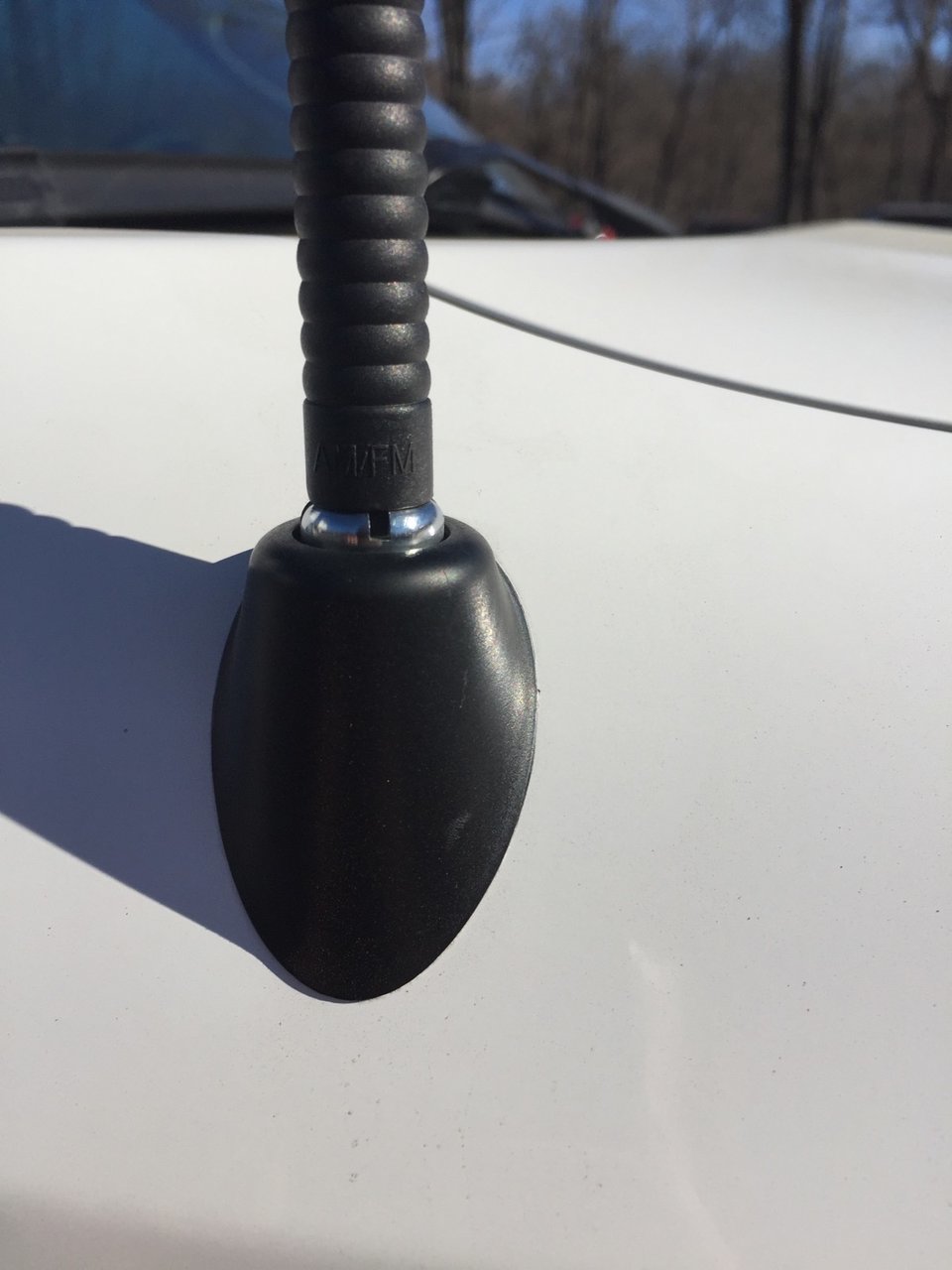

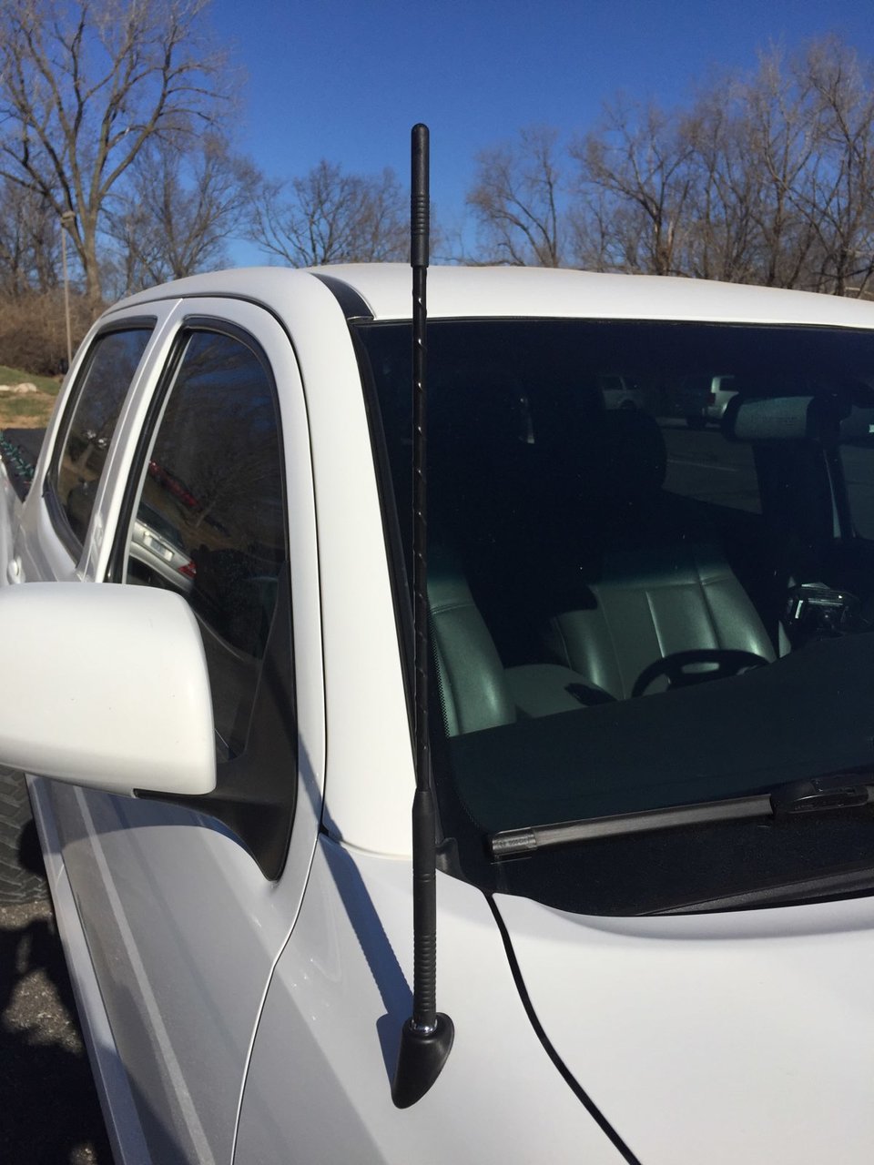

    Got rid of my old 14" antenna the thing would whistle like crazy at highway speeds and gets worse when it's cold outside. Replaced it with a $11.25 Harley Davidson knock off antenna, which is a little bit longer at 19" but has the spiral deflection to reduce wind noise plus it's flexible at the base in which it won't break off when off-roading or comes in contact with tree limbs.
    PLEASE NOTE: that this wasn't quite a plug-n-play though!
    They provided like 7 or 8 different stud types, so one end is the same size and type for threads that screw into the antenna itself while the other end of the stud has a different size with either fine or coarse threads depending on the base of your antenna mount. The only issue was that the transition from the antenna to the part of the stud that screws into the base of the truck wasn't quite long enough and the transition was too wide to fit down into the base on the truck so I took a file and filed it down to get it to fit, but took like 5 minutes to file the stud down all the way around the transition point to get it to fit. But for 11 bucks I'm pretty happy with the fit and finish of it.
    Here is the link if interested:
    https://www.amazon.com/Metra-44RMMC...=1513102569&sr=1-89&keywords=davidson+antenna

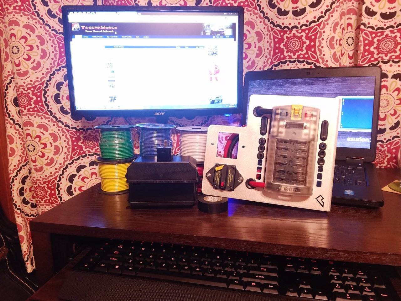

    Got everything I need for this now! Decided to get some dedicated wire for this project for my waterproof relay box I'm building since I'm redoing all of the shit I've done. Not pictured are the parts for the next project: some led lights and a switch pin to install underhood lights, 10 eagleye LED bolts to install in the wheel wells and possibly replace the aux reverse lights I have in place now.

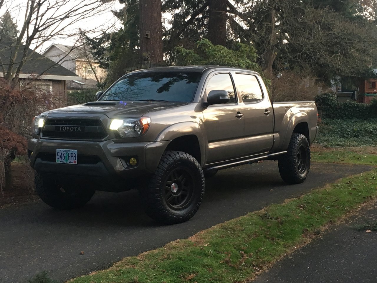

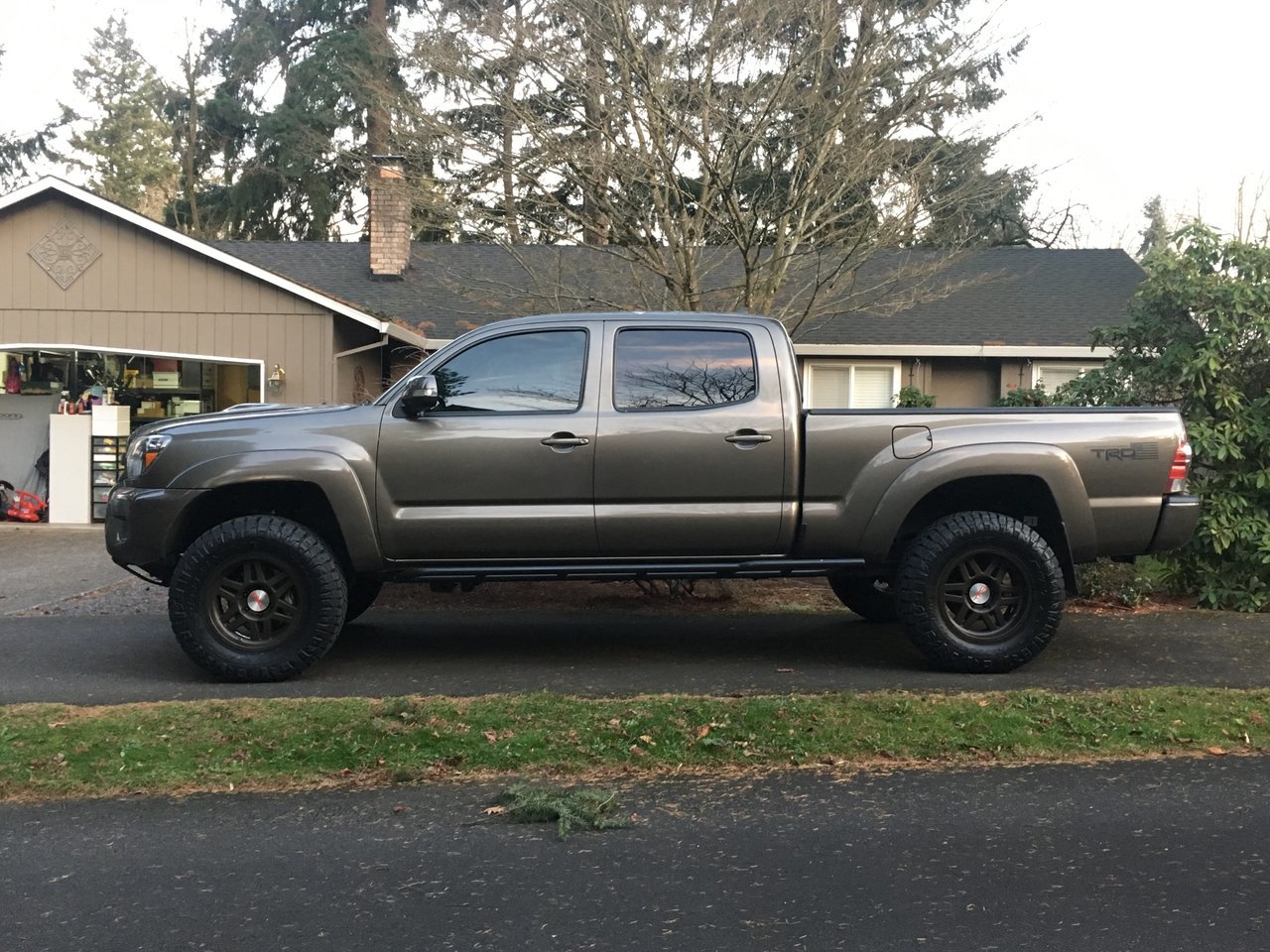

    Someone moved up to the 285 class... Love the look.
