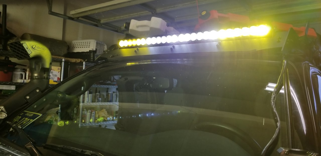

    Just a few LEDs...
    I recognize those likes. :thumbsup:

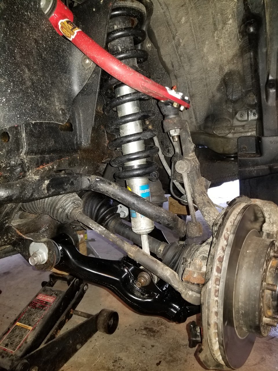

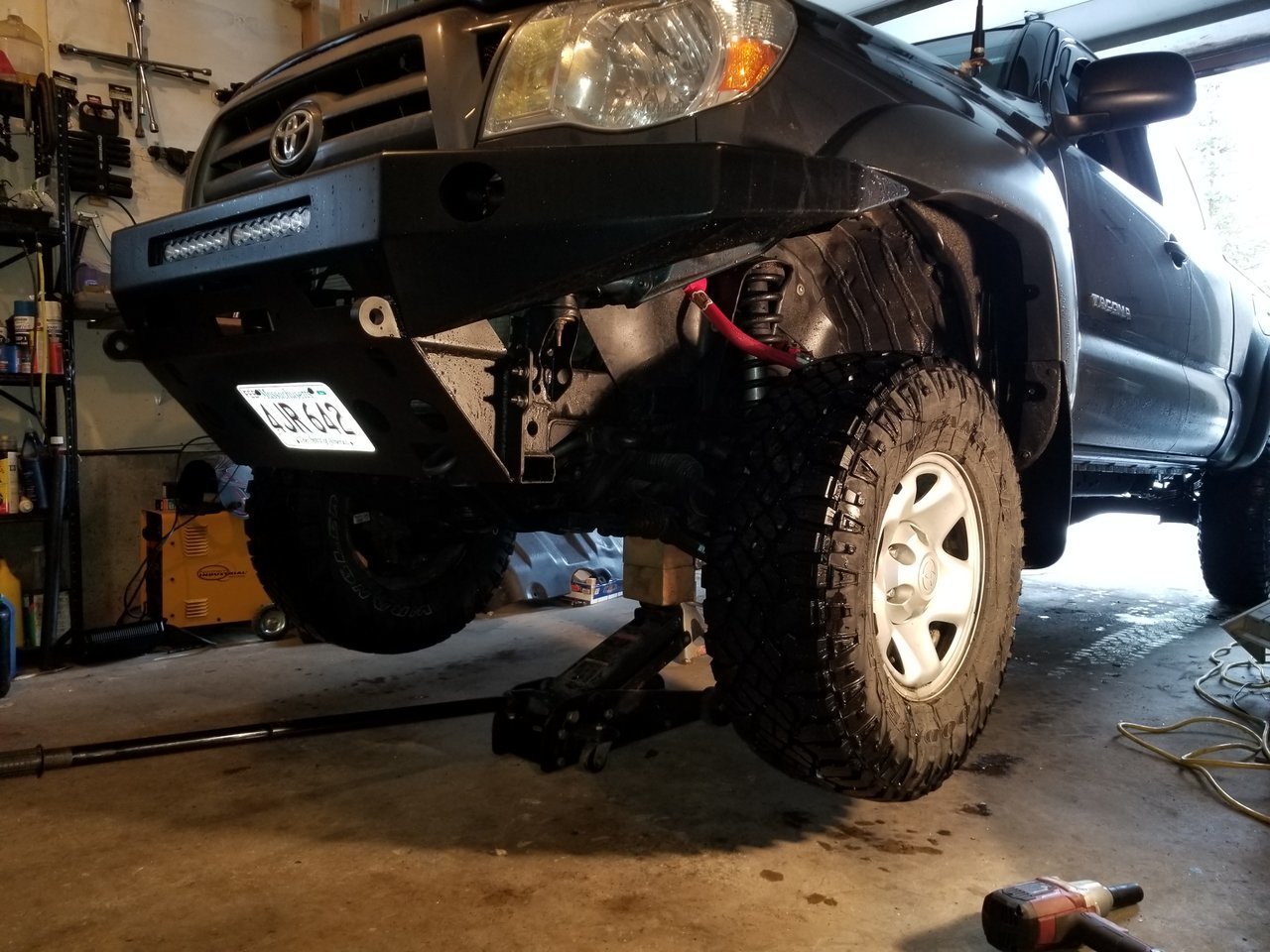

    Upgraded from stock coils preload lift to OME 884s with JBA uppers on Saturday. Ended up having seized lowers so I just went new moogs. Got those done today! Also threw a 1" block on top of the AAL I had in there. Stance is perfect now. Will get a side shot tomorrow.
    I used a 3/8 poly spacer to compensate for the lean and I'm measuring exactly the same both sides.

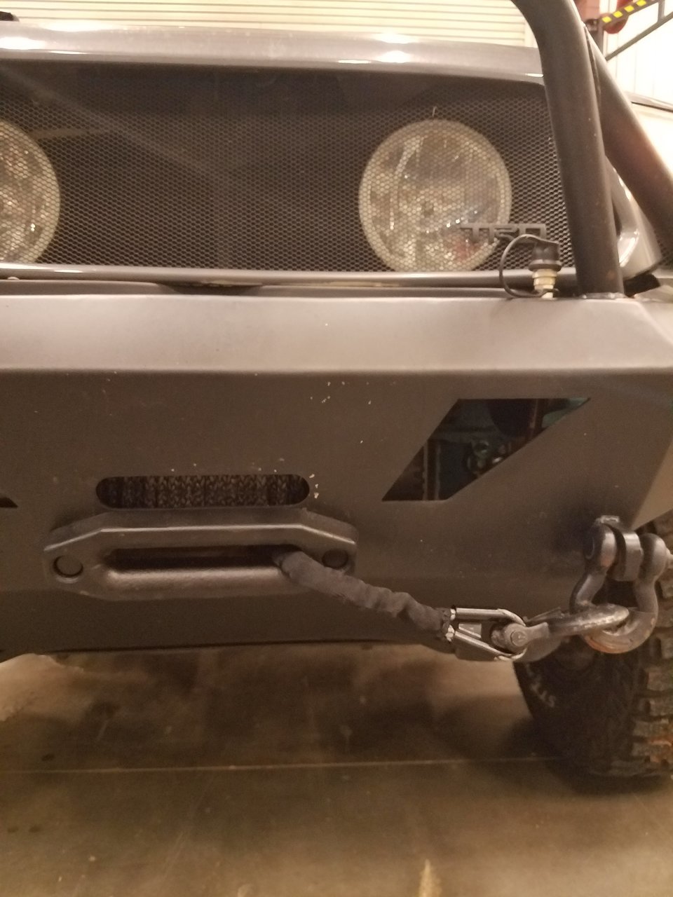

    Fixed my fucked up fairlead. Hit it on a curb at the mall the other day.

    Randy don't you know by now just how dangerous malls are? Your going to need to invest in more armor for that
