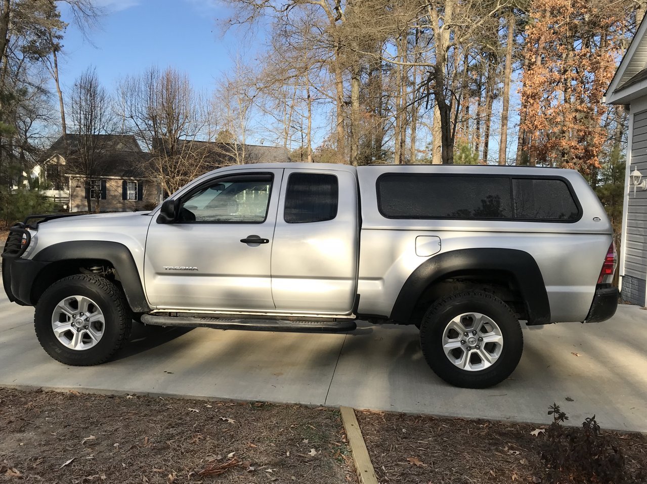

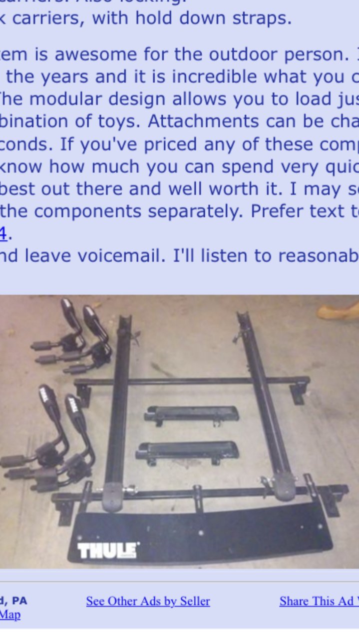

    Bought a cap off of buyobuyo (thanks again for the help with the wiring) and am piecing together a Thule rack for the cap. Got everything in the Thule pic for $200. Anyone have TH460 feet and/orTHKIT3101 fit kit lying around they want to sell?

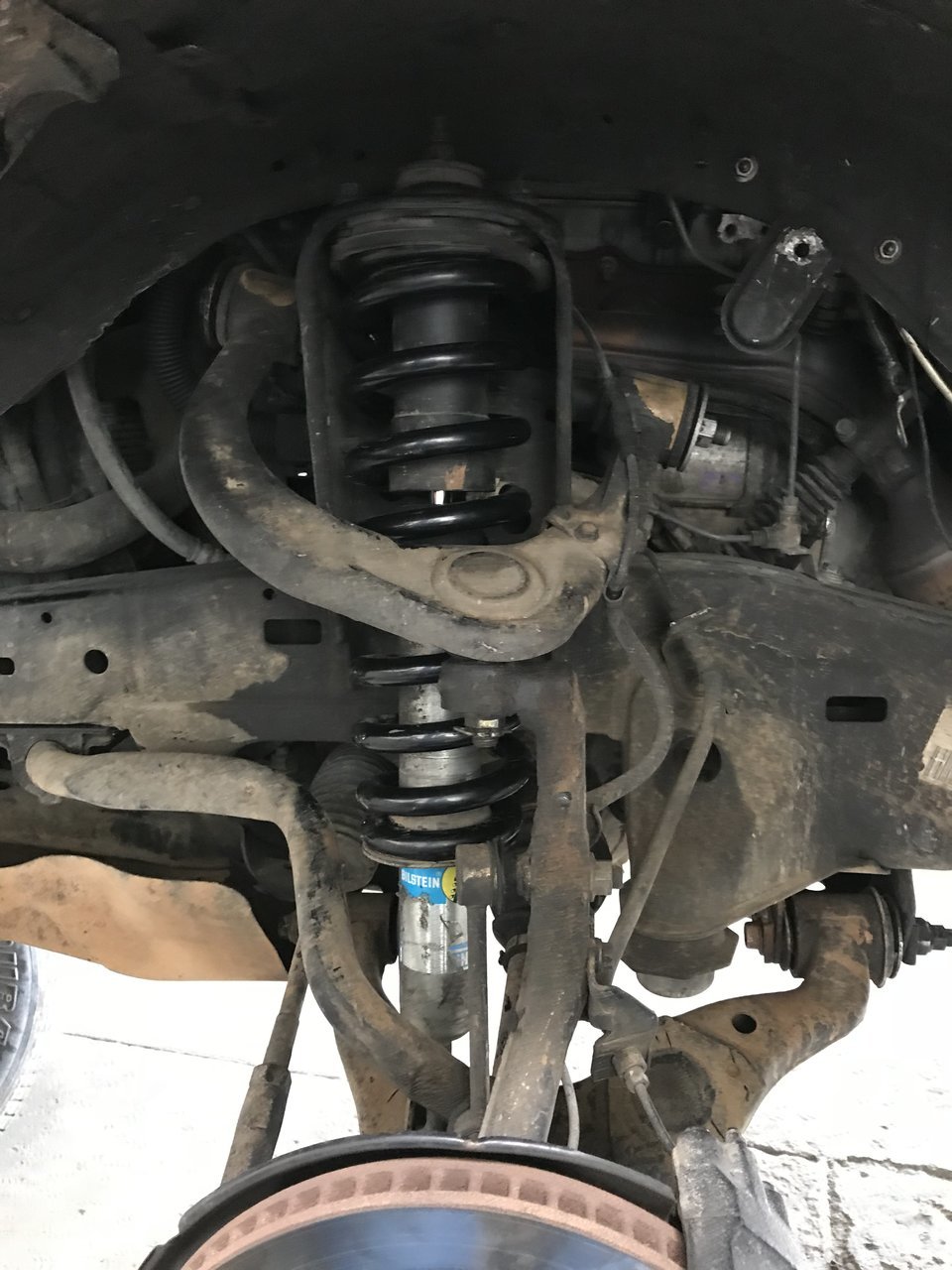

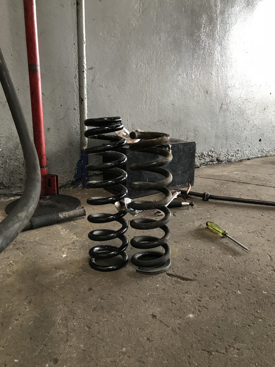

    Installing OME 885.

    Nice you will like the ride man

    Looks good, Joel.

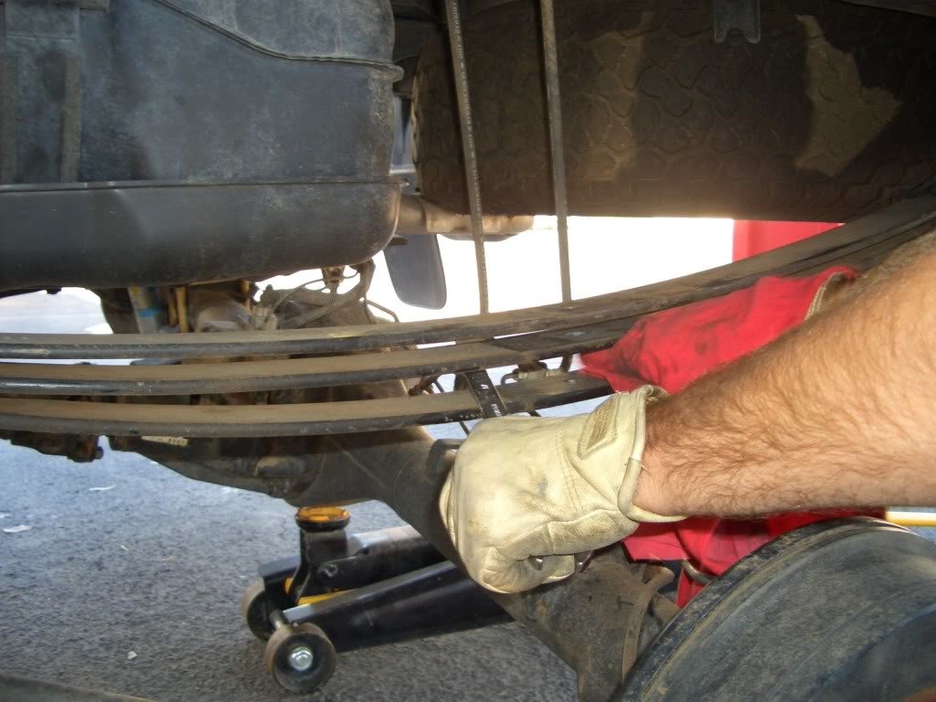

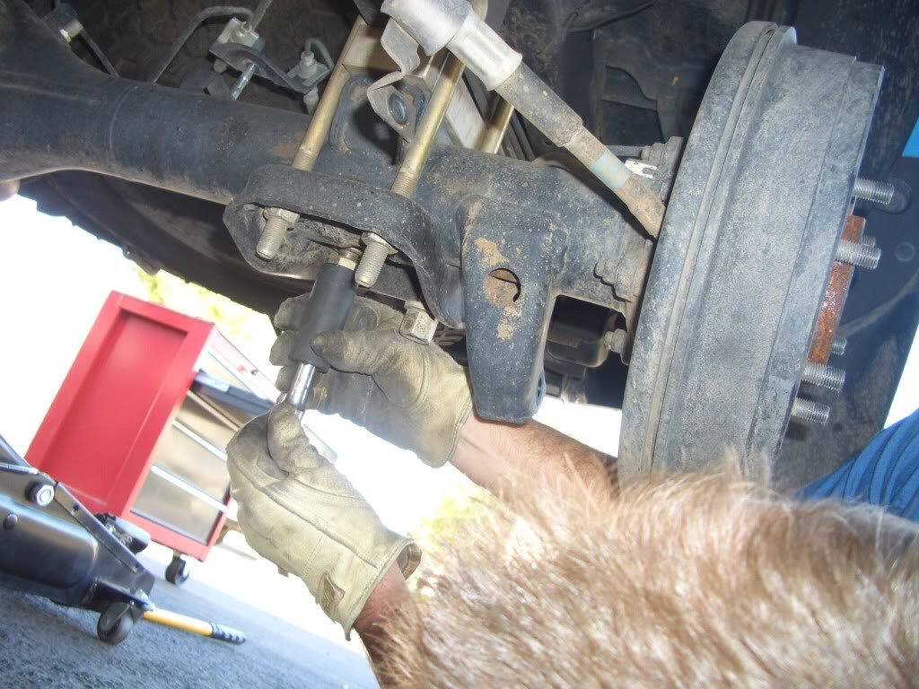

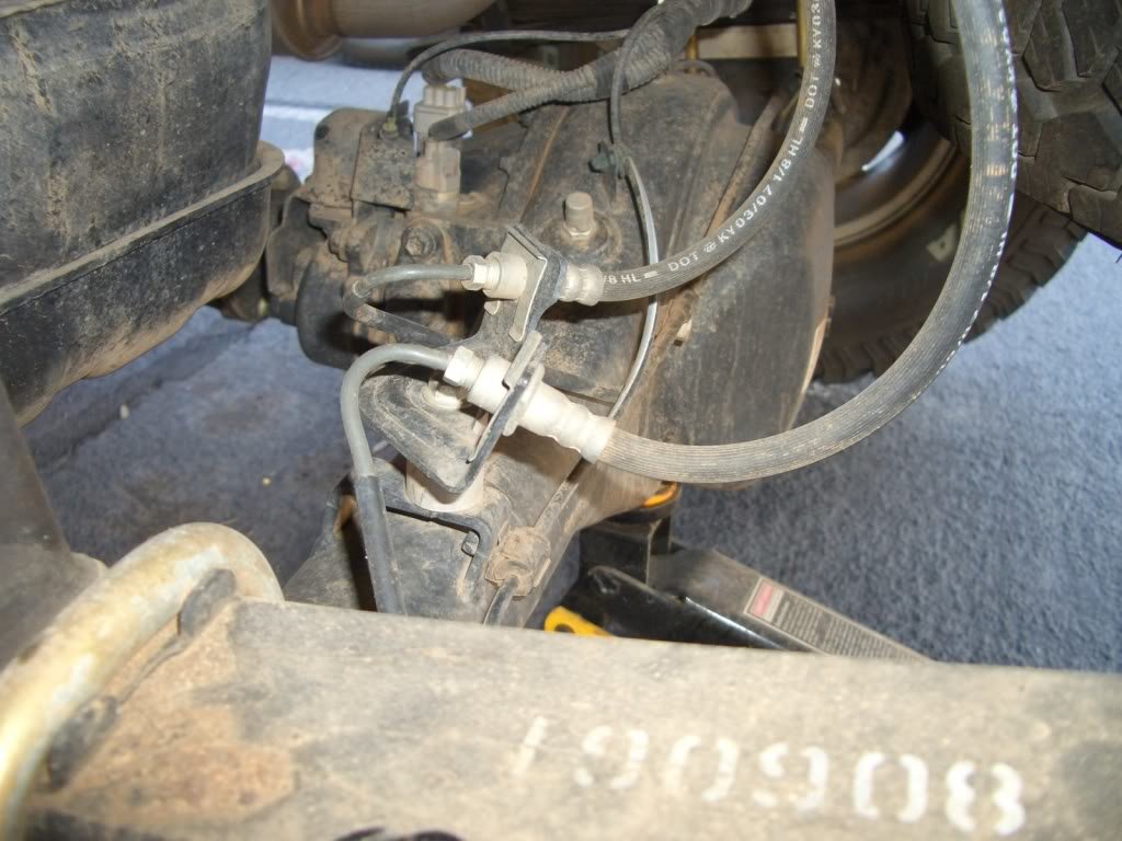

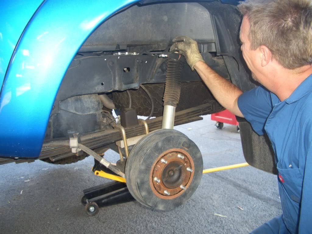

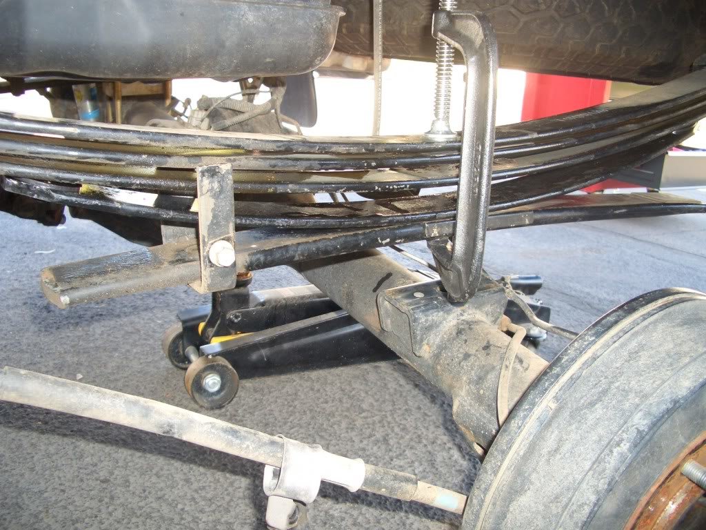

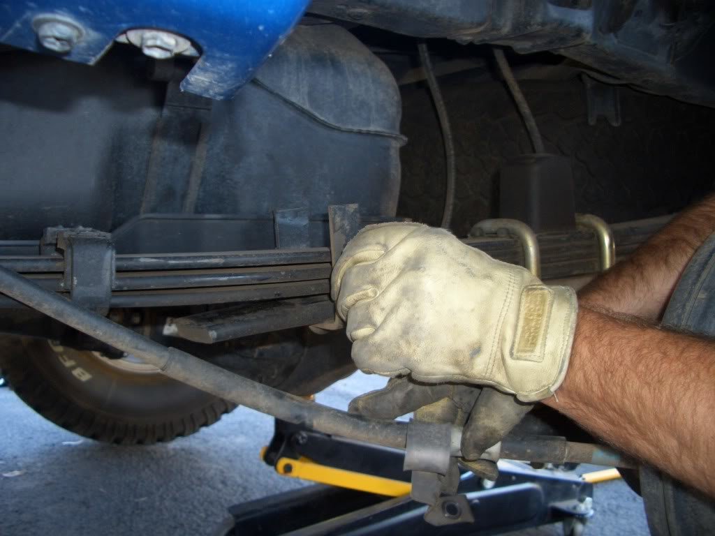

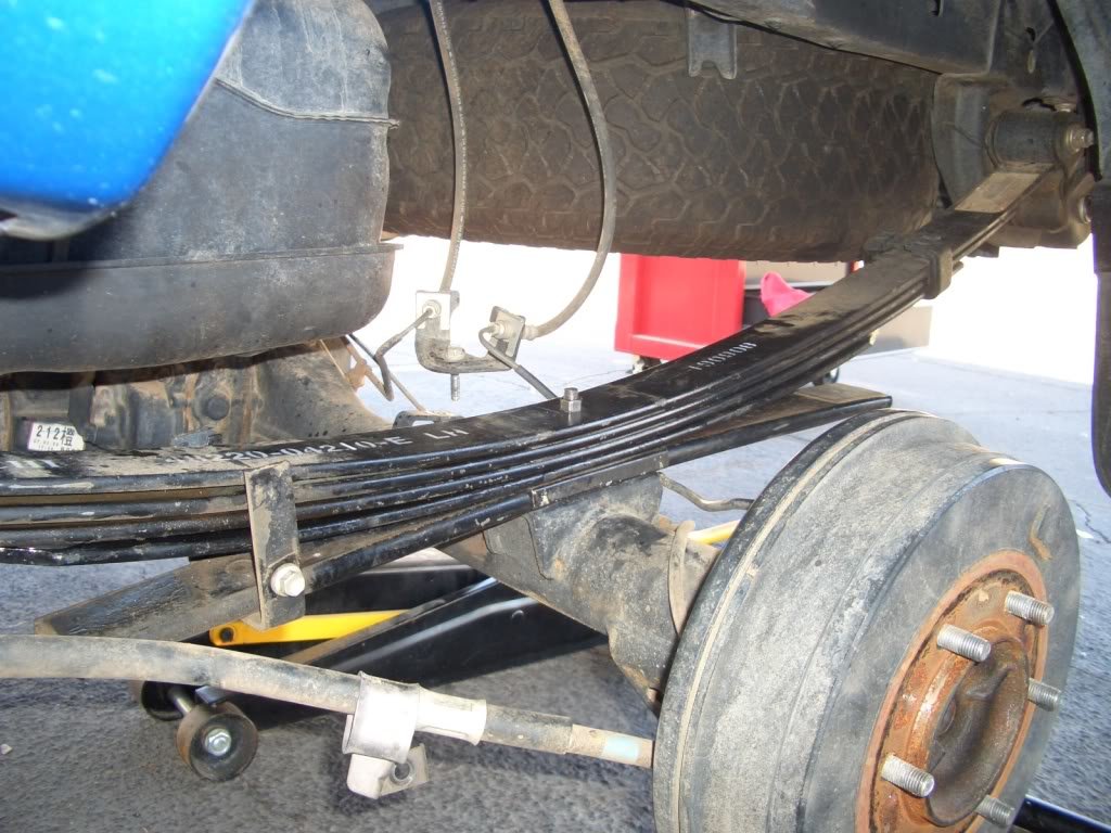

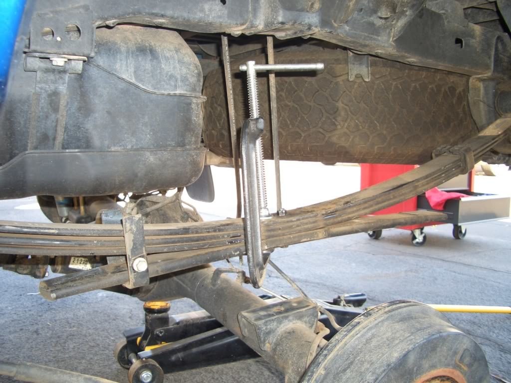

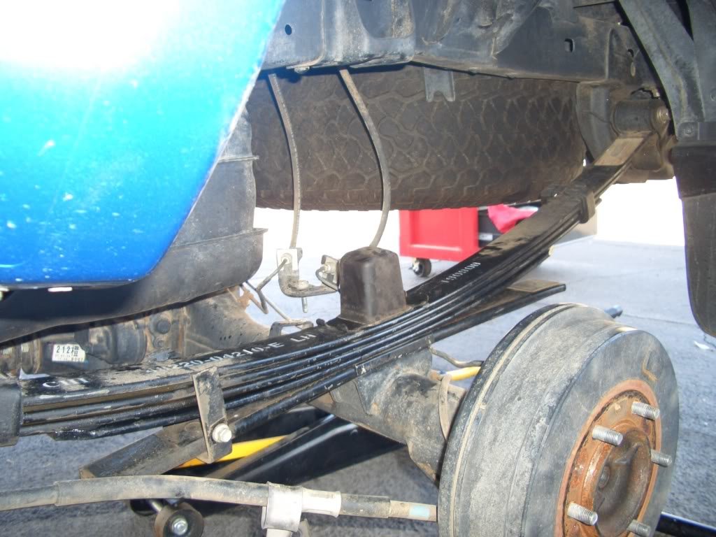

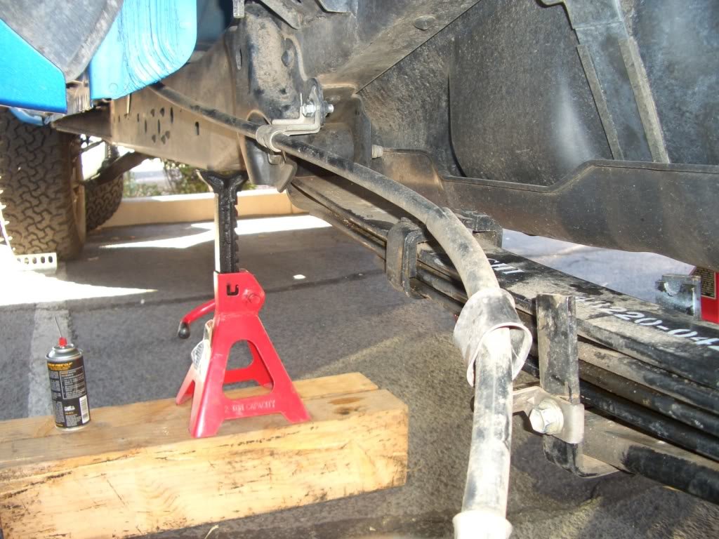

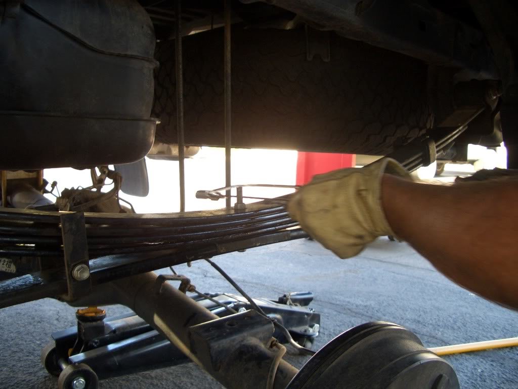

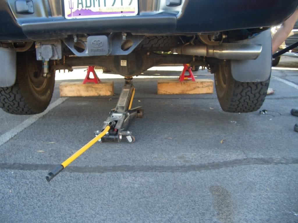

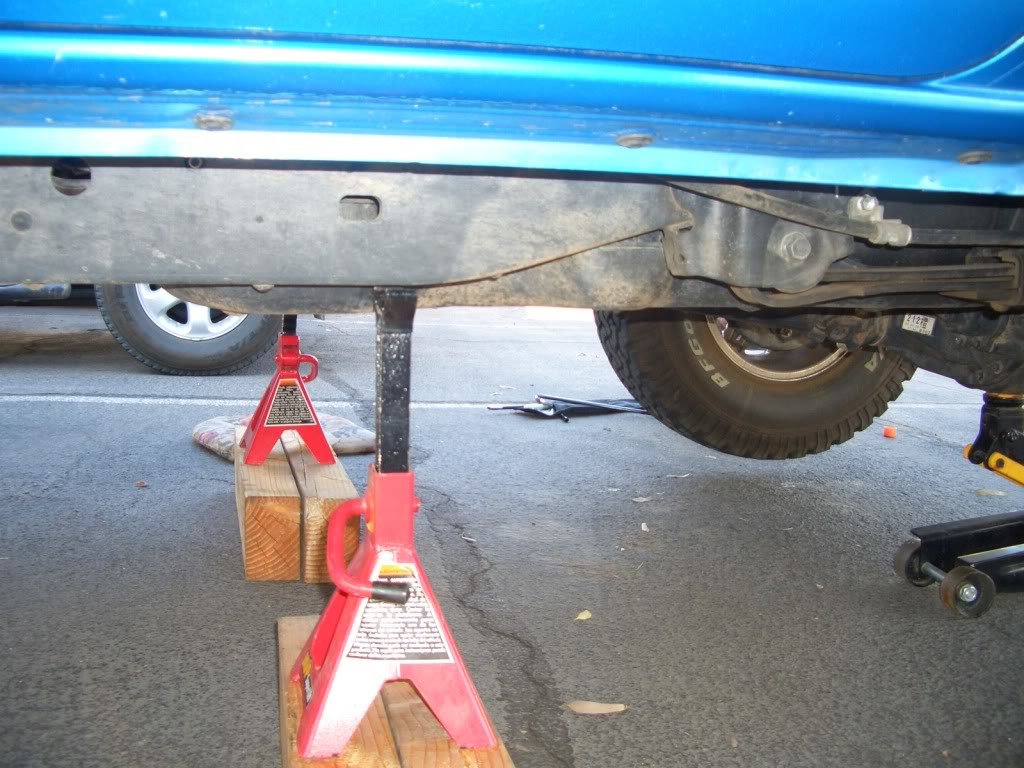

    And I too thought the same on the AAL, but it was actually a bit more difficult than I expected. Make sure you Jack the truck up high, have jack stands, undo the brake/e brake fittings, a rubber mallet, and have a good c-clamp.

    Here's what I followed, worked pretty good.
