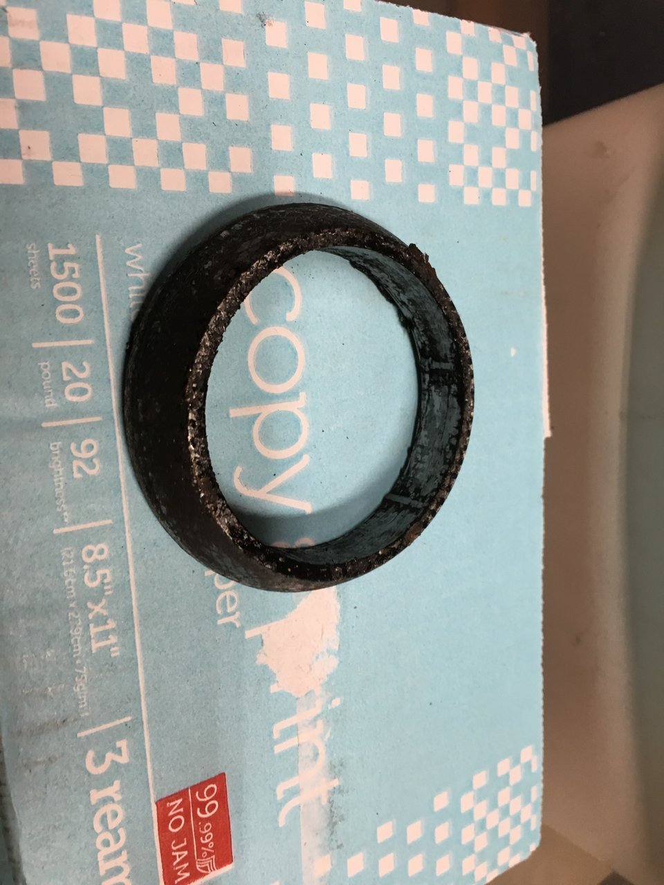

    Just as I suspected, this was the root cause of my squeaky exhaust. Put new one in and not a peep.

    Boy that muffler bearing looks worn.:spy:

    Just hit 40K, but I had a cat-back Magnaflow muffler and 2-1/2" pipe installed at about 15K. Squeaking started at about 25K and it was bugging the #$@& out of me. I gunked the spring tension bolts with high temp copper anti-seize and I thought it was the cure but when it started up again, I got this gut feeling that it might be the graphite gasket.

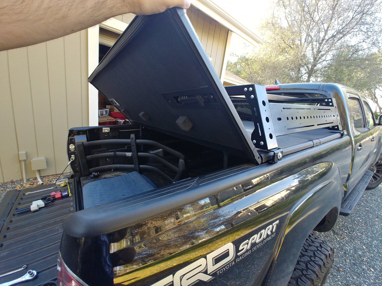

    Awesome setup. What tonneau is that?

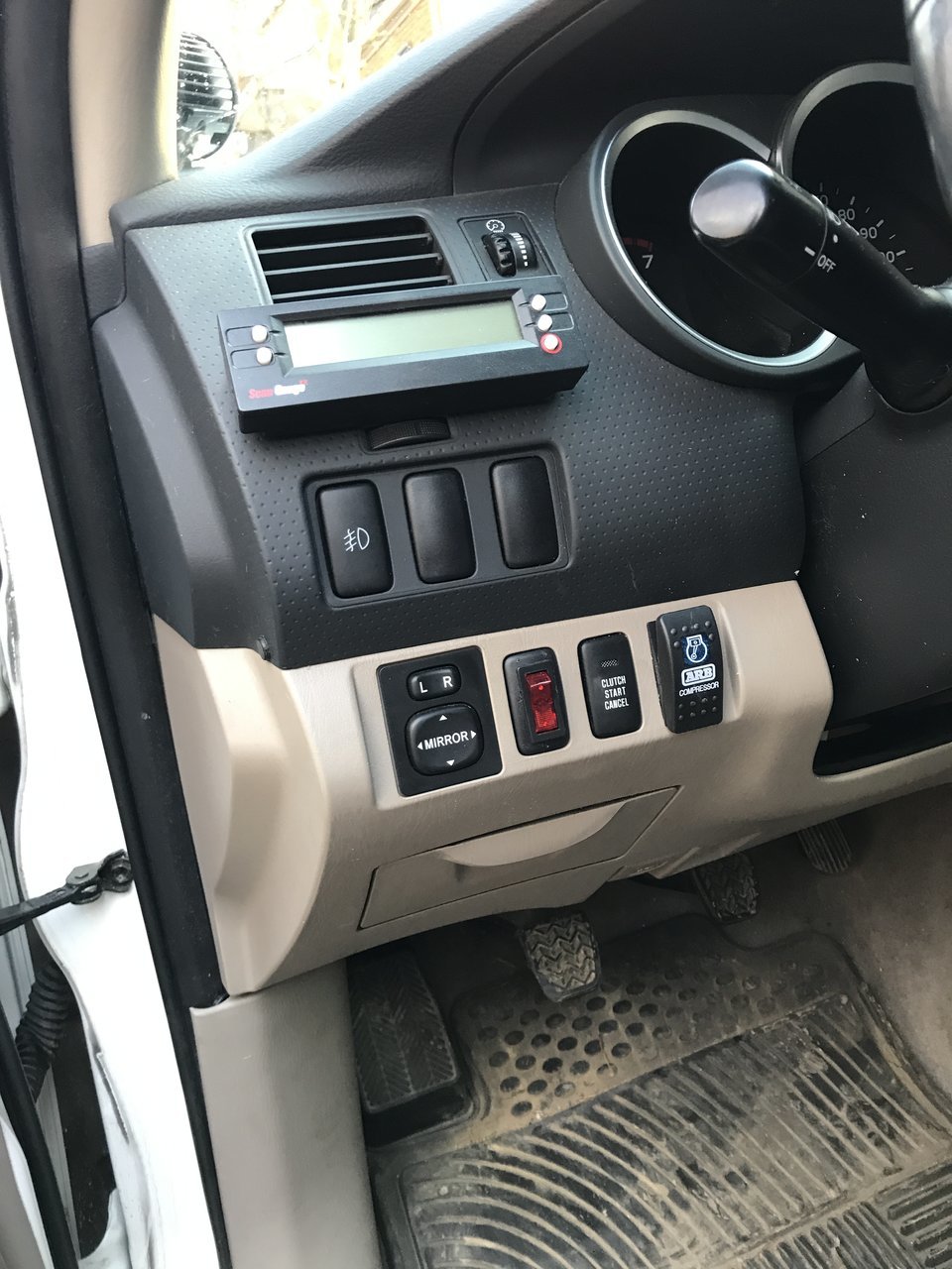

    Same place I mounted my scanguage! I took it one step further and routed the wire through the ac vent. LOVE the placement of it.

    Did the Magnaflow help your MPG any??? If I was you I would keep a spare gasket at the house JIC you need another one later on. Just my .02

    Not really, just a little sooty and some small damage from a flat head screw driver when taking it off. If anything, I think it just took on the shape of the concave housing, loosened a bit and began playing the fiddle.

    Right?!! Like it was meant to be there.

    Extang Solid Fold 2.0
