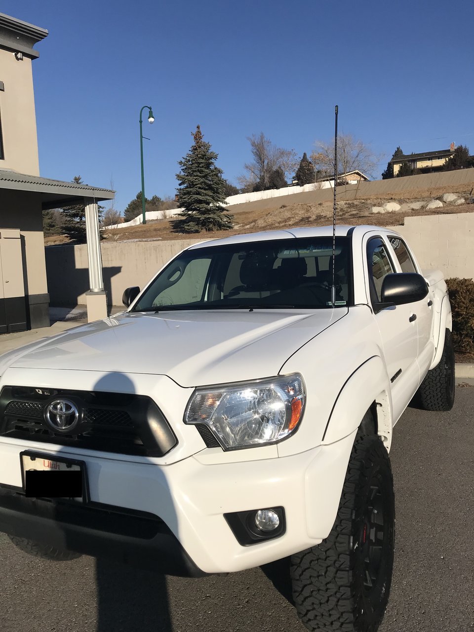

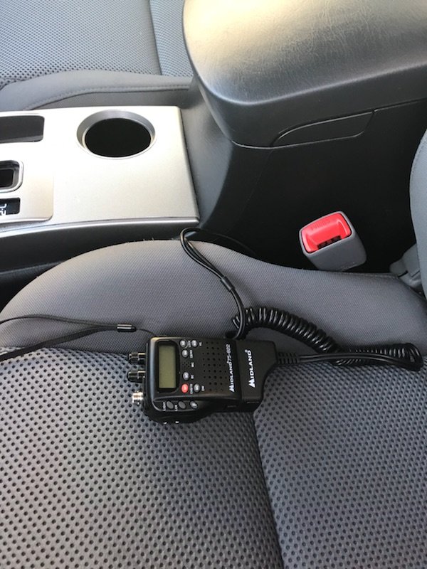

    Installed my FireStik CB antenna and Midland CB radio. I installed a 12V accessory outlet under the seat so I could hide the plug to the radio. Still need to "tune" the antenna (but I don't really know how), and try to figure out how/if I can ground it (getting a bit of feedback when accelerating). I got the antenna mount from Relentless Off Road.

    Make sure your cig outlet you installed has a good clean ground. I had a Relentless hood mount and never got any feedback noise in my Cobra handheld.
    You’ll need an SWR meter for tuning. Not sure about your specific Firestik but if it’s a firestik II you should be able to pull the cap off the tip and screw in/out a little screw to tune. Some of the firestiks require trimming.

    Thanks... I have the Firestik II with the tunable tip. I'll check the ground, but what is weird is I was getting it even when plugged in to the factory cigarette lighter which made me think there was an issue with the mount.
