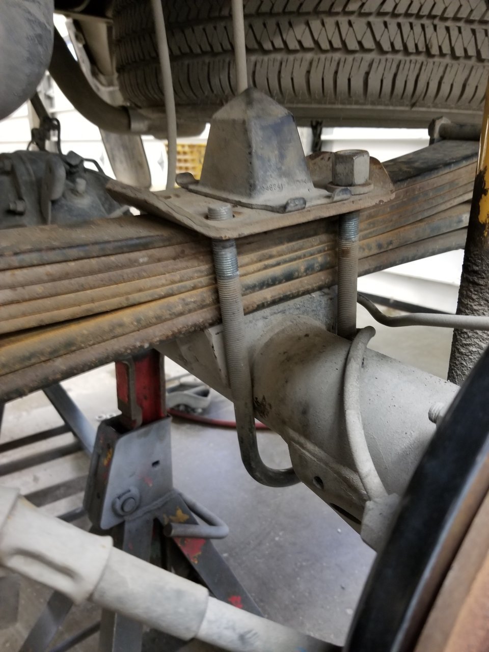

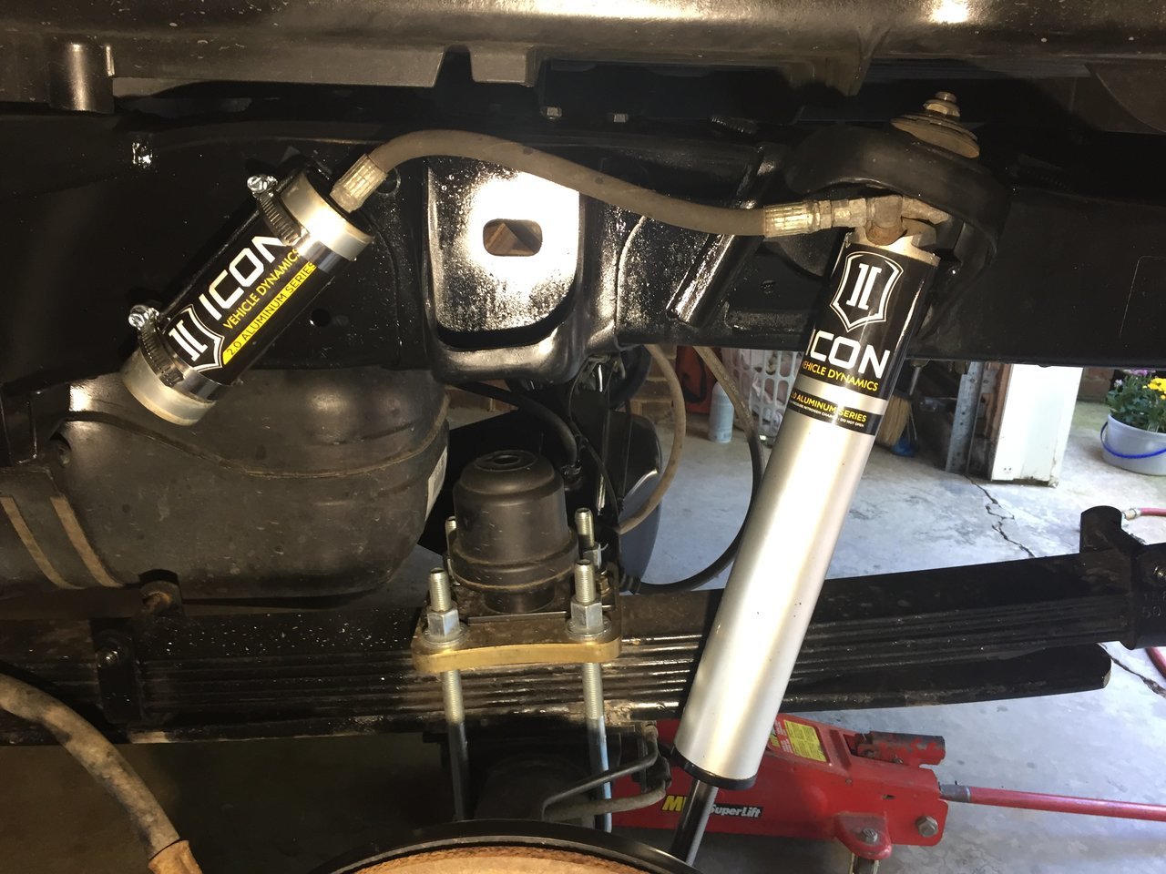

    You have them on upside down, flip them over and the plate goes on the bottem, then you slide the bumper just under the u bolt. See if you can blow up this pic hope this helps!image.jpg

    You two have different types of U-bolts.

    Shit just noticed! I got new ones with the new springs, stock ones were the same shape tho not sure why his are round.

    This orientation looks correct. You got the u-bolt flip kit right?

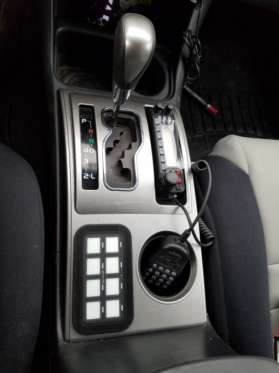

    Yaesu ft7900 with the body and speaker under the seat. The face fits perfectly in the pen tray.

    Apparently you have a U bolt flip kit. IDK if I'd reuse the U bolts personally but to each their own. To reuse your stock bumps you may have to find an alternative wayto mount them like drilling and tapping the plates and bolting them down to the plates. Or, you can order a set of super bumps from Wheeler's hell you can order a new set of Ubolts for the flip kit from wheeler's for like $20. The setup the other member showed you was stock configuration

    Thank you for the help. I was able to weld the factory bump stops for now. I'll most likely order new ubolts and bump stops but this will do for now. Thanks again. Pics to follow later in the day.
