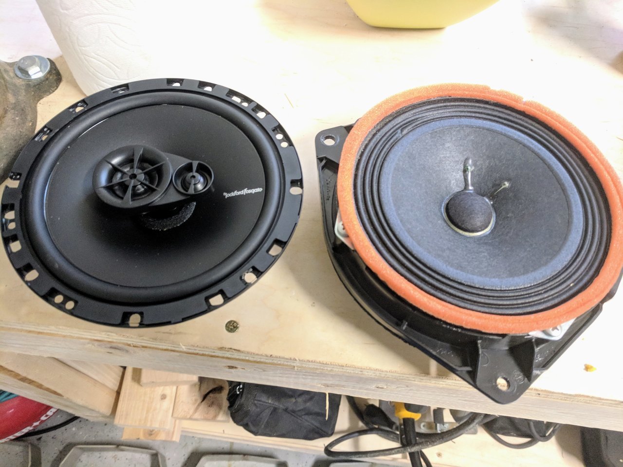

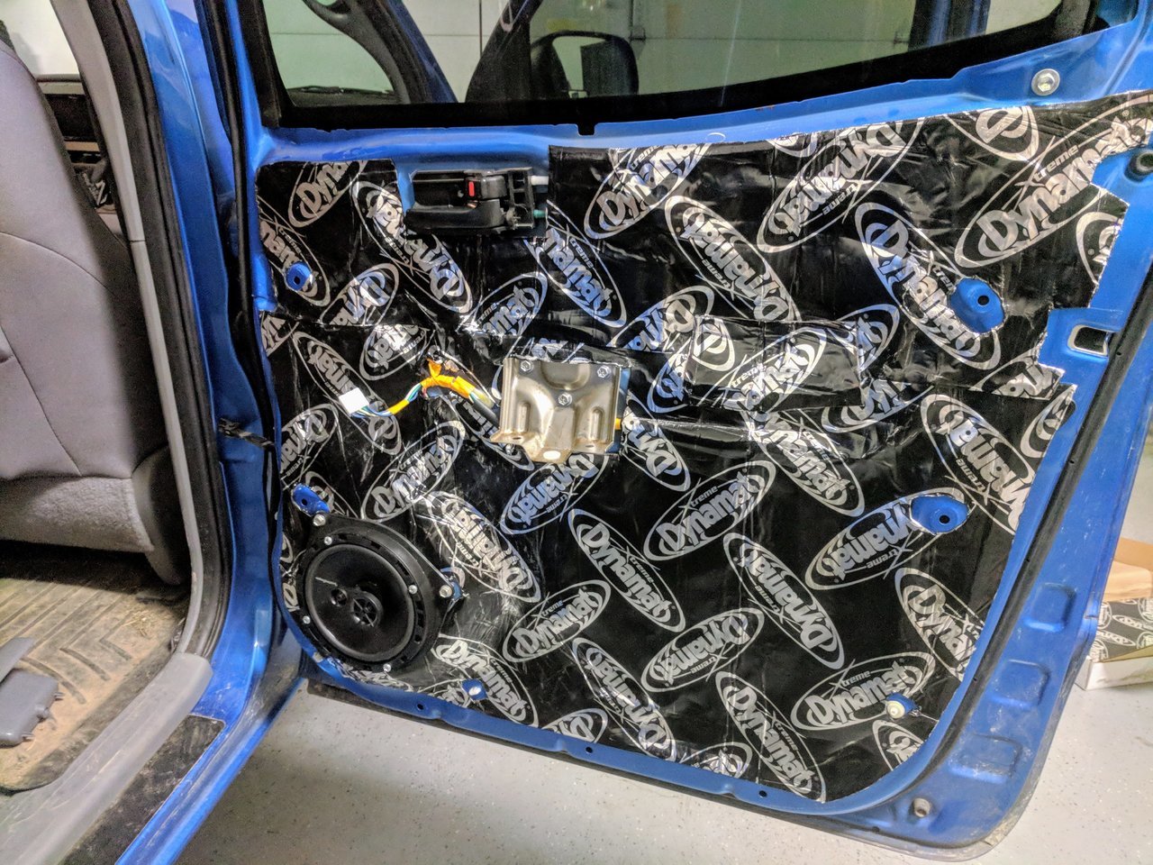

    Swapped my factory JBL rear speakers with Rockford 3-ways. Generous dynomat on the outer door panels (inside the door cavity) and also every inch of the inner panels too (shown). I plan on adding Frost King insulation and mlv over this soon. Also painted the shiny bits around my radiator so they don't show through the grille. I'll have the JBL's up for sale soon, they're an upgrade over the base level speakers and are plug/play.

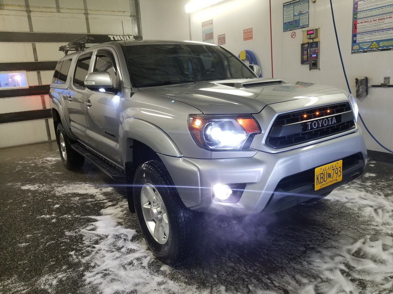

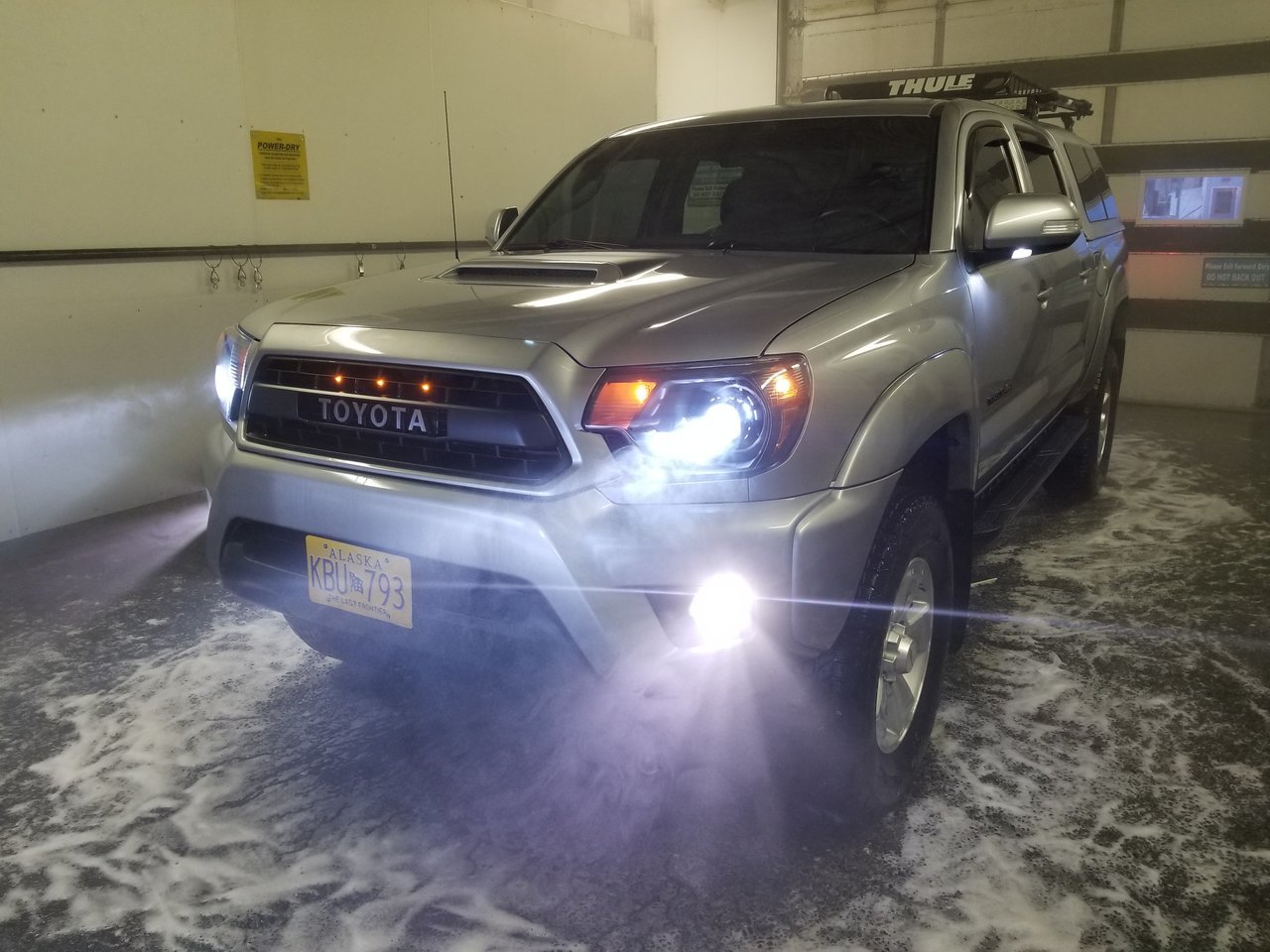

    Finally got a chance to wash it. Not bad for the middle of winter in Alaska!

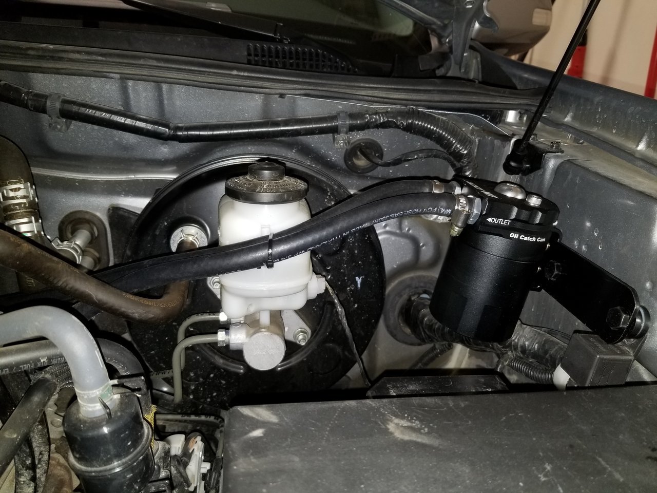

    Also installed an oil catch can.

    How was the difference from OEM doors vs Dynamatted doors?

    I have parts to do this same thing on the way. Would also like to know how it sounds?

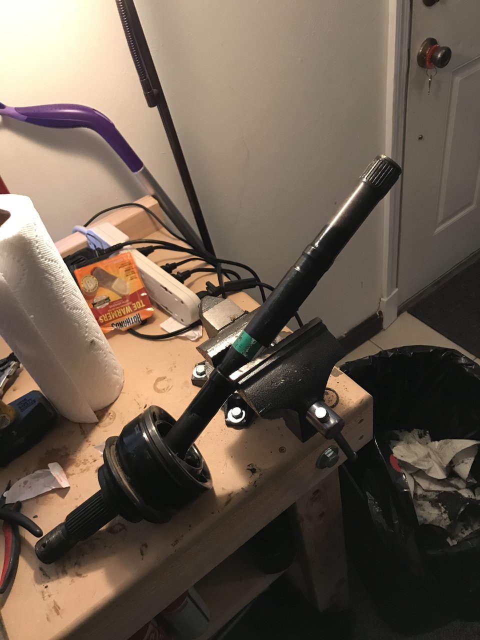

    Put fresh boots on my passenger side CV axle, as well as a new seal on that side. Tomorrow will be the drivers side and the ECGS bushing.

    Dynomat is more about suppressing vibration and resonance that blocking road noise, although it does help with that too. The cotton insulation and mlv will really be what gets the cab quiet. Anyway the difference between stock and what I've done so far is
    #1 - sightly reduced road noise
    #2 - tighter low end from those speakers as they're "sealed" into the door chamber now by covering the large holes in the inner panel. I realize it's far too big of a chamber for those little 6.5's but it's still noticable.
    #3 - heavier doors that close with a satisfactory "Thud". Which might sound odd but it really makes them feel and sound like "quality" doors from a luxury vehicle.
    #4 - the biggest benefit will be down the road when I install the amp + sub and everything is rattle free
