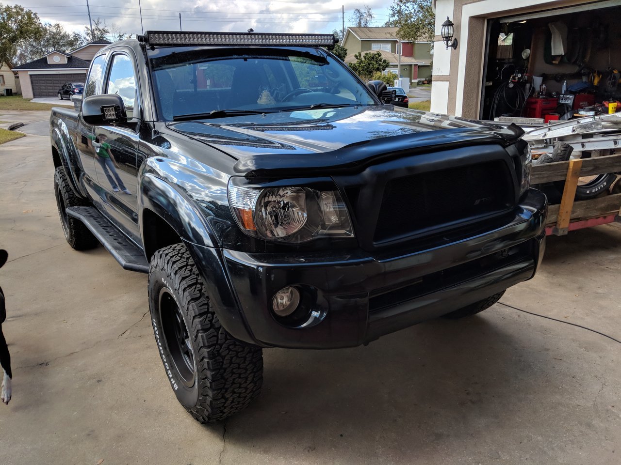

    Painted my po-boy "Satoshi" grille, installed some LED turn signals markers and fogs, put a bug deflector I got from a junk yard truck on, probably going to take it off, I don't feel like it adds anything other than noise but meh it was cheap. Unseen, I replaced a lot of those plastic pop clips that are always breaking with nut-certs and stainless hardware.

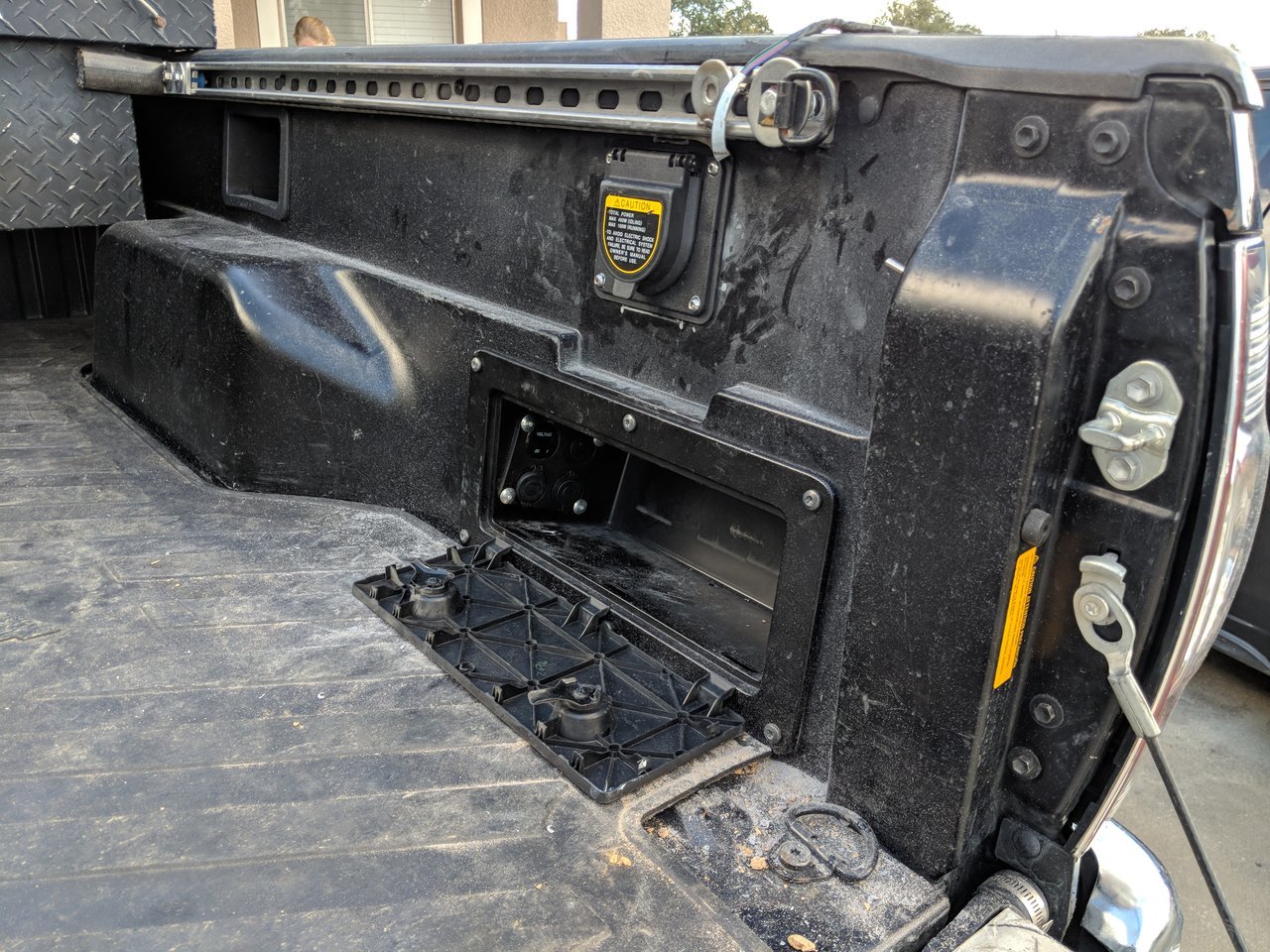

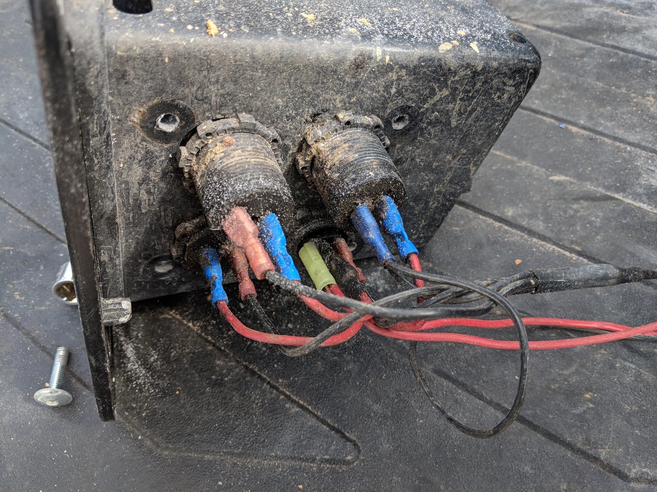

    Relocated my TRD/OR bed outlet above the stock location and installed another cubby box for more storage space. Also had to relocate my rear power center from my old mini cubby to the full size.
    My arms and shoulders are full of fibreglass from cutting and drilling the bed.

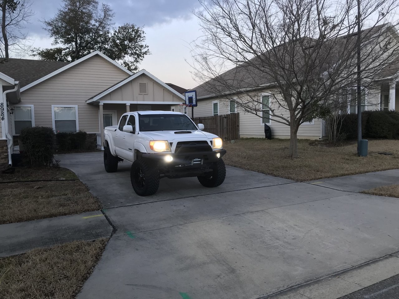

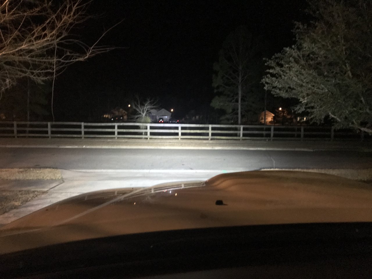

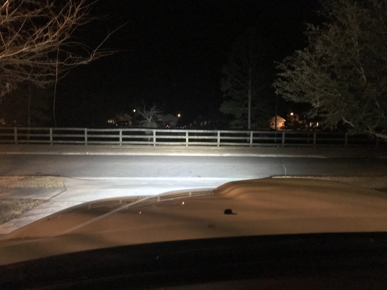

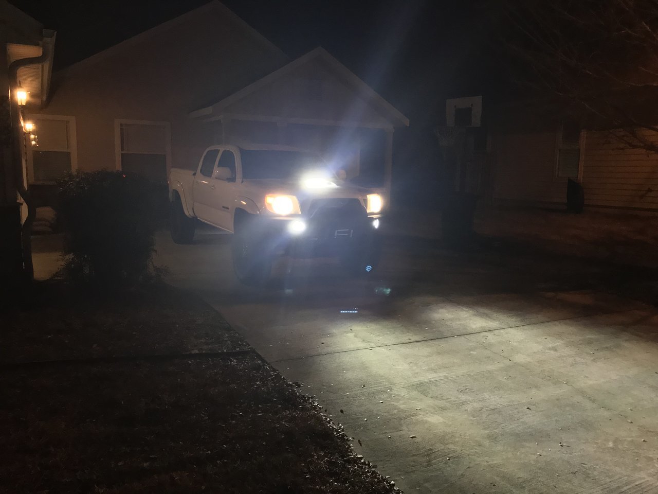

    Finally installed the LED fog lights! Pics/views below.
    All lights on. (Low beam, fog lights, hood scoop light).
    Low beam and fog lights
    All lights on

    What size light bar do you have in your scoop? I've thought about putting one in mine.

    Looks beautiful, where did you get that grill from?

    It's a 10" single row. Bought the mount from C4 Fabrication.

    Got lucky and found it used on Craigslist for $200

    :confused: There's no fiberglass in the bed. It's a composite material.

    Composite is defined as a material made of different parts, our beds are FRP, or Fiberglass Reinforced Plastic. They most definitely have fiberglass in them but they are not typical solid fiberglass.
    Cut or drill into your bed, especially with a hole saw or other aggressive toothed blade and you will see there are glass fibres in the plastic.
    The bed itself is top bonded with a slick plastic to prevent the flaking or stranding bare fibreglass is known for when stressed or abraded and to keep glass fibres from getting embedded in the load (or yourself if you're laying in it.) but once you break through the 1/16" top coat you expose the fiberglass.
    I first discovered fibers in the bed when I had to haul my motorcycle on its side rather than standing and the peg made a tiny chip in the top coating.
    The actual make up of the composite is a closely guarded secret of Toyota's I'm sure but I, and my skin, can attest there is most certainly glass fiber reinforcement in the tray.

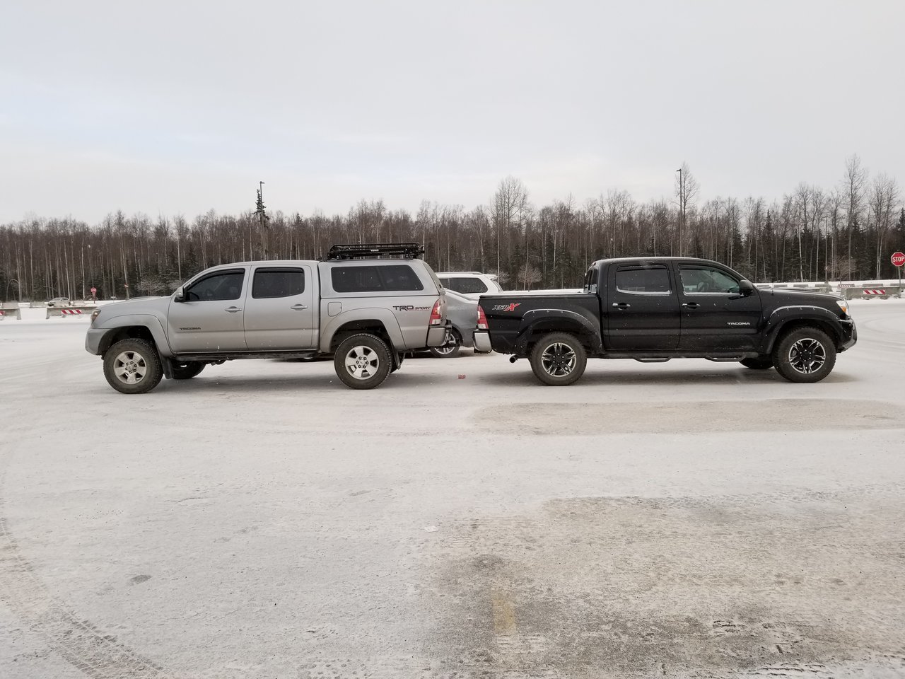

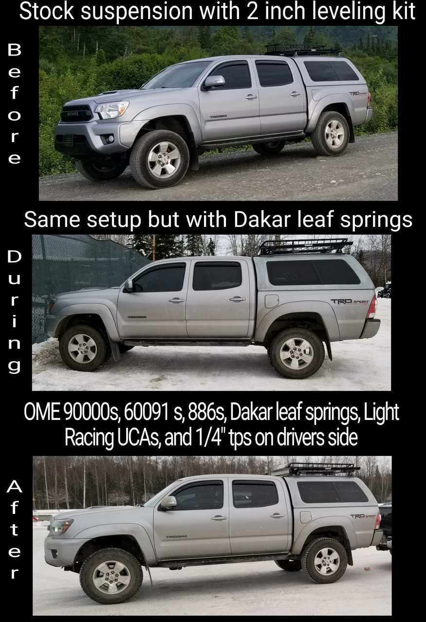

    That truck behind you is exactly what mine looked like 2.5 years ago
    How did a Southeast Toyota xsp-x make it all the way up to Alaska?!

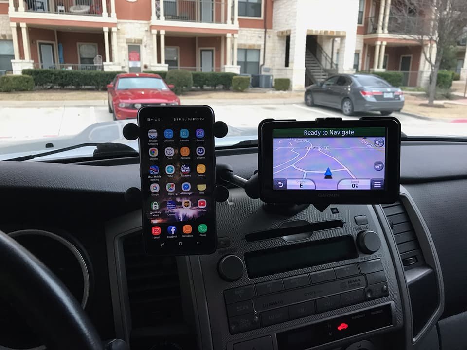

    like the phone mount ! do you know the brand?

    Looks like a ram mount
