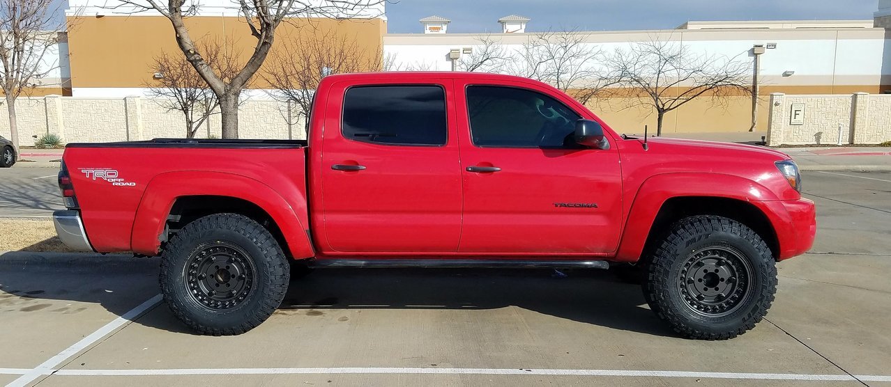

    Sponsored by TacomaWorld.com

    2012 Tacoma TRD Sport DCLB
    Nice! What wheels are those?
