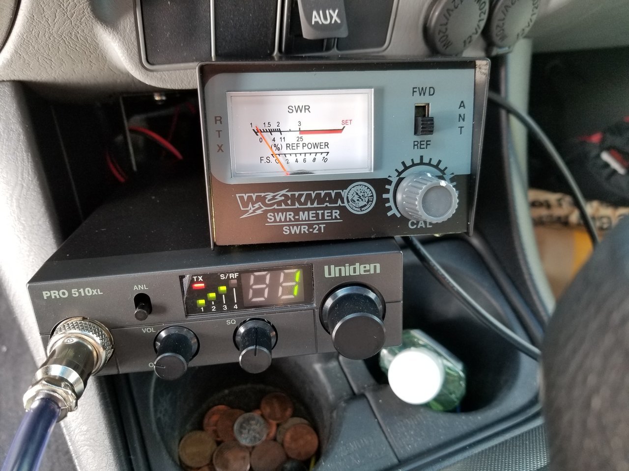

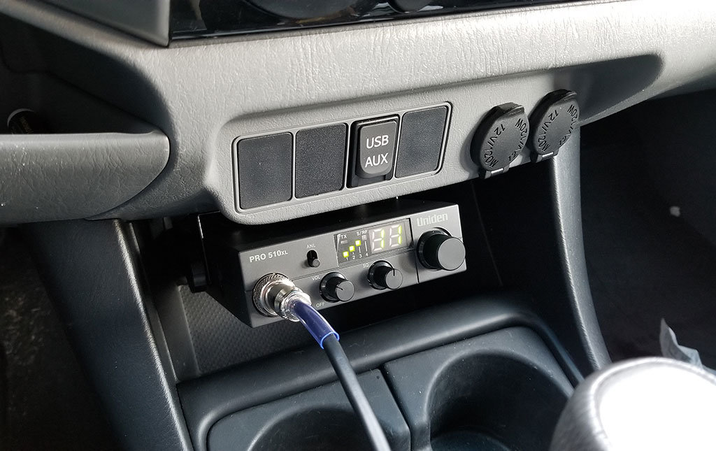

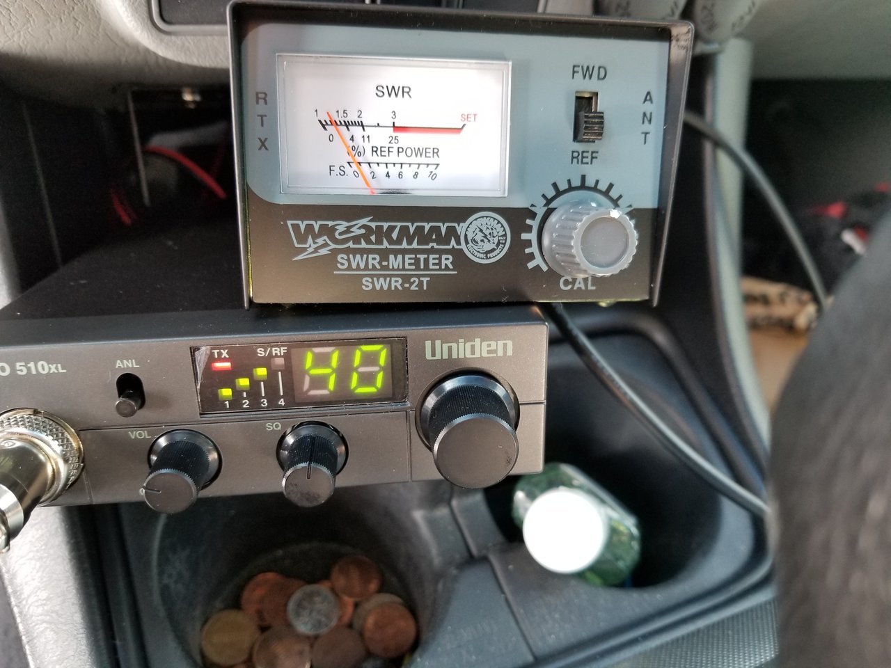

    I did a thread on my CB installation, but I just picked up a 4' Firestik Firefly to compliment the 2' Firestik and let me say it's a great way to reach out and touch someone. SWR numbers are pretty darn good.

    Sponsored by TacomaWorld.com
    Awesome!! Thats the exact placement I'm shooting for.
