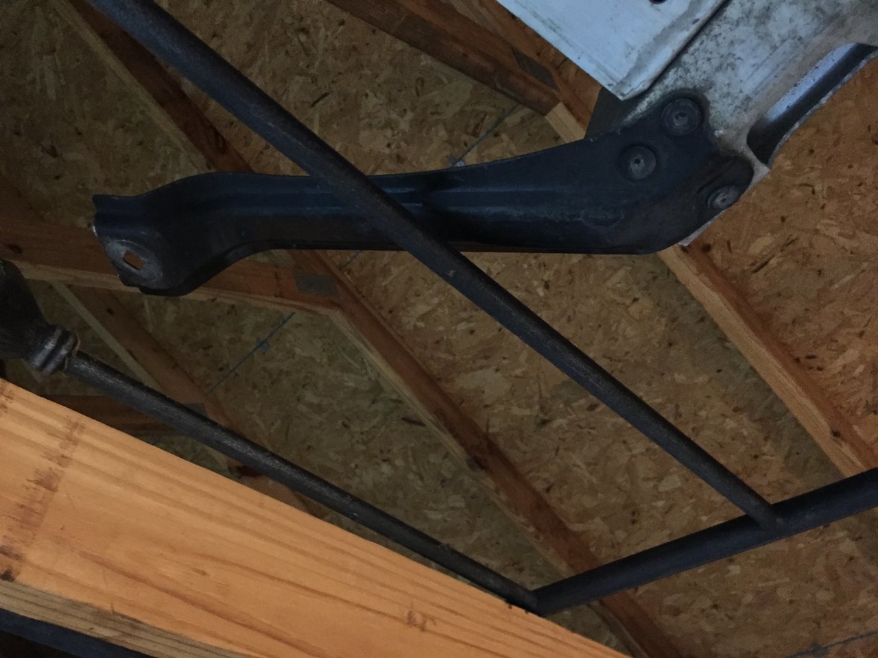

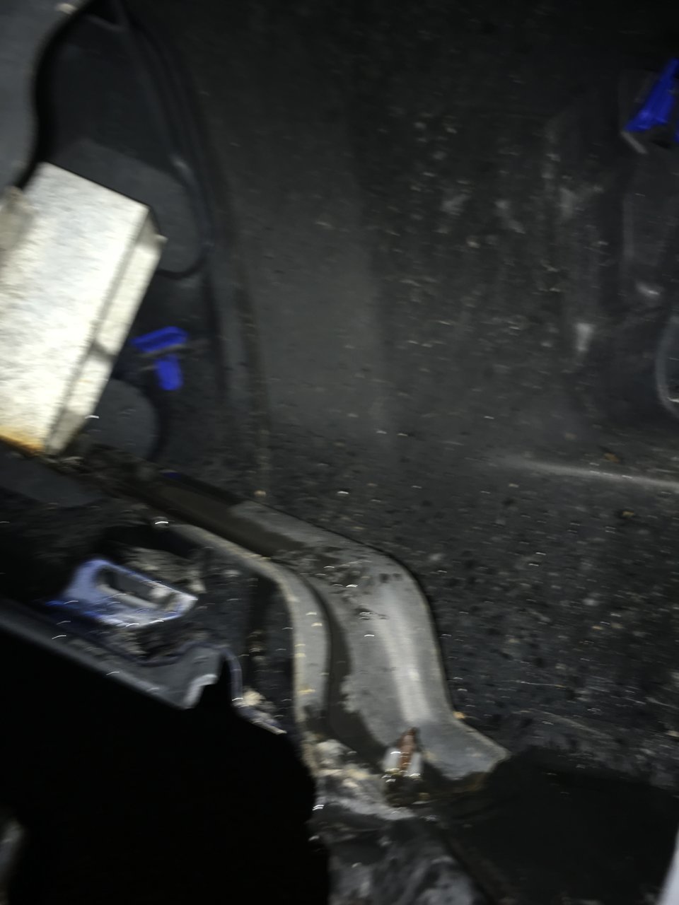

    Thank you all so much! I'm going to take the bumper apart tonight and hopefully fix it!

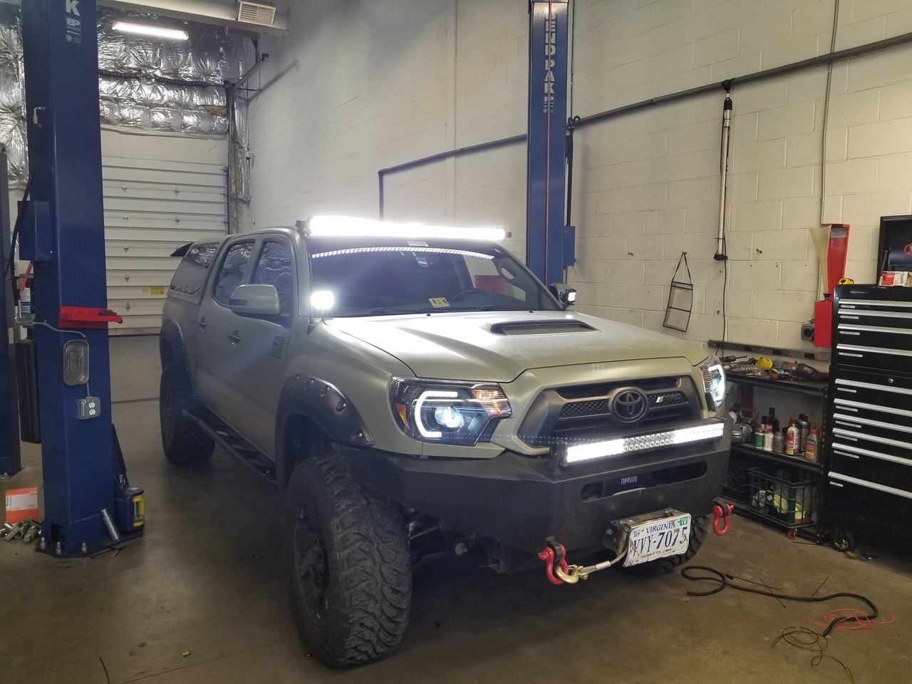

    Are those the Amazon headlights??? :drool:
  3. Feb 24, 2018 at 7:44 PM
    BravesRunner
    BravesRunner “Exploration is curiosity put into action”
    Jan 19, 2017
    #208063
    4,807
    Adam
    SC
    2021 GMC Sierra 1500 Denali
    Grandpa steps//Tri-fold Tonneau bed cover
    Do you have a separate switch to turn them on or do they just come on with your lights?

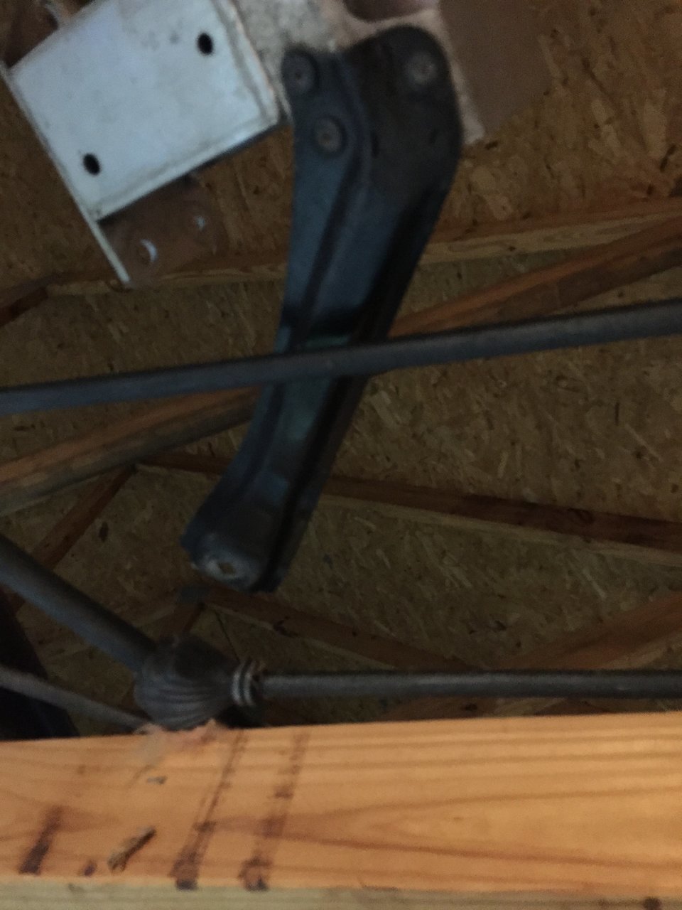

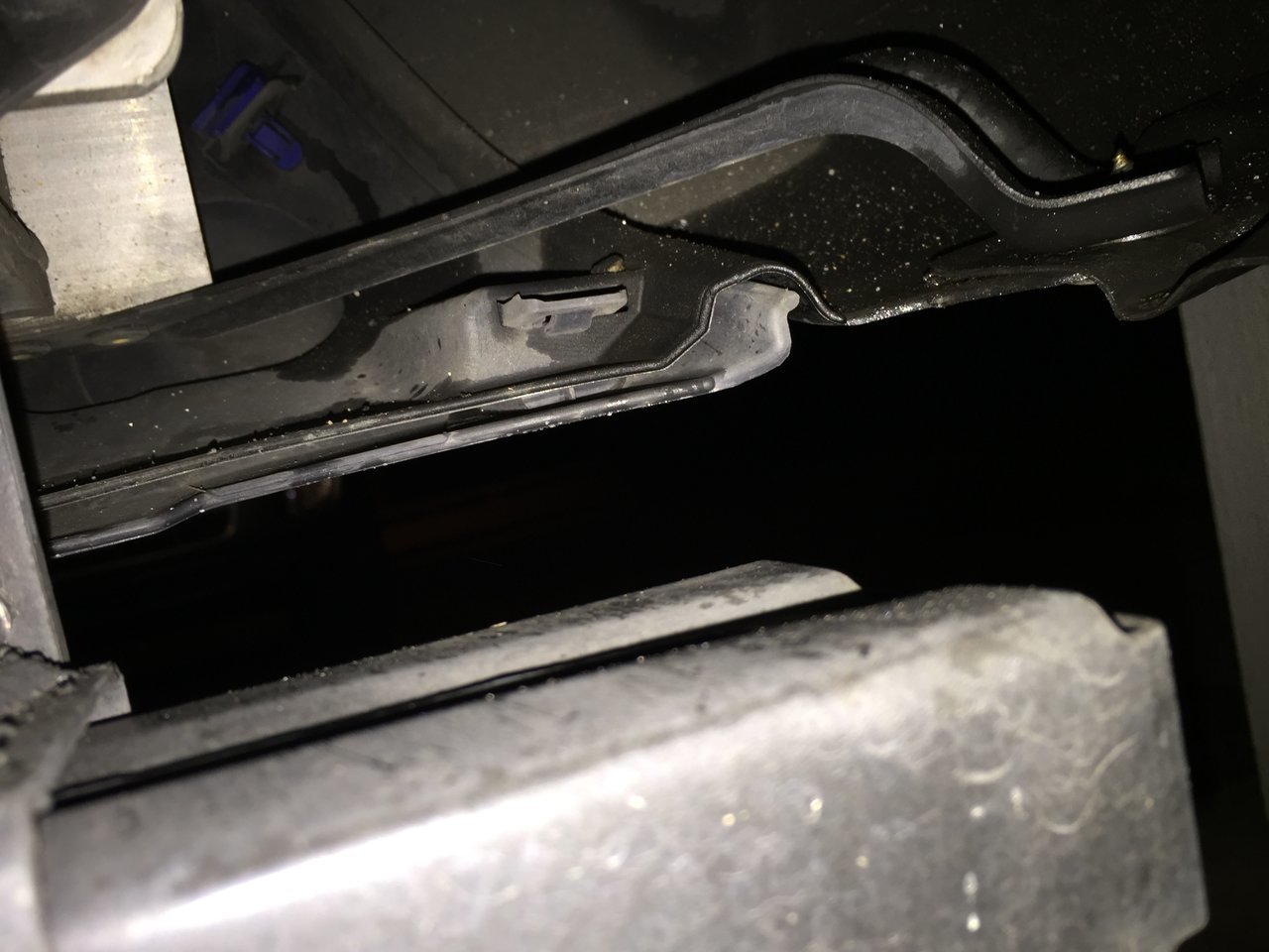

    the first pic you got with the red circle .Lower right side , screw sticking out below red circle lower right side ,take out bolt bend bracket down into plastic insert and reinstall screw. no need to take bumper apart.
    Edit Edited your pic lol....

    They just come on with the drive lights.

    If nothing is flapping or moving around, I wouldn't worry about it or just remove it all together. Earlier trucks didn't have that brace.
