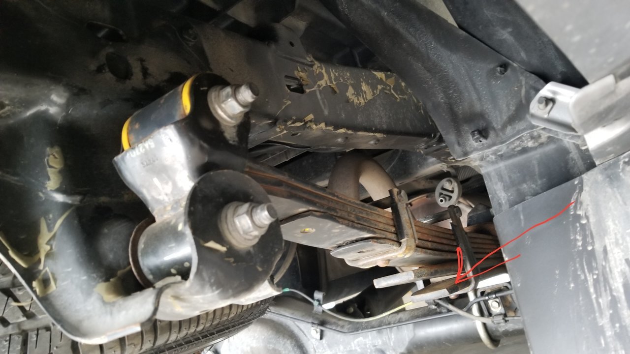

    Just to be sure I'm thinking right, this is the overload right?
    Will this change any important angles of the rear axle as it pertains to the drive shaft?

    Hmm I'm not sure. The one in the picture from Headstrong actually looks curved. Someone else should chime in soon but think the 3rd from the bottom might be it.

    @nazlax10 I have Dakars that I bought from Toytec. Their instructions stated that the 2nd leaf from the bottom could be removed for light bed load applications, and/or to reduce the overall lift height
