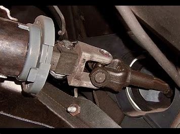

    Anyone having their steering u-joint rusting up?
    This is the second time I've had to spray some wd-40 on it. :annoyed:
    As you've notice it's slushy on the ground today.. shit doesn't brake in nice weather.. :pout:

    I can't tell from the pic but are there zerk fittings anywhere on there?

    That pic is not of the actual u joint just some thing to get the point across.

    Steering shaft has no zerk figttings.
    Why are you spraying wd40 on it? Mine squeaks when turning around the rubber that it goes through the firewall. I know at least @EatSleepTacos replaced his due to noise and found a fair amount of play when he too it off. Mine also makes a rattling noise while offroading so looking at replacing mine soon as well.

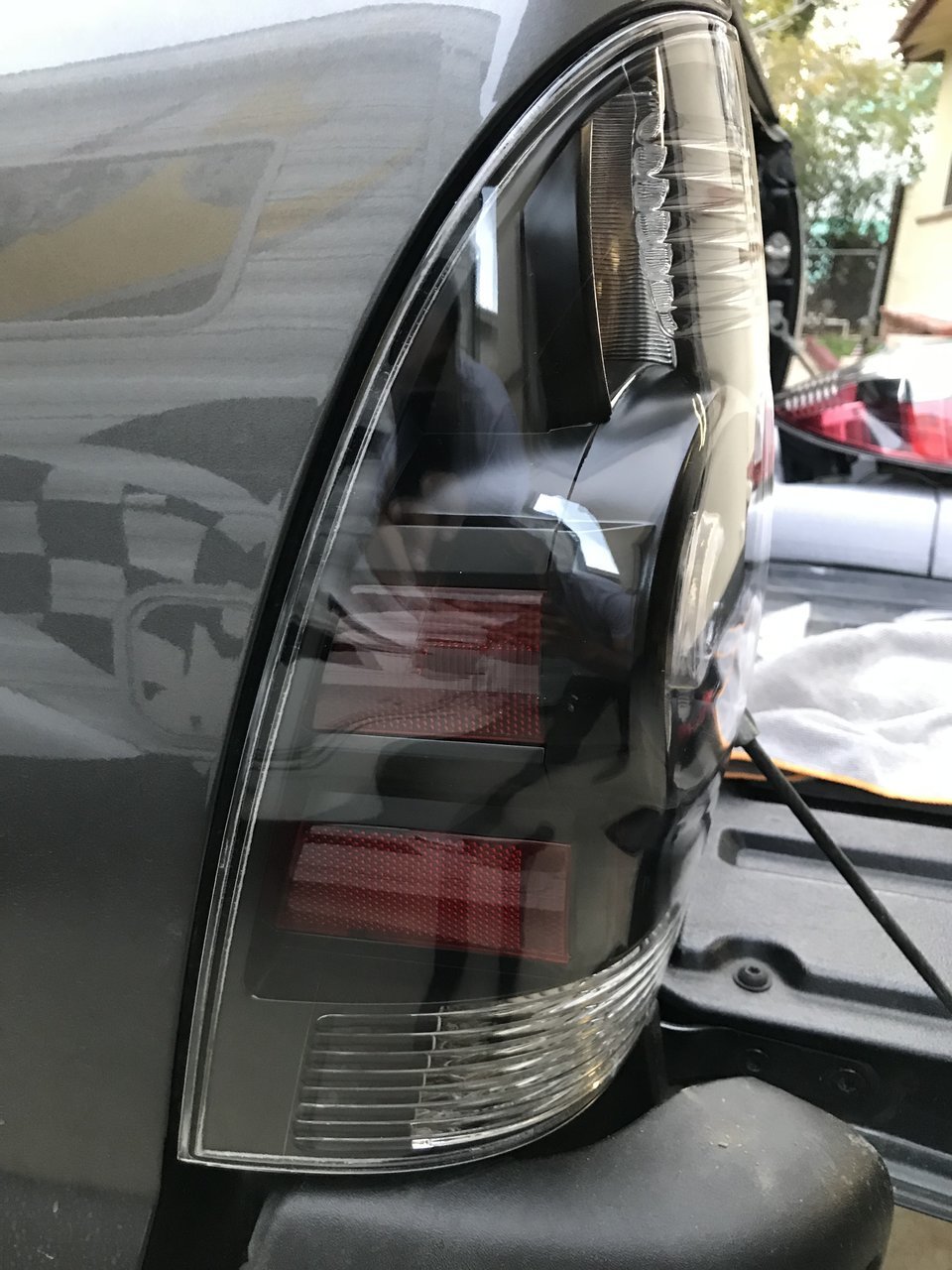

    Are those the Depo lights?

    Stiff turning

    Does it help after you spray the u-joints? The way u-joints work unless the WD40 is getting into the cups and lubricating the needle bearings an exterior oil film won't help any. Checked the PS fld level?

    When I did it the first time it did help.. This time I'll spray some lithium grease.

    You should probably just replace it. Like I said you spraying stuff doesn't get the lube into the cups to lube the needle bearings. It's not that expensive and a pretty simple fix there are a few write ups on here on how to do it. @EatSleepTacos did his recently and can link you to his build page where he did it and where he got the part and cost I can't find it.
