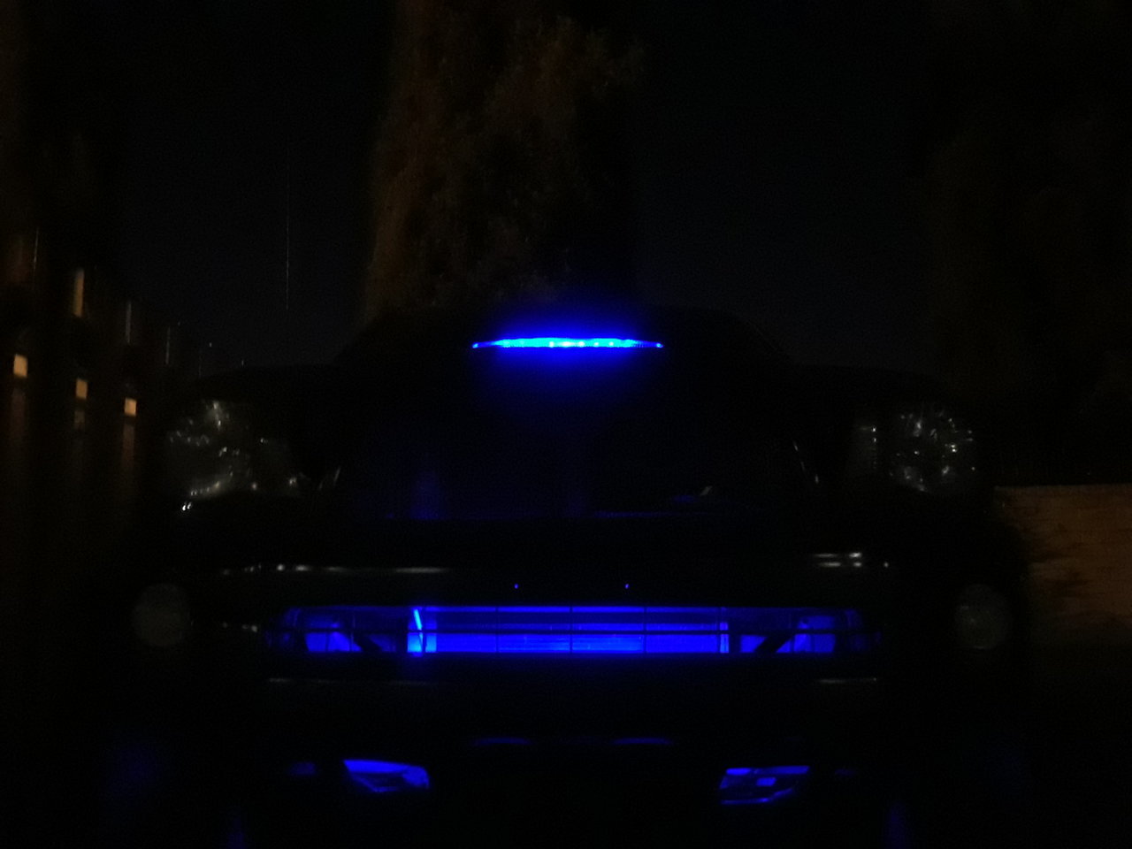

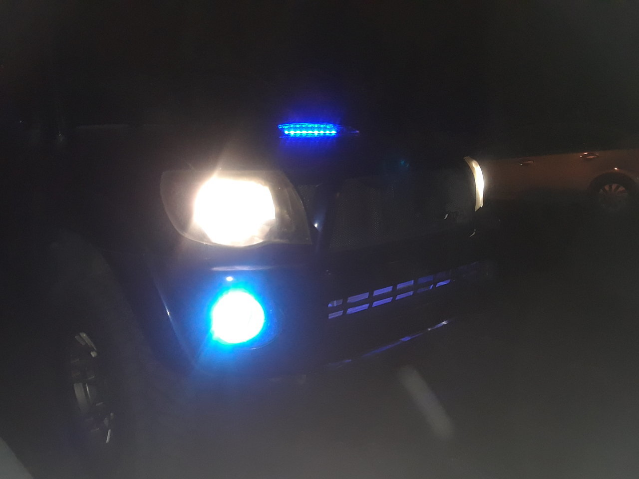

    Yes sir. Also have a row to give light through the lower valance. 20180310_202813.jpg20180310_203711.jpg

    Just a few LEDs...
    Very Nice!
    I went a little overboard with mine. :anonymous:

    Looks great! Illegal as hell! Don't run them on road!

    My intent was to keep it subtle.

    I run them on the freeway sometimes and occasionally in the rain. I know it isn't legal of course, I'm riding clean though. Wonder what the ticket would cost.

    Probably pretty serious. Impersonating Law Enforcement would be the charge.

    Whoa, I never thought about that. Glad you said that. I should think more (in certain cases anyways) thanks

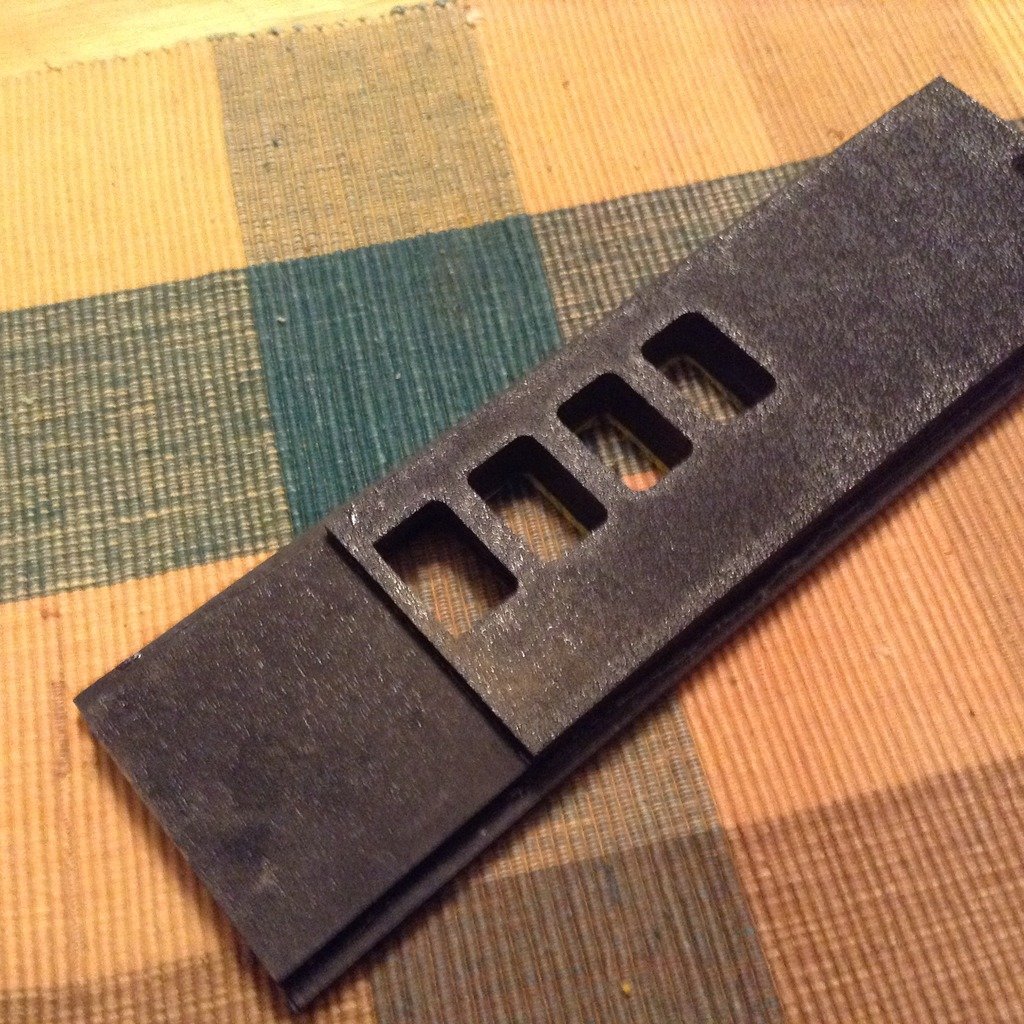

    A couple pics of the center console panel so far. It's made up of 3 layers of abs, 2 @ 1/4" and 1 @ 3/16" which is 11/16", the total thickness of the small push switches back to the lip on the snap. Here's the back, the recessed area to the left is where the two stacked pressure guages will go after some 1/8" abs is glued there. On the far end is where the pressure regulator will go. F87F99CF-D44B-4B37-9650-982A2216CF36_zps_027b54cb832e8e44ad48458d68540818567ff758.jpg

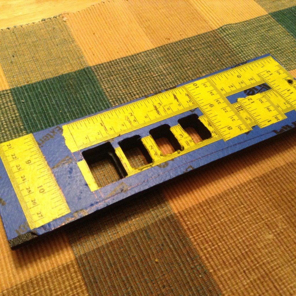

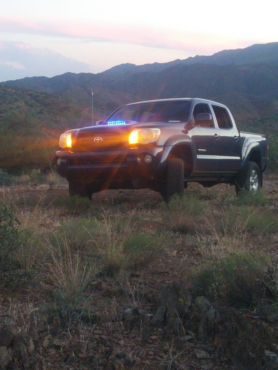

    And here's a pic of the front side, I still have to adjust the jig a bit more to get the switch clearance correct on the first switch hole before finishing the rest, when finished there's only ~1mm between the holes on the front. . The ends get cut back and the long edges cut/sanded to follow the template lines drawn on the blue tape. The switches are offset to the low side because from the drivers perspective only the lower 2" of the panel is visible so the switches are centered vertically in that space. Both the guages and the regulator will be simple cuts with a two different hole saws each on the drill press. A0CF0948-7D57-47B2-9903-2B20CC1DD2DF_zps_ce57b47f81fe5340d1f869ba85cb6a730ee144a4.jpg

    Red and Blue lights are definitely something you DO NOT want to run on the street for this very reason.
