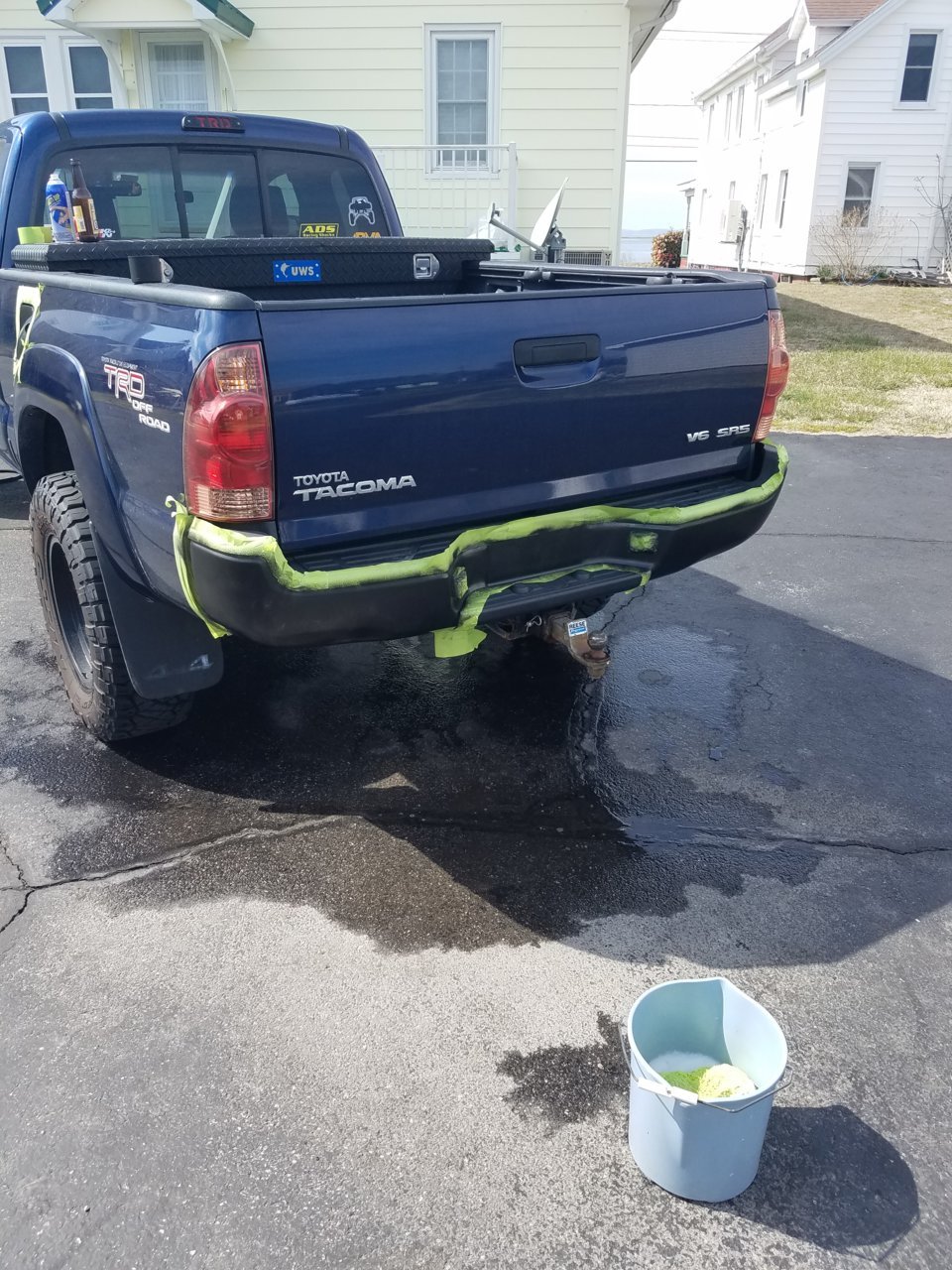

    Took the day off to get some shit done...
    So far:
    (still drying/curing)

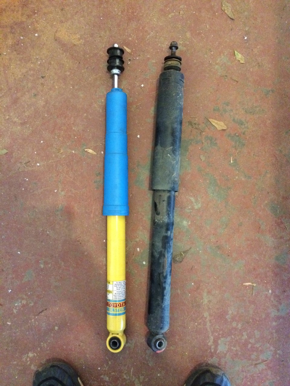

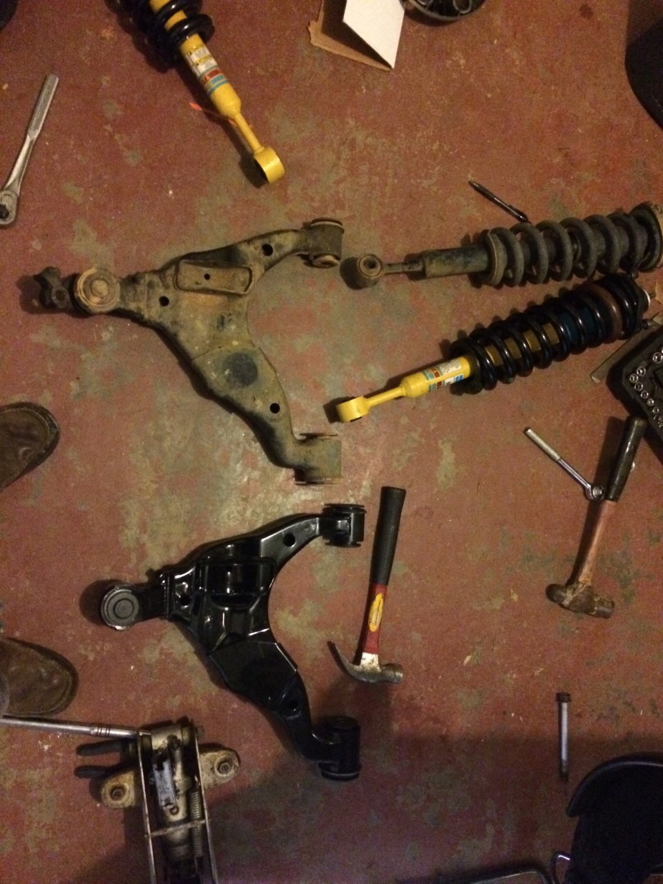

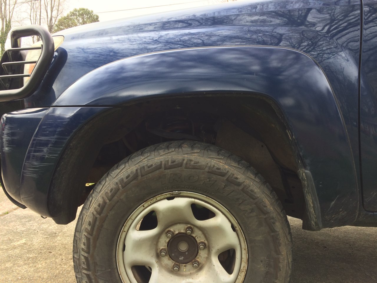

    Replaced the lower control arms with ACdelco, didn't feel like messing with the ball joint and they were starting to rust a bit anyways. Replaced the front and back shocks with 2017 TRD off-road take-offs from Craigslist, they definitely gave me an inch of lift in the front and a half in the back. Much better ride than my jackass buddy trying to tell me block lift will do the same. Still haven't put new rear leaf springs in the back, probably just go with the OME add a leaf in a couple weeks.

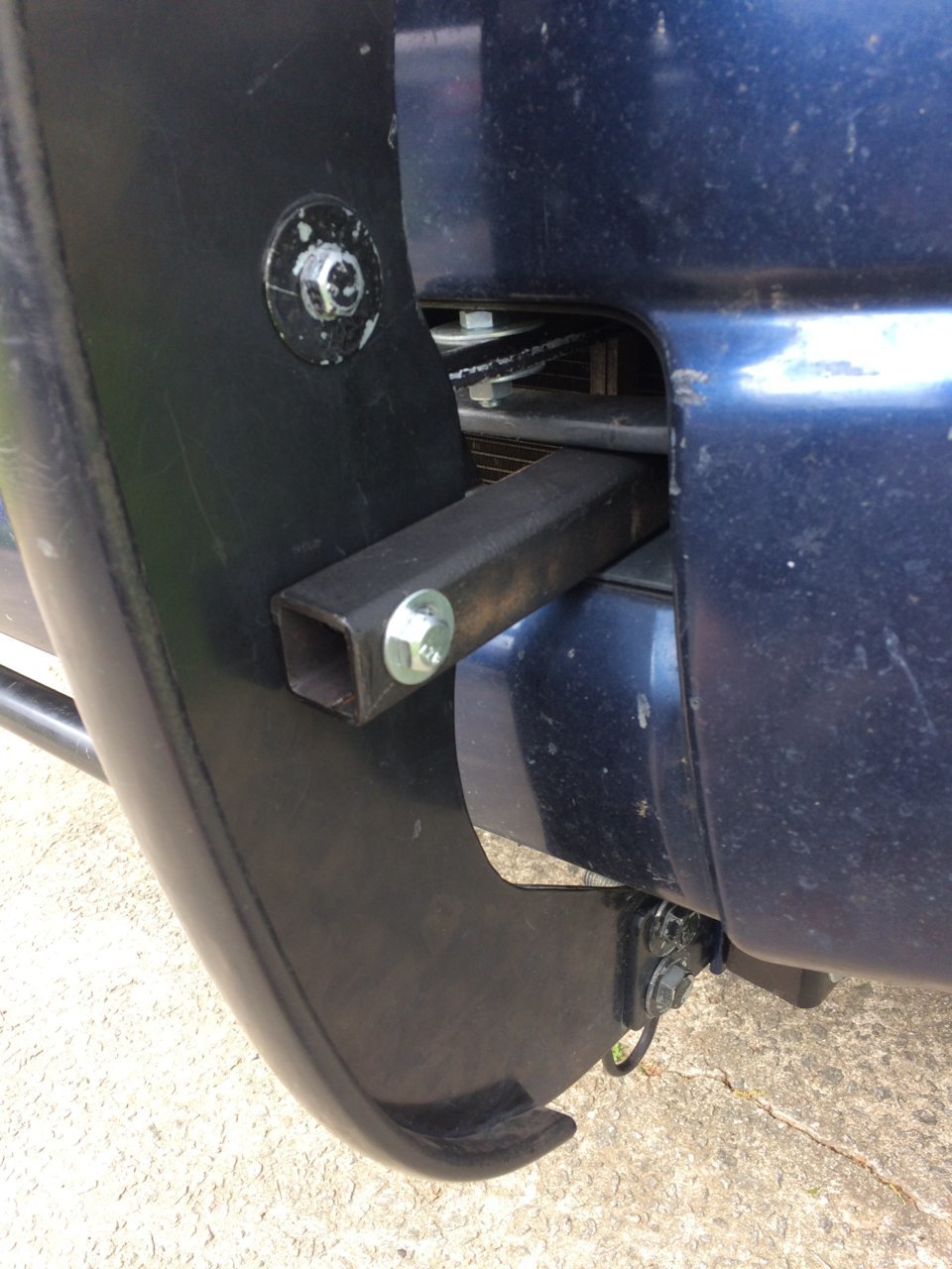

    Also reinforced my brush guard a bit to keep it from shaking so damn much. I figured someone else has this trouble so I put pics of my placements, it's not pretty but it keeps the vibrations down.
    After an alignment my Taco is riding like new biting hard and riding smooth. This is all just in time for my trip on the trail this weekend.

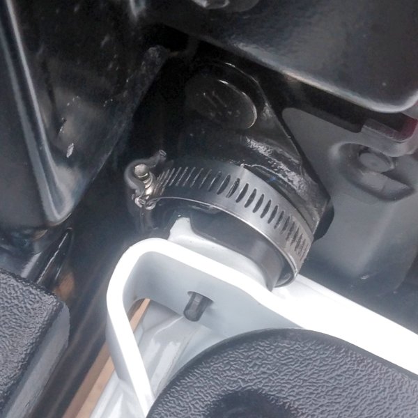

    I just used a hose clamp, no interference...
    But I understand wanting to use a cool laser tool....

    I did that as well, I am referring to putting and over sized washer where the cable disconnects from the truck. That way they cannot take the cable off the truck either. The problem with doing this is the bolt that holds the cable in place has a large flange where the cable rotates. By adding a washer the exact same size as the flange it will rotate freely even though the bolt is now 1/8 father out because of the over sized washer. Hope this makes since. Ill post a Pic once complete.
