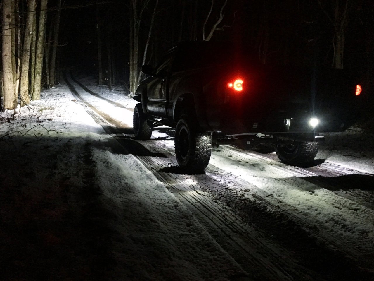

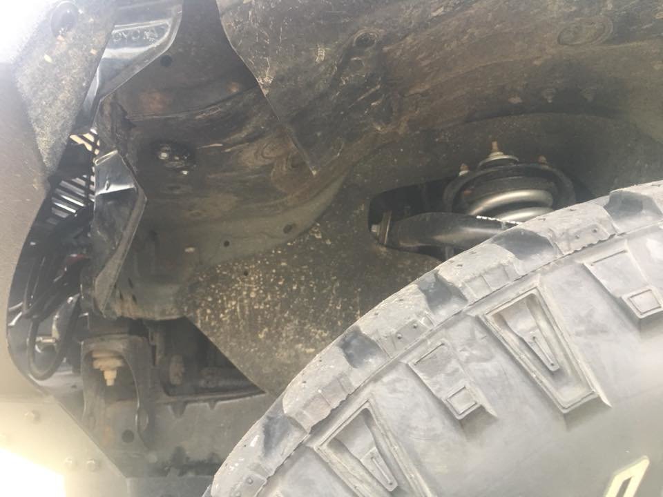

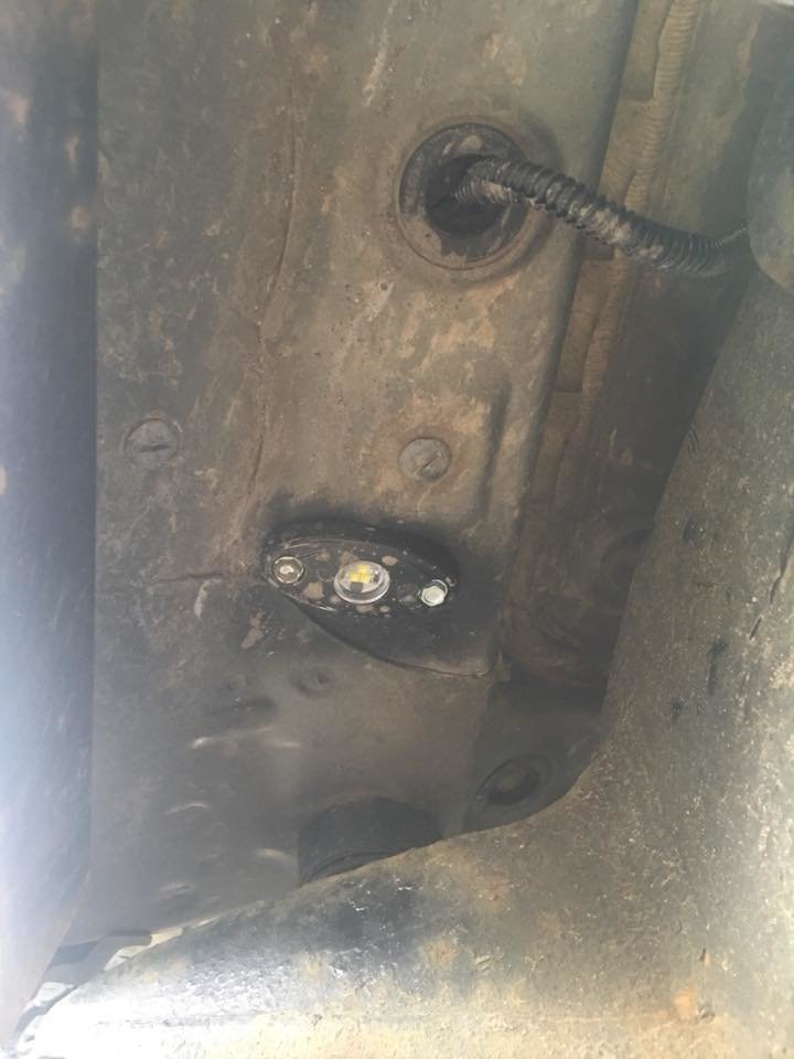

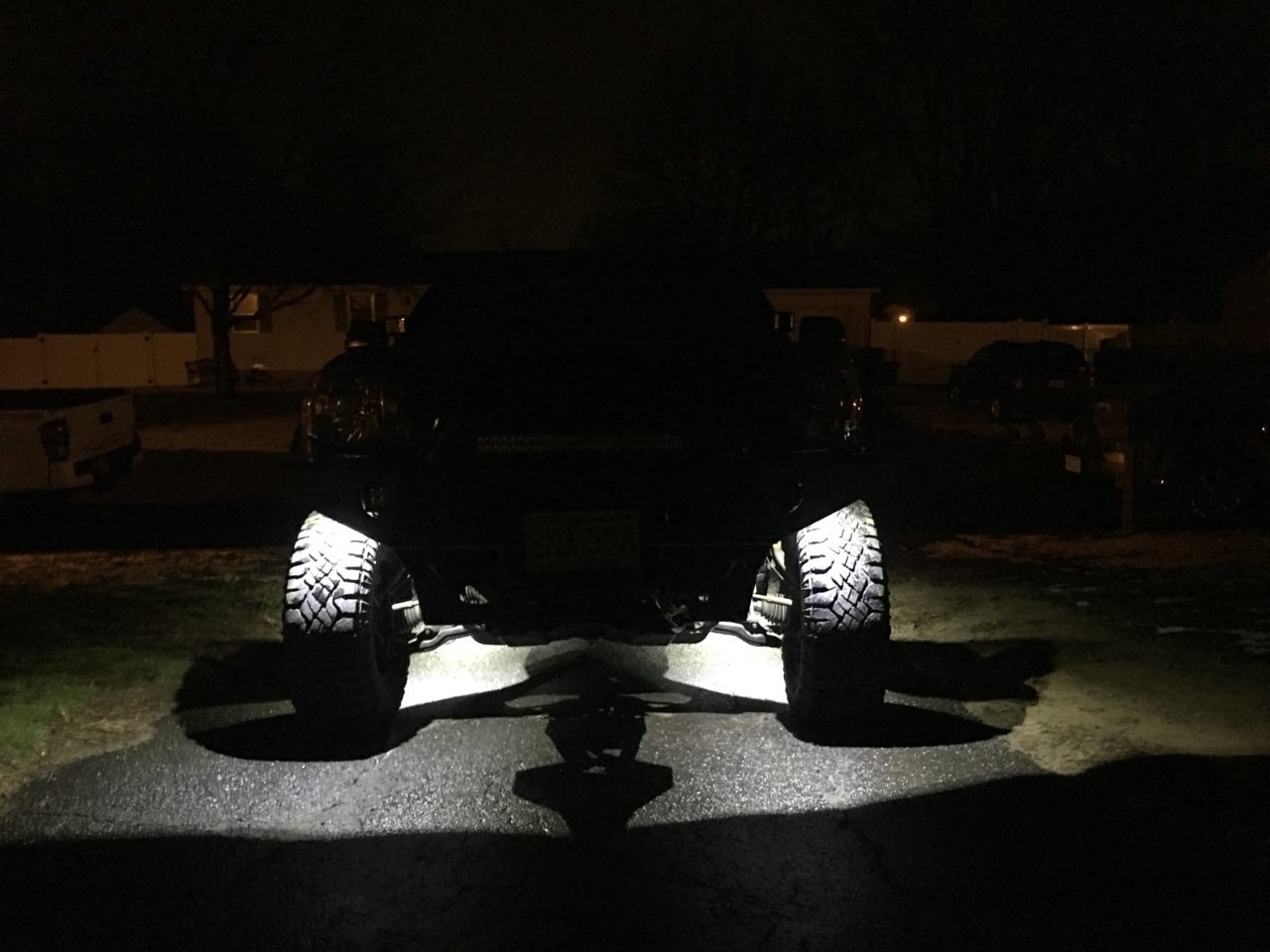

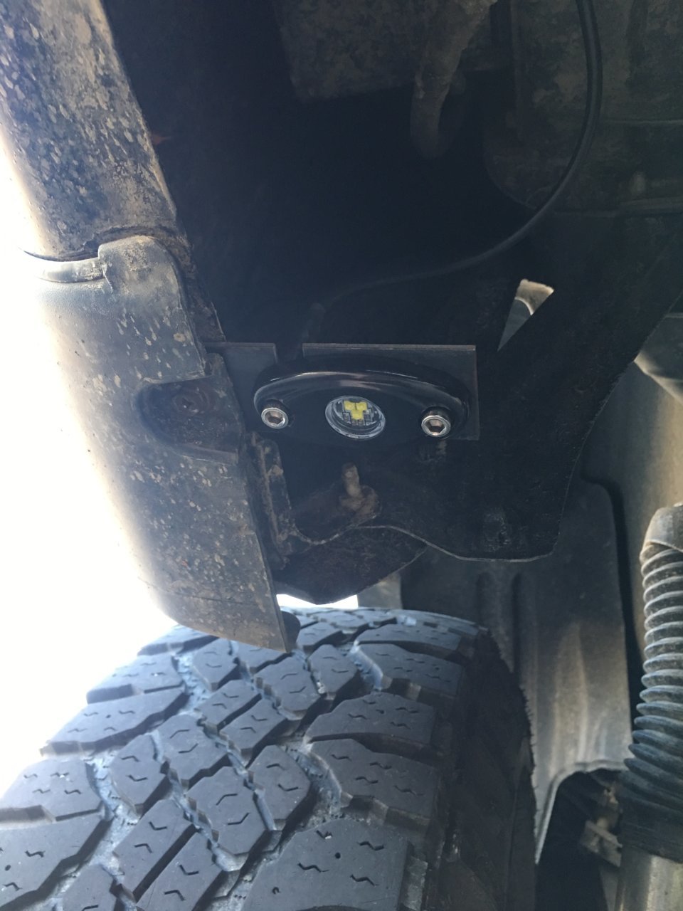

    Added rock lights last weekend!!

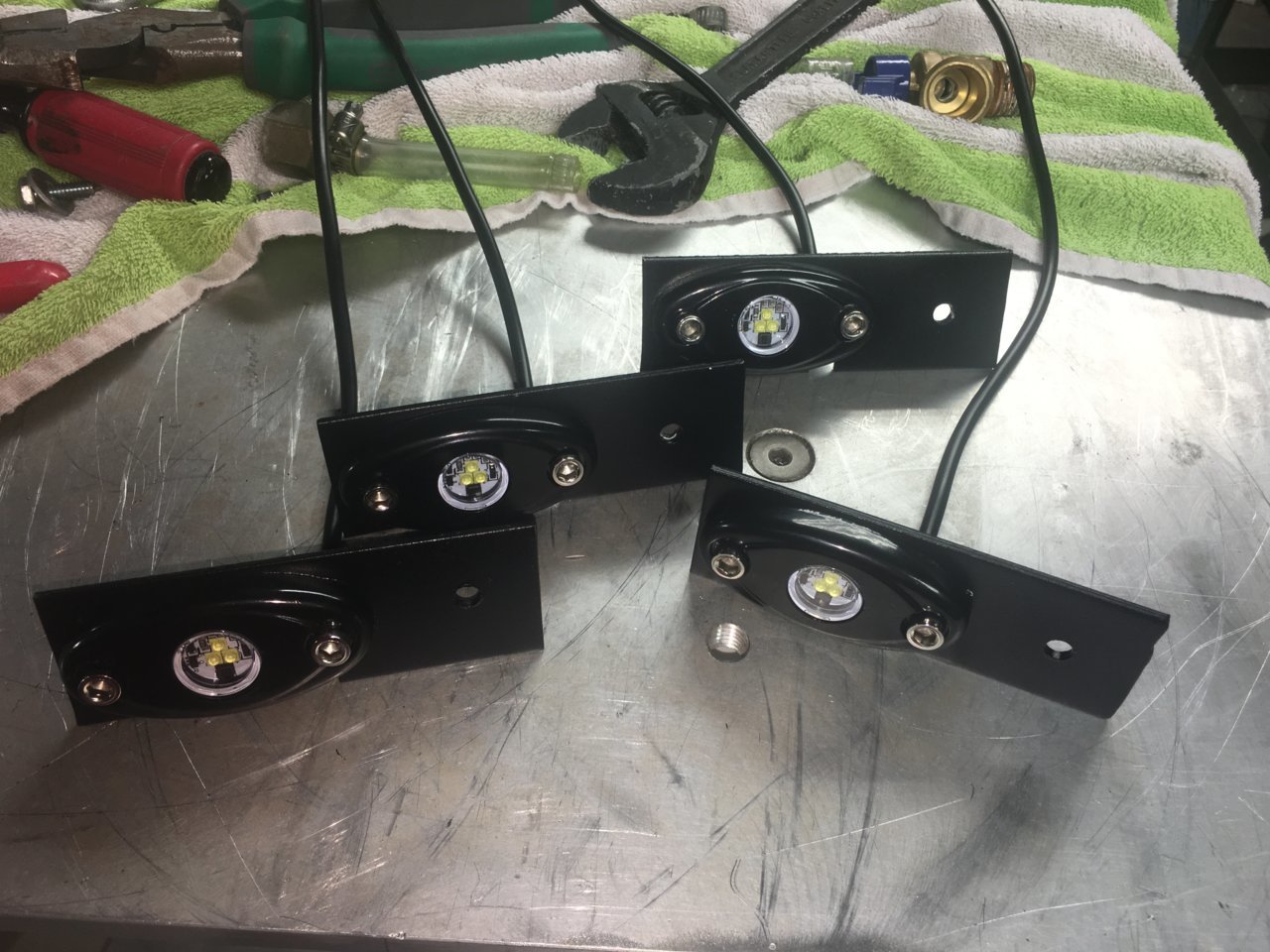

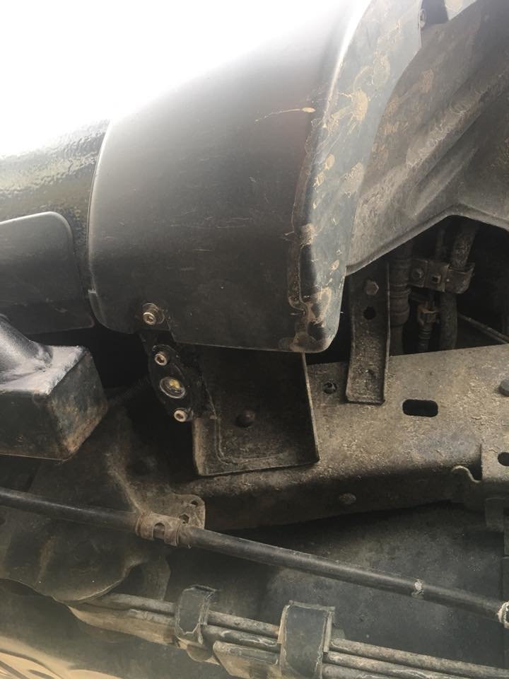

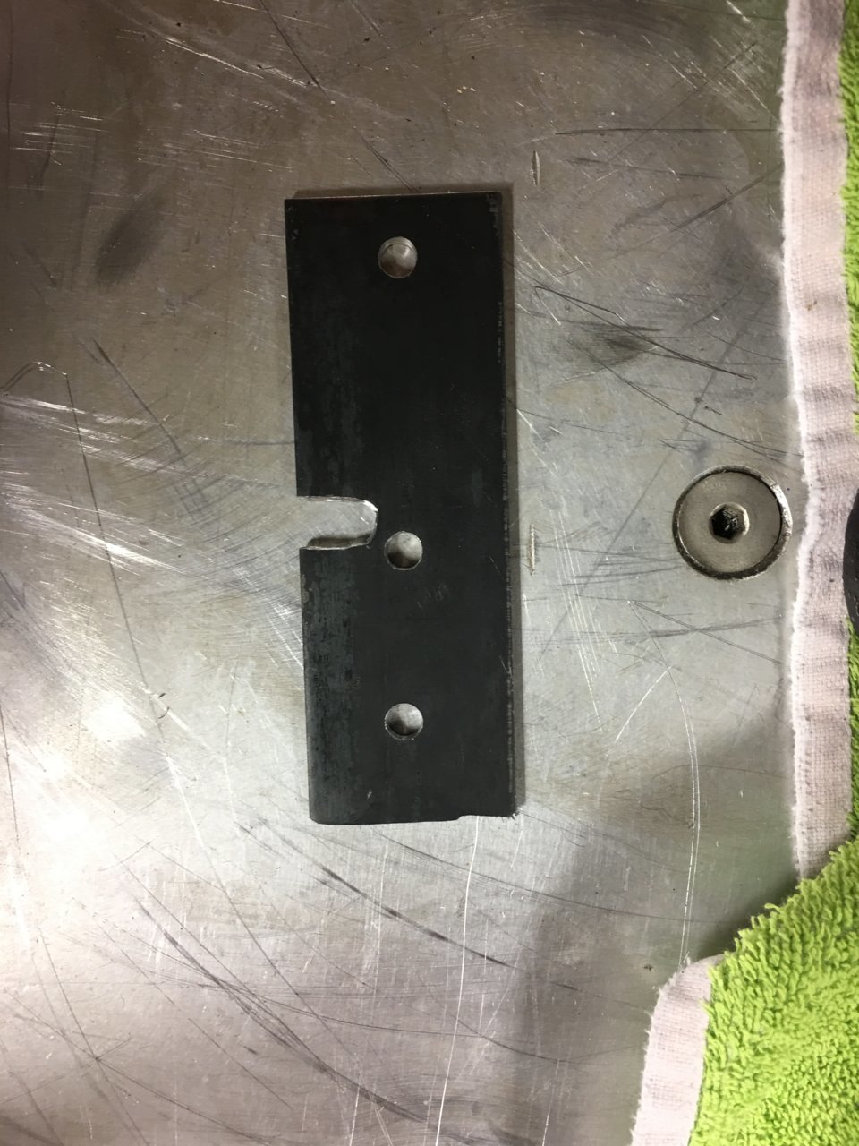

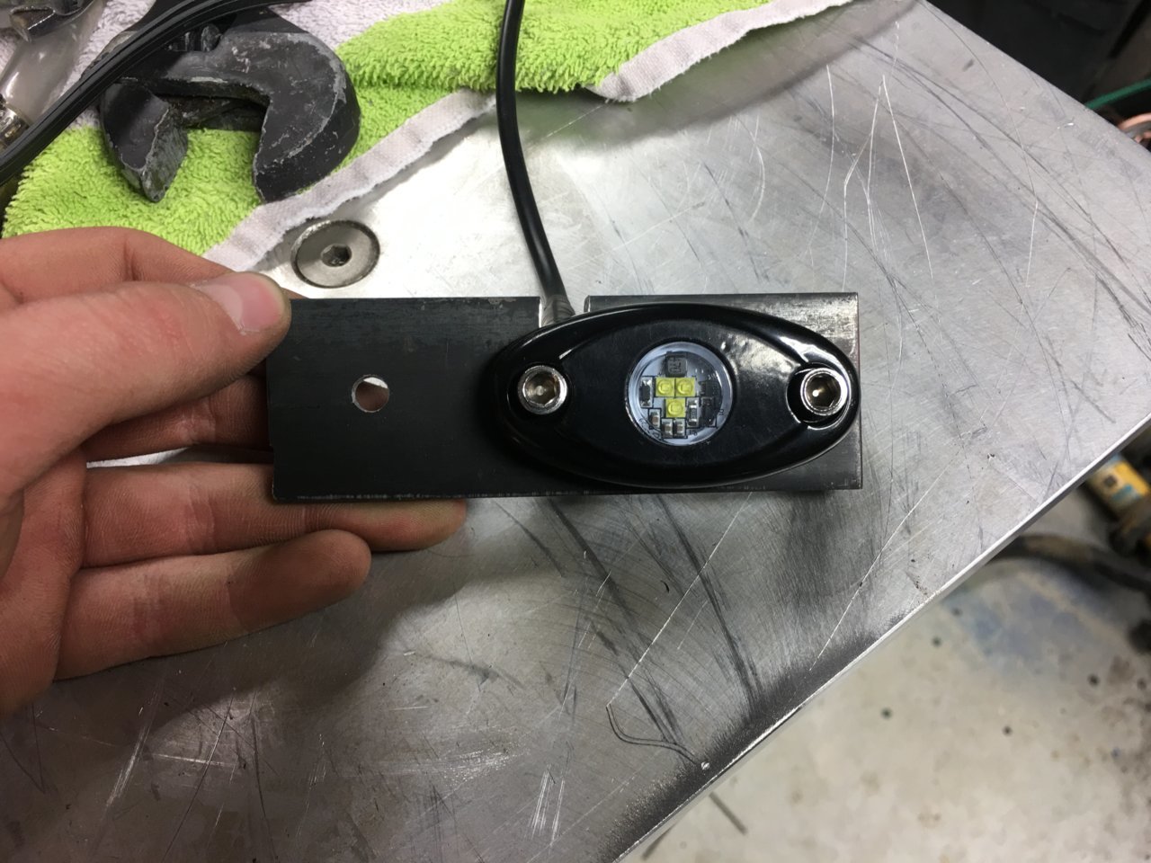

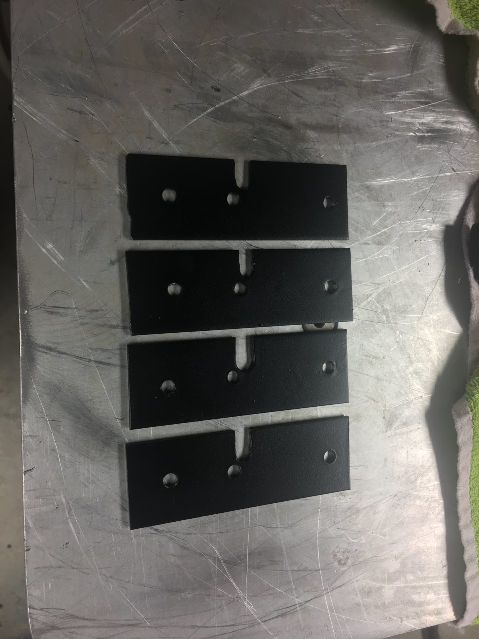

    There's 8 pods total. Made my own mounts for the rear ones, just made of 1.5" flat stock steel, used the drill press and dremel, and a little primer, paint, and clearcoat. I removed the screw that holds on the fender flare on each side, and used stainless hardware to hold these on. The front ones are screwed flush to the truck with stainless self drilling screws, wires go through the body under the headlight up front, and wires go through and out of the body using existing holes under the cab using a mechanical finger. Basically put 2 wiring harnesses together to make one for the 8 lights and each light has a 2 pin waterproof connector. All connections are heat-shrunk and taped. Wiring goes to my blue sea fuse block and an Oznium scion style amber lit switch.
    Here's the mount and test fitting
    after test fitting, I disassembled them, primed, painted and bolted the lights to the mounts with stainless hardware
    Mounted to the truck (again using stainless hardware) and wired up. little dirty from driving but here they are...
    30440994_10216802390798526_8930501863367_3320a180b527ae17c25c238ed8bd0d216926b78c.jpg
    30516739_10216802391558545_5894638976475_842de21a3588035da2c58e7b9e28dea7f2f157d0.jpg
    30414895_10216802391958555_6064802552791_24230b0ea9160cc9498b3dc97844844d654d6743.jpg
    30412110_10216802392398566_5563953209380_b29e11f5df78949922157b2d4a1ab6069602b39e.jpg

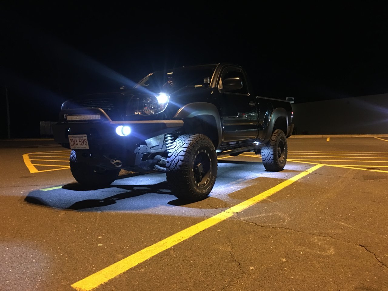

    and here they are lit up.
    [​IMG][​IMG]
    BajaAsh, Fleabag, pat's taco and 26 others like this.
