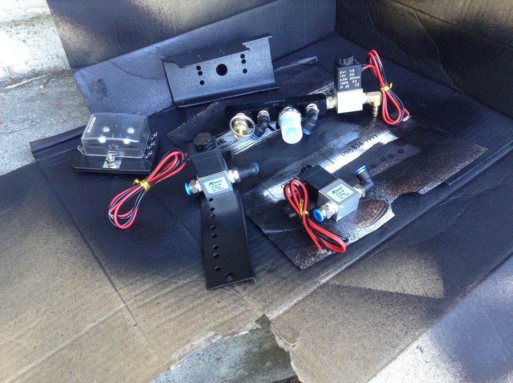

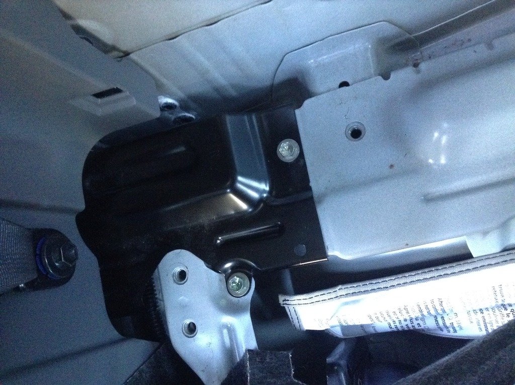

    Here's the 2.5gal tank stuffed up the bedwall with the drain petcock still missing. You can see the blue output to the cab and the new 1/4" grommets installed in the cab wall with some phenoseal gooped on(upper right corner of pic).9DEA2F37-7449-4A45-9F21-814FC5EC59DC_zps_580d50f05a84b1d3c7fca5cc0e5b3ae14101c7dc.jpg
    Here it is from the inside(just peaking from behind the black carpet backing plate). Image shows jump seat, bins, and rear wall cover removed.
    48BC361A-79EA-4F25-B747-3D0C2E37F022_zps_007e9adc4345d00bcde10790df3b4e34c94ca724.jpg
    And here's most of the stuff that goes into the console just behind the cup holders and under the storage box. (Clockwise from 9:00) 6 fuse holder(draws power from what will be the unused power outlets), mounting plate for the fuse holder and manifold(holder on top, manifold on vertical face), input solenoid attached to manifold that has outputs for (right to left: pressure regulator, pressure switch, input pressure gage, pressure relief valve), one of the lift bag solenoids, solenoid mount plate with RR solenoid control sitting on top(space for 5 total but only 2 needed for now)
    29C2130C-85C0-4A39-B2C4-F8572718CF48_zps_d0a66dda0049b89658f7422efbc5930ceaa33db2.jpg
    There are two unused 8mm threaded holes ~5" behind the e-brake yoke. The fuse/manifold bracket mounts to one at the back with a 1/2" nylon spacer and one of the yoke bolts in the front. The solenoid plate shares the same rear bolt and uses the one on the other side as well. The 1/2" nylon spacers allow it to clear the brake cables. Extra holes for the manifold mounted are because I decided to raise it to reduce the bend in the air lines and allow for some kind of shielding between them and the frequently moving cables. The 4-way solenoid for the cab/cap sliders gets mounted on the back wall to shorten the four lines to the two double acting cylinders. I still need a splitter to branch the regulator output to the various solenoids. If this all works I'll write it up in a build thread, if not it will be relegated to old page obscurity.

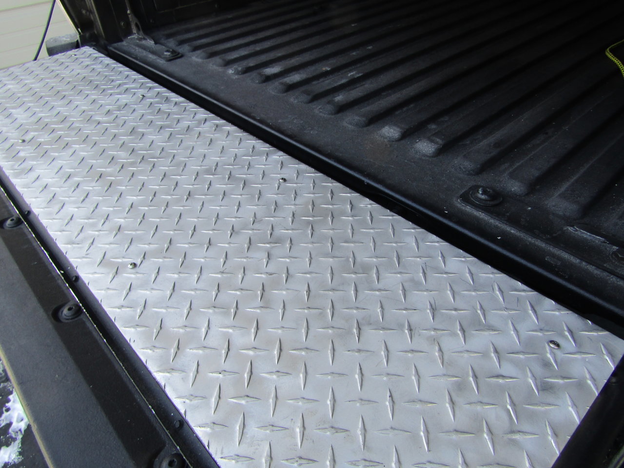

    I picked this up from a local shop outa the scrap pile for $35...had them trim it to size....not as fancy as a lot of the manufactured stuff, but does the same thing...
