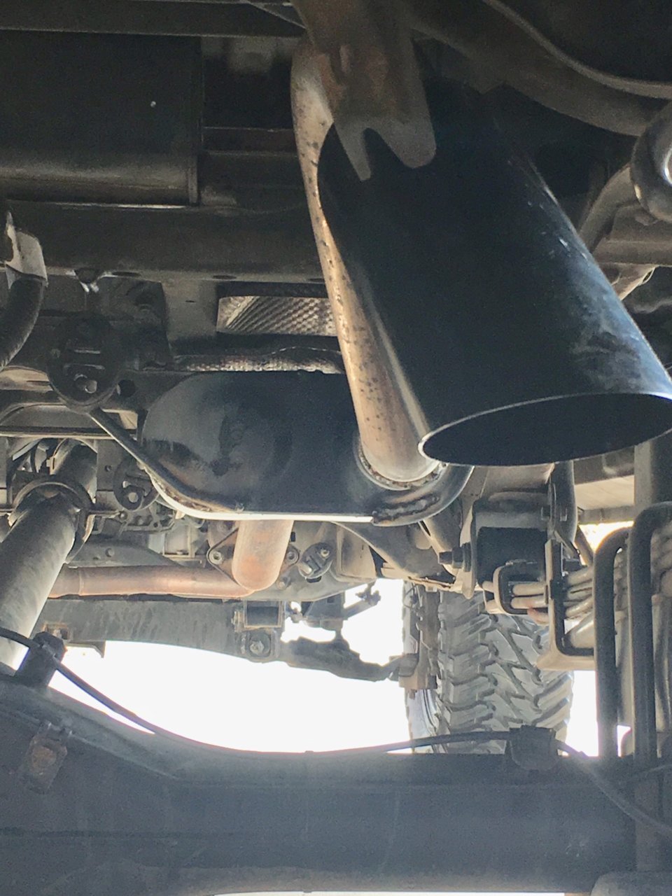

    Went to the local exhaust place on Oahu , had them put in a flowmaster 10 series & a single 4” tip under my bed :rofl:

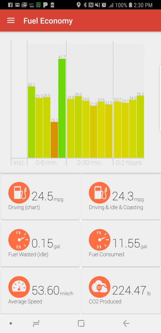

    Drove from NC to MD yesterday and got about 24.5 mpg which I thought was great

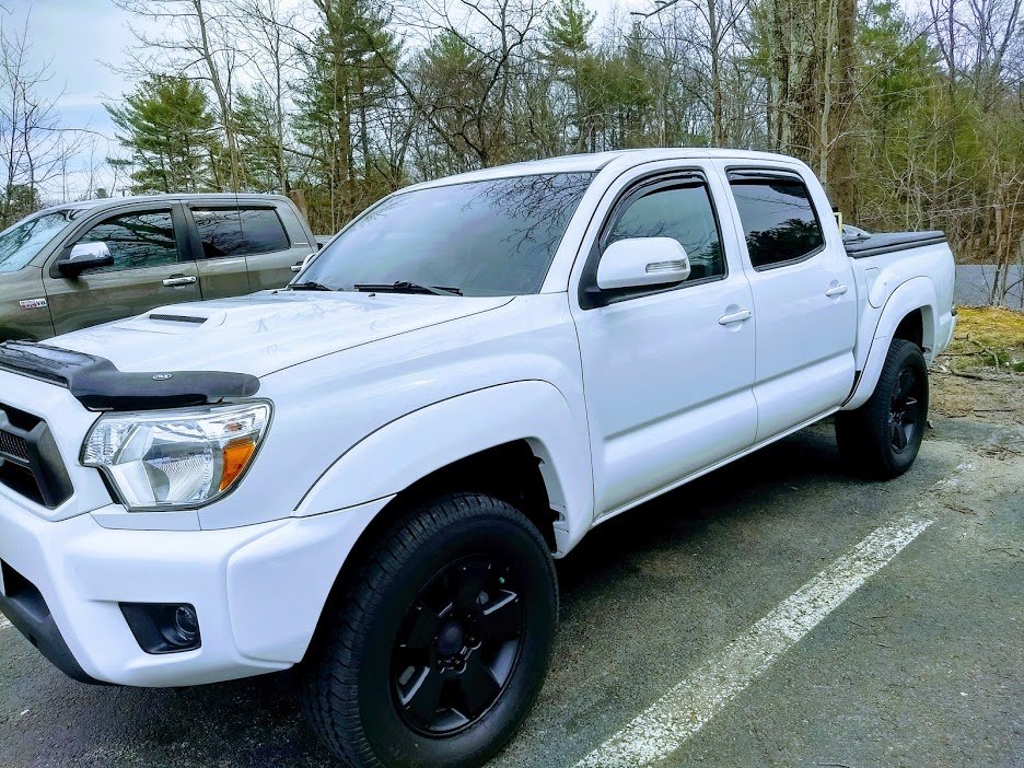

    Finished the lift today. Getting those leafs in and the centering pin into the perch so I could get the U-bolts in was probably one of the worst experiences of my life. But well worth it.
    Started 21" for both sides front and 22" both sides rear.

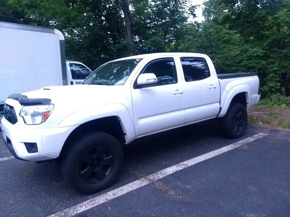

    Ended up with 2" exactly all around. We will see how much it settles. 23" both sides front and 24" both sides rear.

    Went with @HeadStrong Off-Road Bilstein 5100 kit and their coils. Included a 1/4" spacer to compensate for Taco lean. Great kit. Had everything I needed to accomplish the lift. I am very happy with the results.

    Yea, that centering pin part is the worst.

    I had to use a bottle jack to lift the leaf springs, a scissor jack to push the leaf pack inwards, and a 36" pry bar to push the axle forward. The skecthiest thing I've ever done.

    Dang, that sounds like the difficult way! Whenever I do rear leafs, I have two jack stands under the rear hitch lifting the body as high as it'll go. Then have the rear axle as low as it'll go on a floor jack. With the axle juuuust under the leafs, you can just wiggle the axle around by hand until it lines up.

    I'll have to try this if I ever have to do it again.
