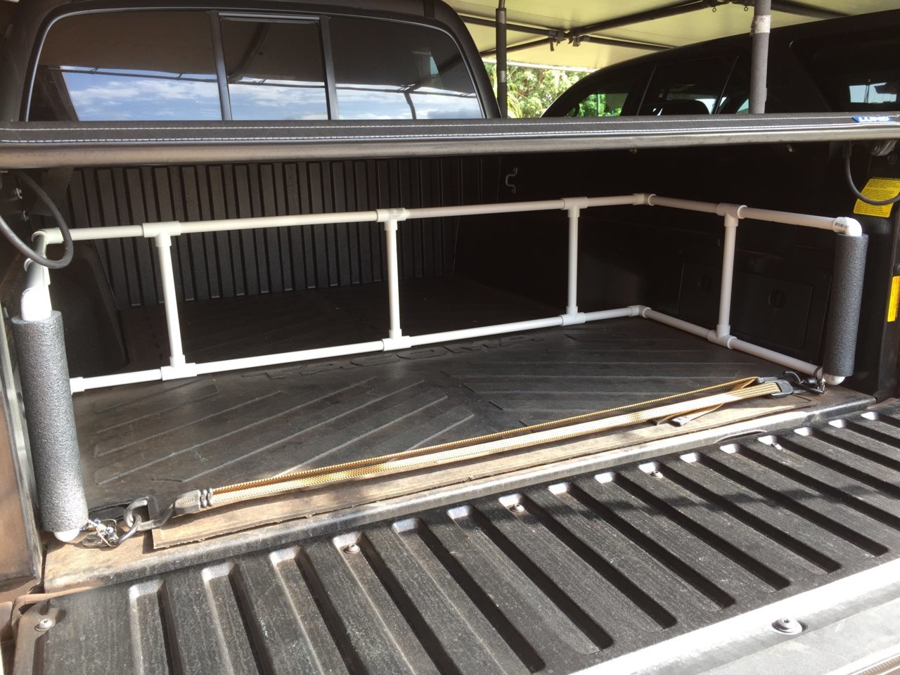

    Nice job! I would add a cargo net across the bed dividing the extender in half. That allow you to transport smaller loads without them tipping over or keep two different loads separate. Using some Velcro will allow the net to be removed if you need the full space.

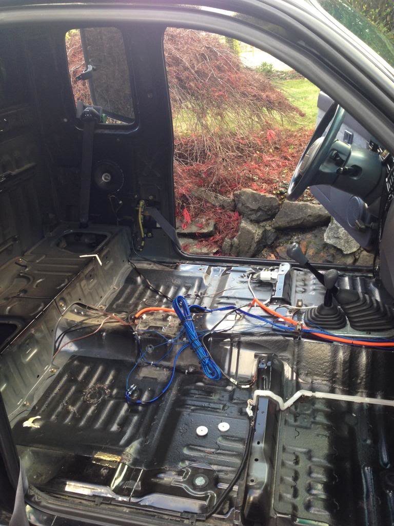

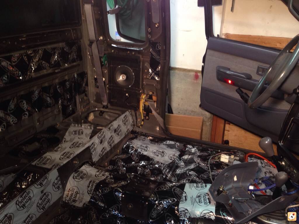

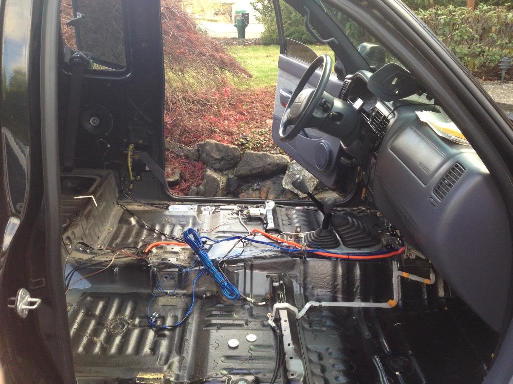

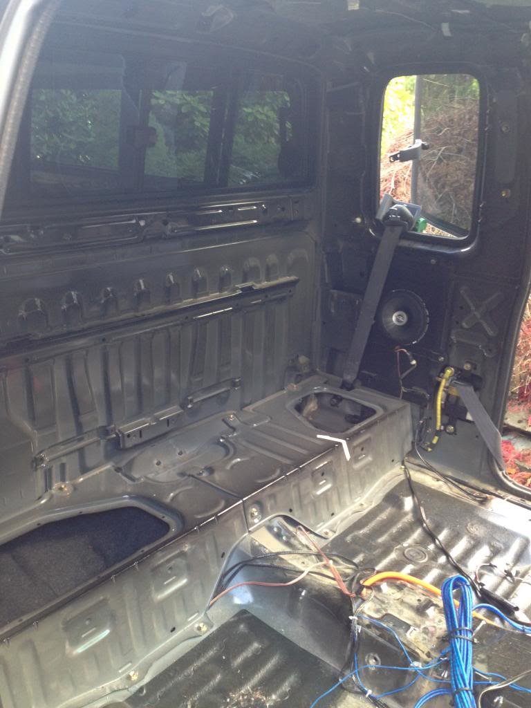

    I've got a pretty similar experience as @dlawrence529 with this one.
    I saw a reduction in road noise (not overwhelming by any means, it's no Lexus), it was noticeable... but even more so I heard a better sound quality when listening to music with the windows all the way up --> I have a bad habit of keeping them cracked now that I have the EGR In-Channel Window Visors :oops:
    I used Dynamat at first to do the flooring -- which I wouldn't say don't bother, but Toyota did a GREAT job on the 2nd Gens vs. the 1st Gens on "sound deadening" from the factory
    The back wall is bare so I did that, so is the roof/ceiling... that there might be nice to do, especially in a state with heavy rain, or hail :notsure: I had a video of the difference of the some metal when dropping it on the ground bare vs. with sound deadening material on it and it is night and day.
    Some 1st Gen Pics of the OEM (or lack-there-of sound deadening) the black squares weren't really contributing anything to noise/vibration reduction:
    Then it all "sound deadened"

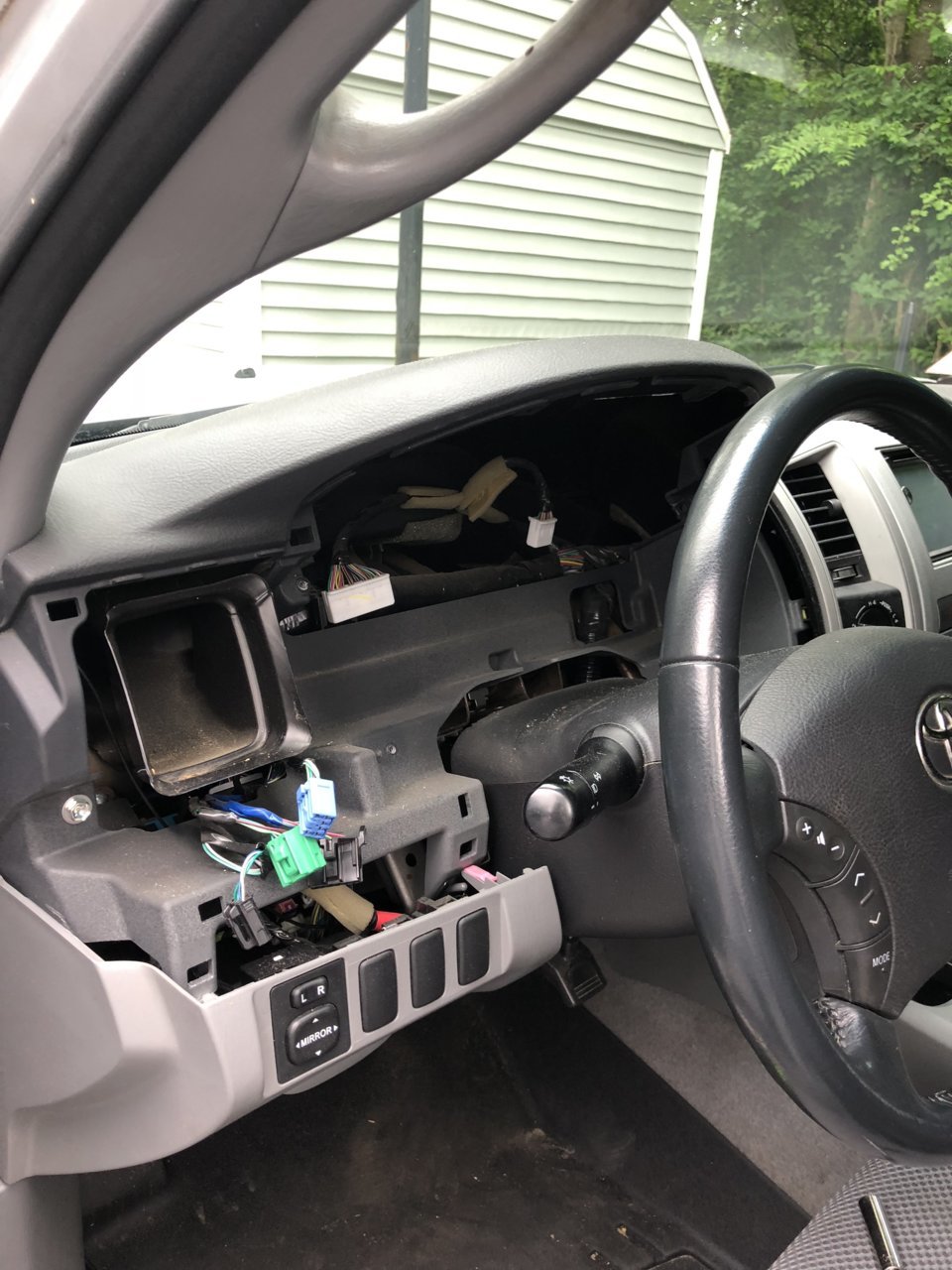

    Yeah I permanently disabled it. I desoldered the led bulb from the board, but unfortunately didn’t take a picture of what contacts to work with. It’s pretty easy to do. There might be a way to disable it with techstream, but I didn’t feel like waiting lol.
    Btw That whole removing the TPMS monitor above the headliner doesn’t work, if you run into that thread.
