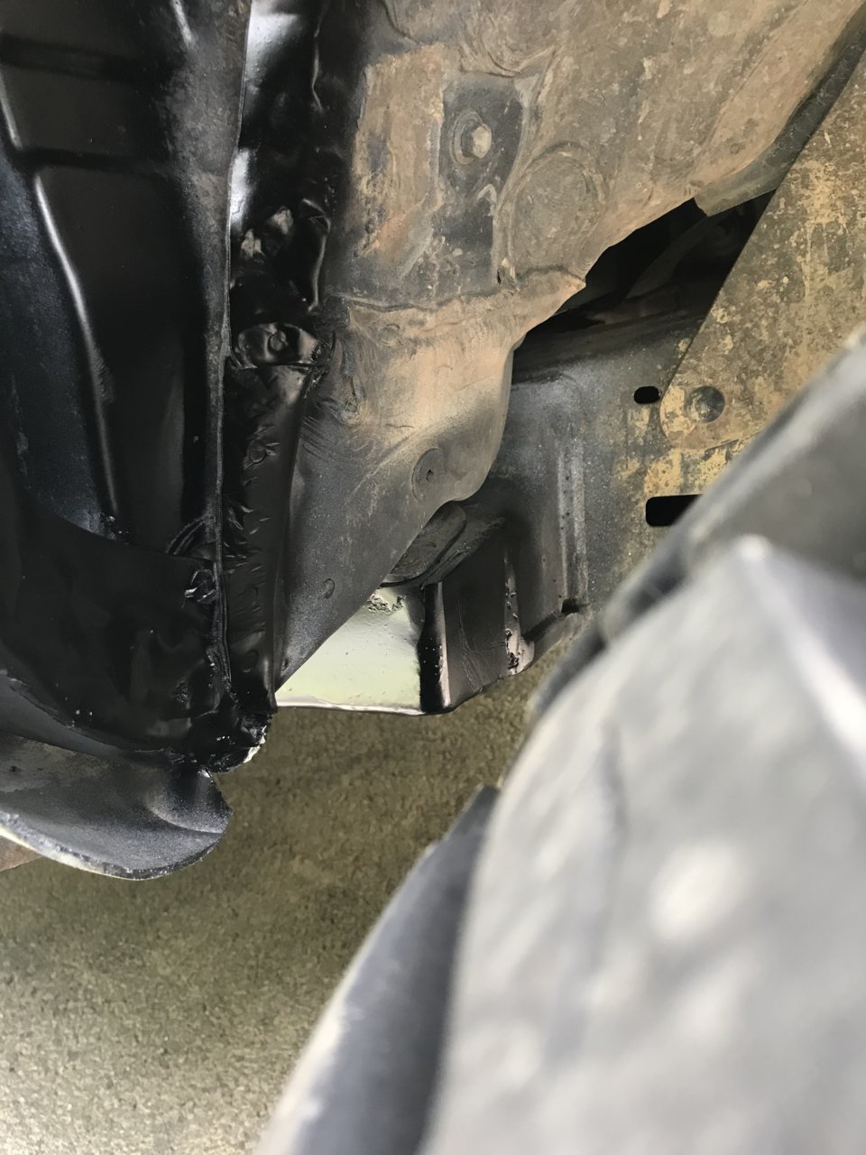

    I’m not “destroying” it. I’m doing exactly what I bought my truck for, which is a play toy. Like I told the other guy, I know I could have gotten an alignment and gotten another degree or two of caster and cleared, but that’s $100 and I’m not sure when I’m going to get one next. This cost me nothing.
    Since I already had to cut the cab mount and hammer the pinch weld, what’s the difference if I do it a little more?
    Also, do you clear full stuff, lock to lock? I pulled the coil over and tested it, cleared everything, and I STILL rub when wheeling. So whenever someone says they clear and don’t touch anything, I’m a bit skeptical.

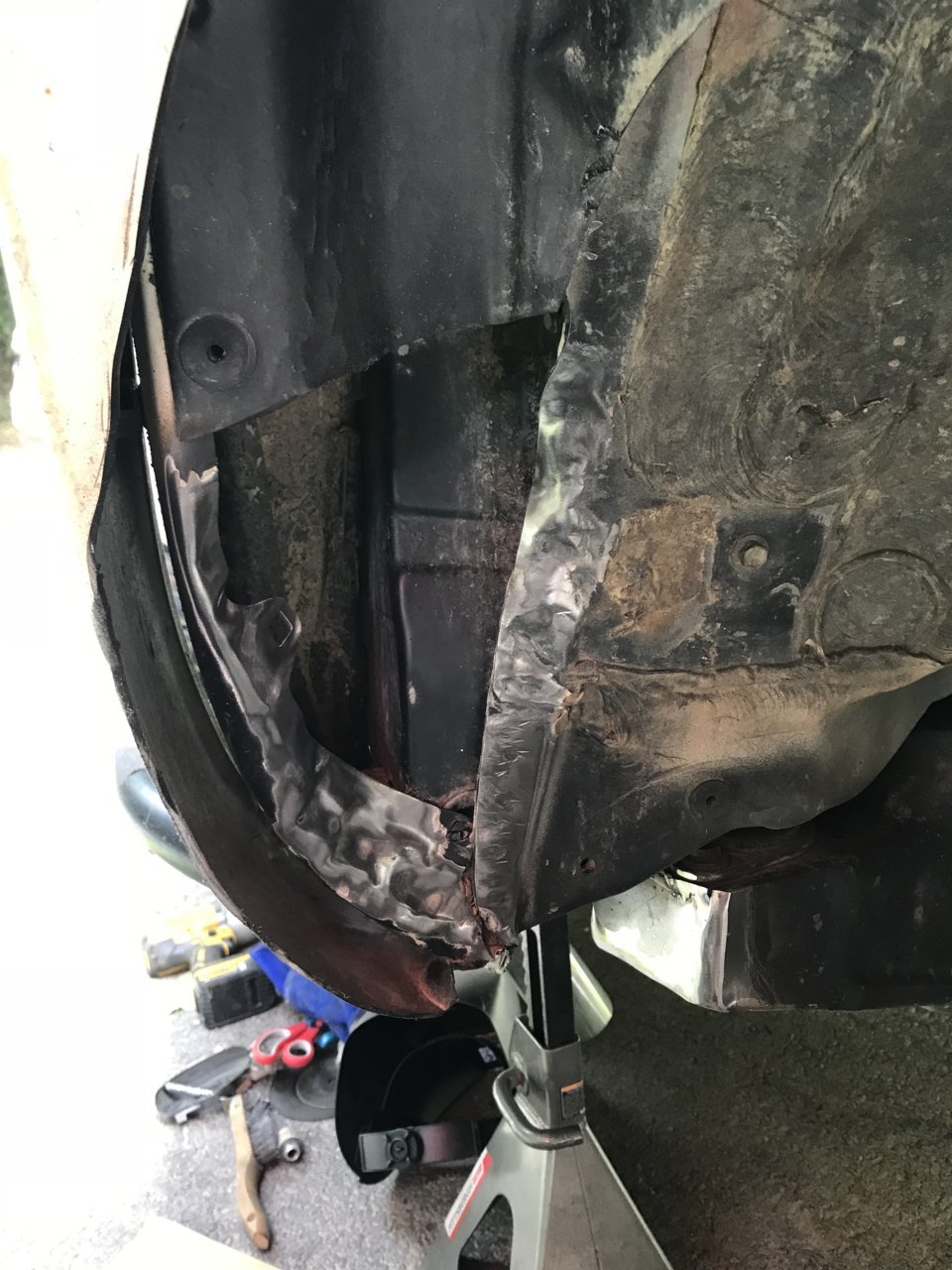

    I cut the pinch weld off with a cut off wheel, then mig welded the seam. After that, flex seal to the rescue. No leaks. Perfectly flush seam that's every bit as structurally sound as orginal. Cab mount is cut as far as possible. Clears 33"'s at full lock and full stuff by enough I feel comfortable with 35's after fenders get trimmed a little more in a few days.truck is not "destroyed", just different.
    I laugh when I hear people say they clear big tires without cutting. Mall parking lots dont give a very clear picture of tire clearance

    That’s what happens when you hit stuff with a 3lb hammer :rofl: you’ll see when you go to “hammer your pinch weld a little bit”. The bottom part is fucking stout and requires some really hard hits.

    I have SPC UCA's & caster @ 3.9 & 4.4. I don't rub on the cab mount but do on pinch weld. Believe it or don't. Doesn't mean shit to me either way.

    I may do as the other guy said & cut the pinch weld off & mig it back together. It'll look good & hold well.
    I've trimmed pinch welds before & found that putting small cuts in them helps tremendously on keeping it civil. Having said that, I've never done it on a Taco so it may work out differently.

    This is how my pinch weld was flattened.
    Cuts then hammered over.
    Helps a lot.
