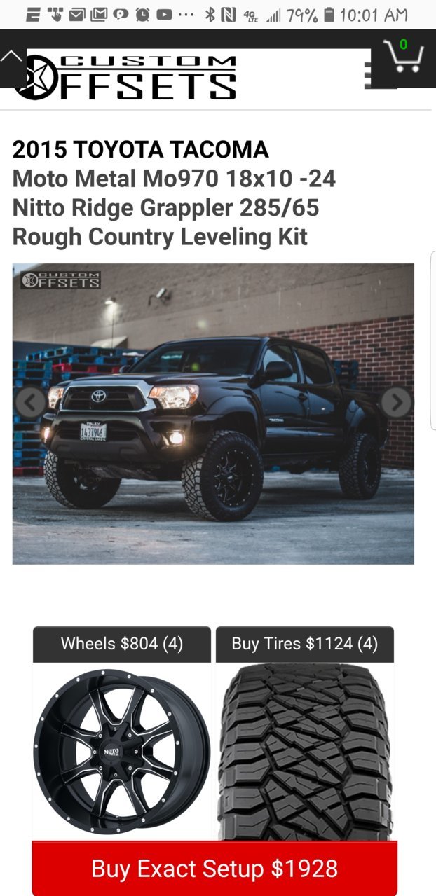

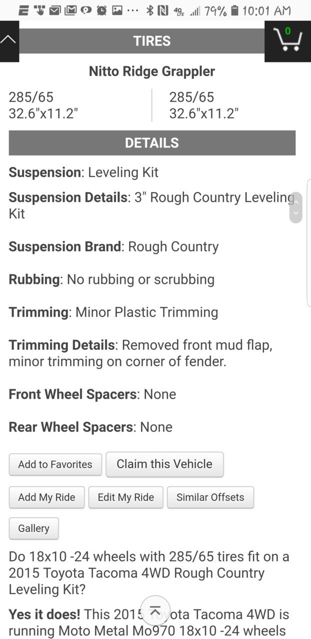

    Been watching this truck it only got a leveling kit and can fit 285s with no rubbing and I watched the video on it all they had to do was take off front mudflaps. Does this sound right?

    You'd rub as soon as you hit a bump while turning.

    U think a 3" lift would clear them?

    No

    It would still run bad on a 3" lift? Even with a little trimming?

    There isn't such a thing as a little trimming. You cycle the suspension and trim where needed. Then they will clear. Each truck is a little different.
