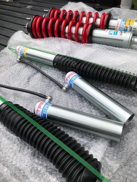

    I got a new Puzzle!

    Where by chance did ya snag these at?

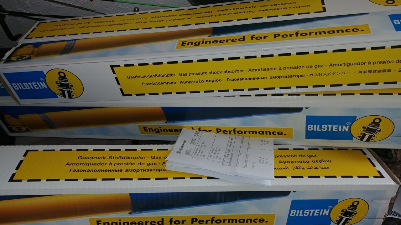

    Enough for all four corners...

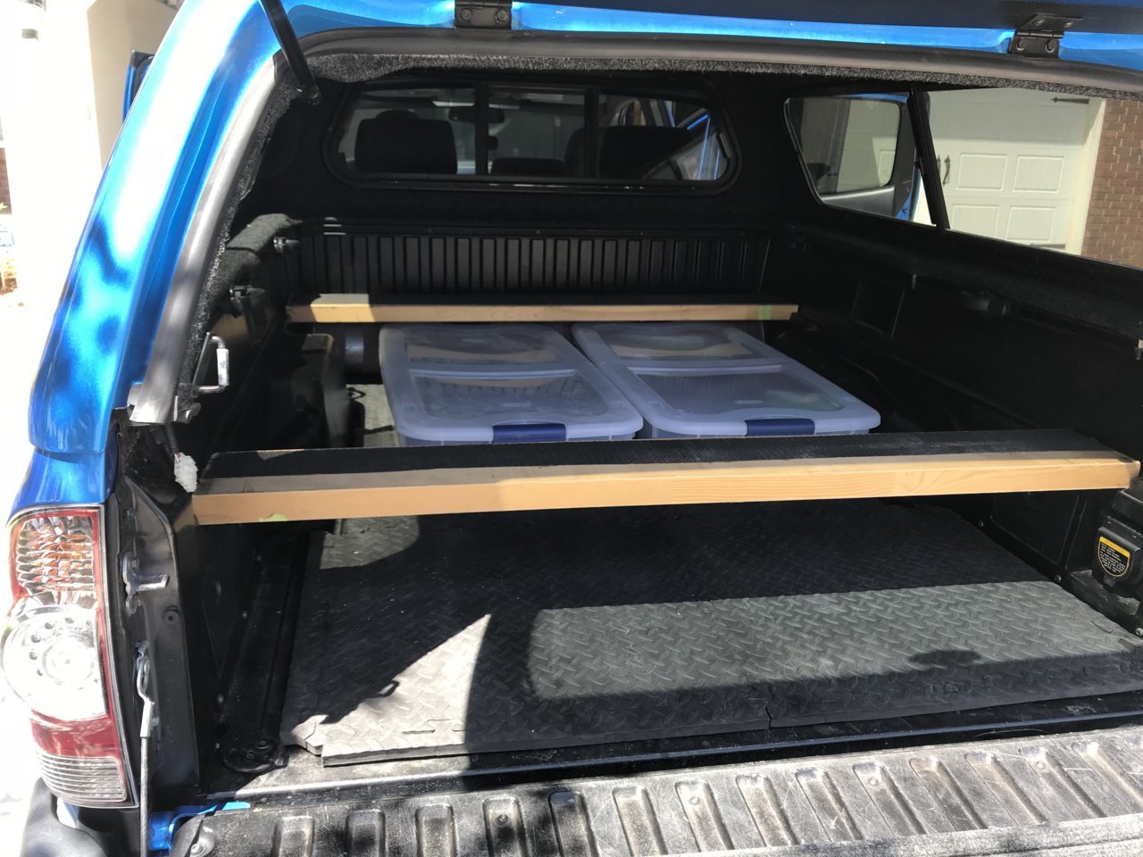

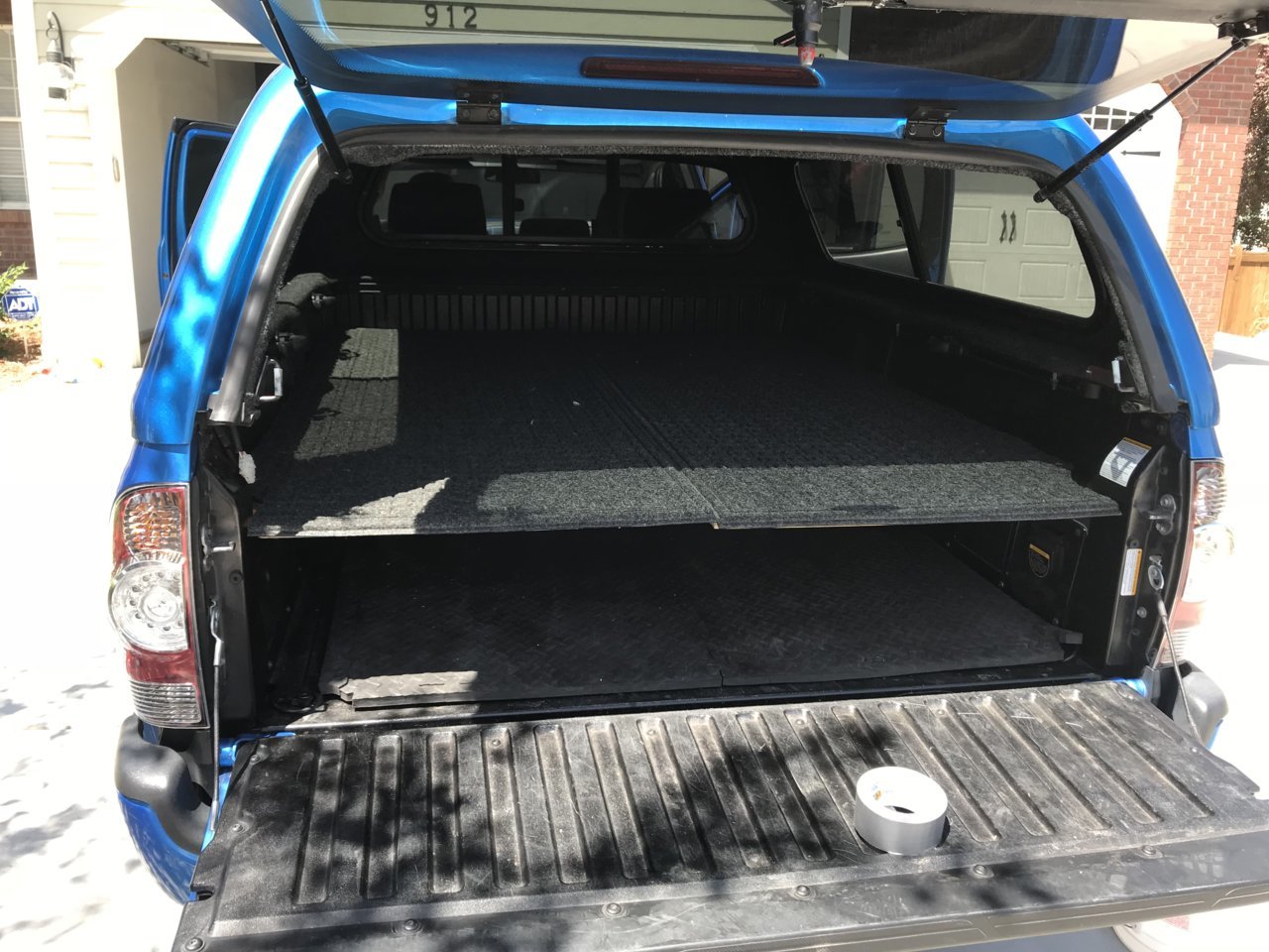

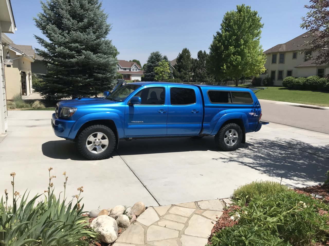

    9B7E61A9-C32D-4DAC-A1E3-E3A1EF1087CF.jpg DBC585E0-BD9A-42D9-B879-622ED3AB56E1.jpg 053F54AB-2F4E-4B93-A0C5-A8F146A510EB.jpg Put together my DIY bed platform/bins. Protected by heavy duty gray carpeting (knock-off bedrug). Super convenient for camping, skiing and trips to the gun range. Protected by my SnugTop Rebel.

    I think they're the last available in the U.S.
    One dealer took my$ and returned it the next day, saying not available.
    I found this set from a nice guy on CL in AZ.
    We made a deal and Bobs your Uncle!:thumbsup:

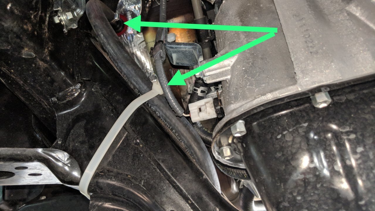

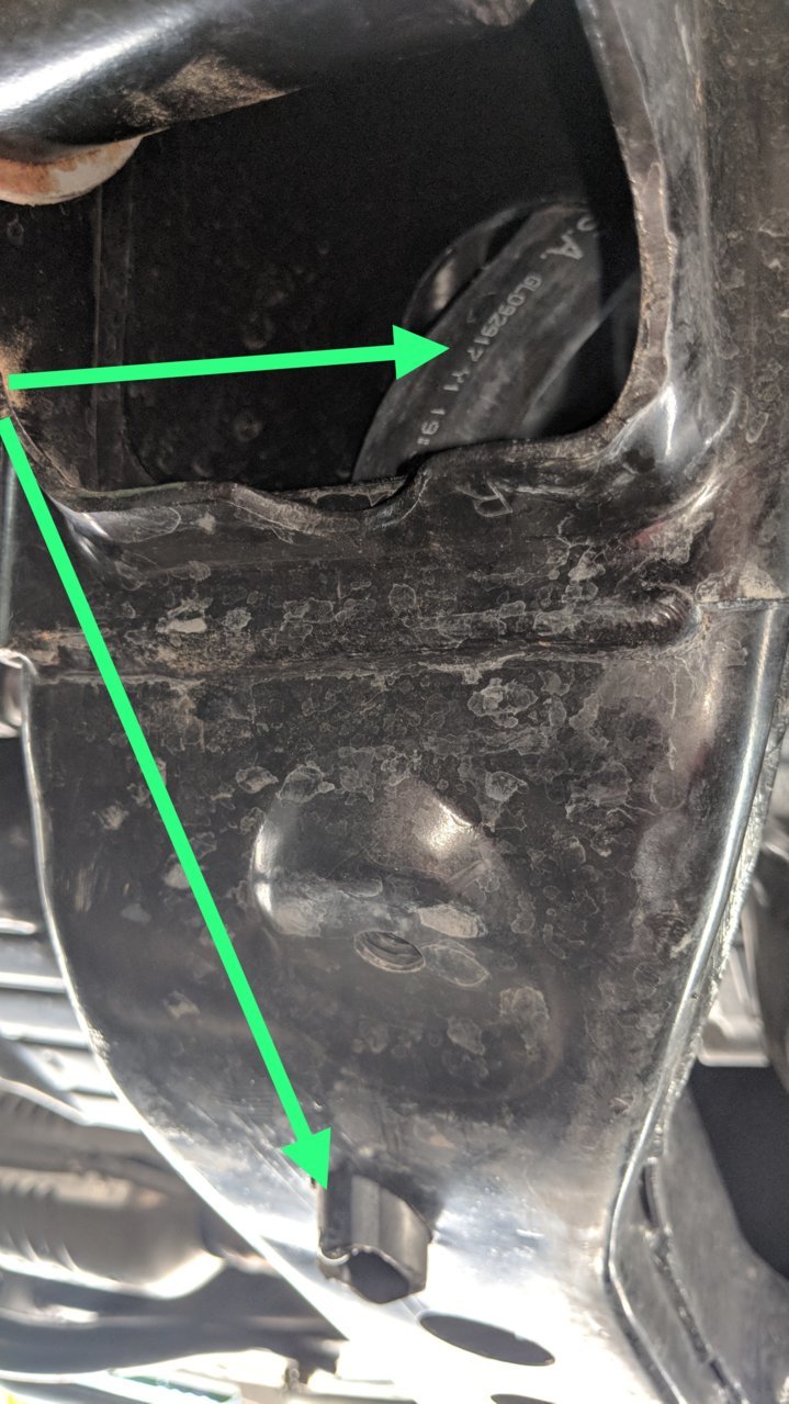

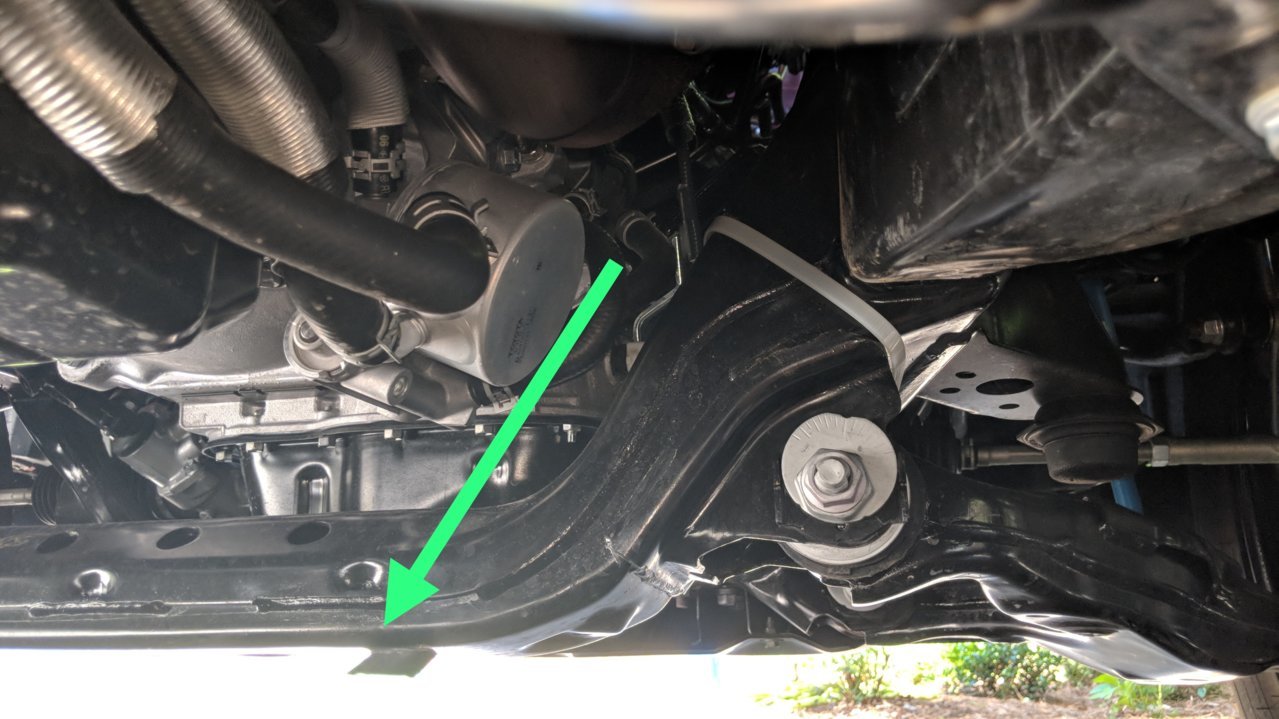

    Did an a/c mod this morning. Pic1 shows where I attached the 5/8 heater hose with minimal bend and secured it with a zip tie. Pic2 shows where it enters and exits the frame crossmember.Pic3 is a snapshot of where it exits and trimmed it down to 1/4". I had O'Reilly auto parts cut me 28 inches and it cost me about $4 bucks.

    What does this do?

    Let’s the AC water drain onto the ground instead of the frame.
