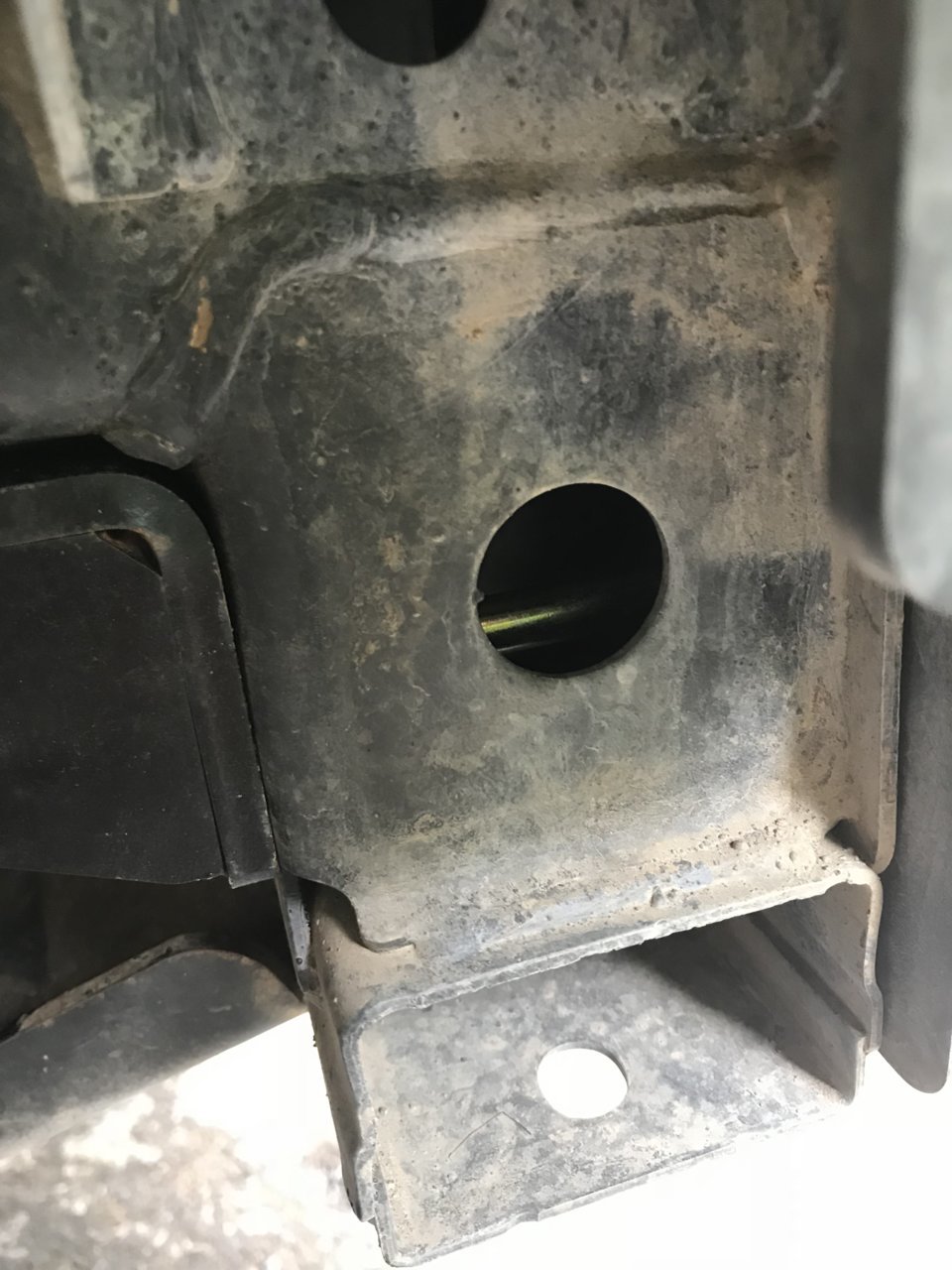

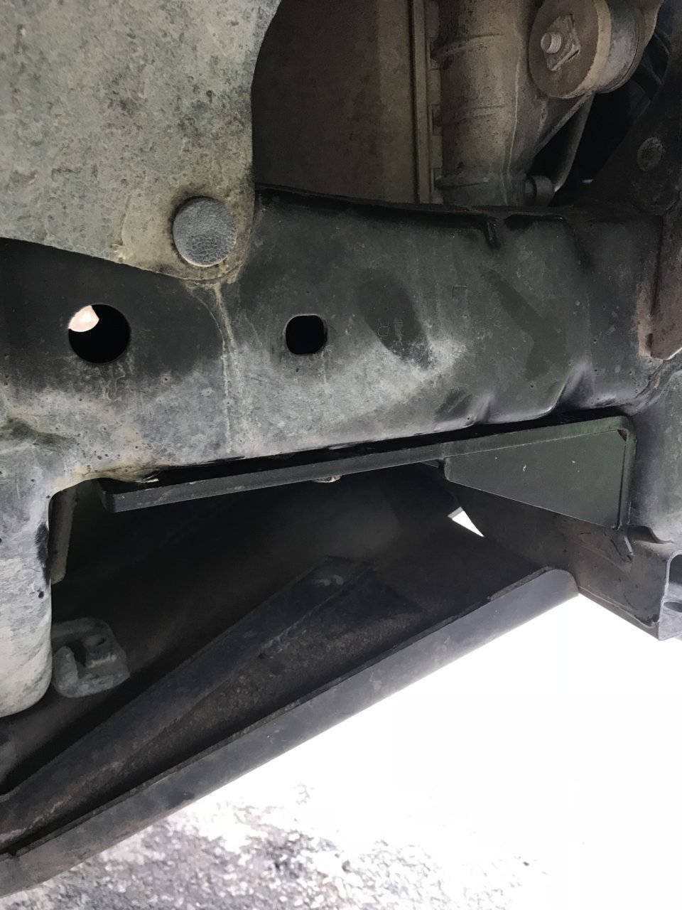

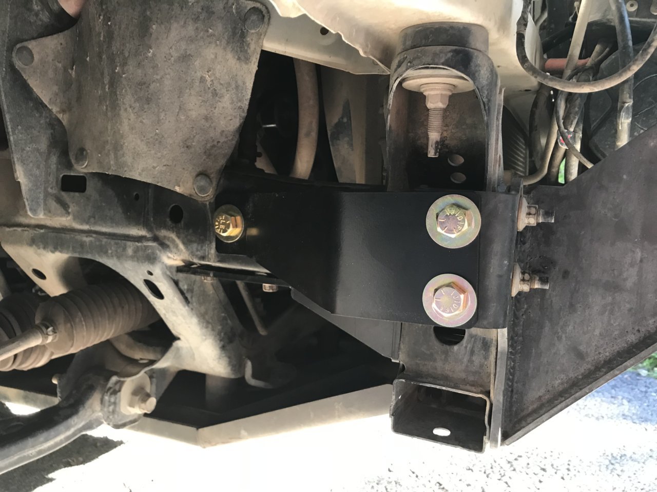

    Both braces are included with the mobtown front bumper. The bottom 90° part could work with your bumper, but you’d just need to drill a couple holes. The side ones wouldn’t work at all for you
    They’re not on their website but pm @Mobtown Offroad and he may sell you a pair.
