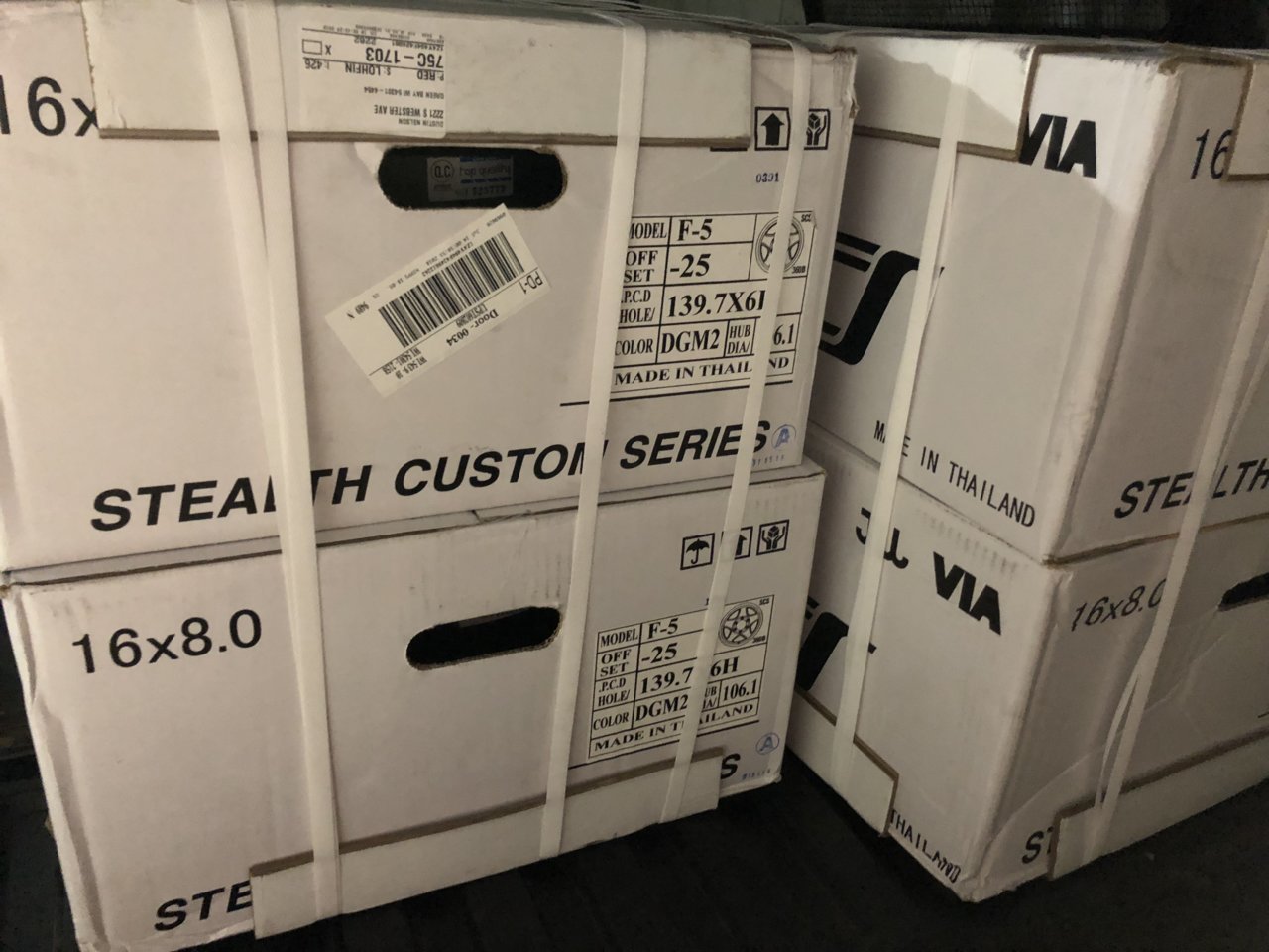

    Not what I have done to my second gen today... but what I will do tomorrow!

    And what tires are going on them?

    Since I am just starting grad school and won’t have any time to wheel or explore... the mud tires I wanted are out, ATs are in. BFG AT KO2 295/75R16 are getting installed tomorrow. Here’s hoping the trimming I’ve already done (yet unplated cab mount chop (just in case I need to chop more), pinch weld flatten, fender liner and flare trimming) will be enough...

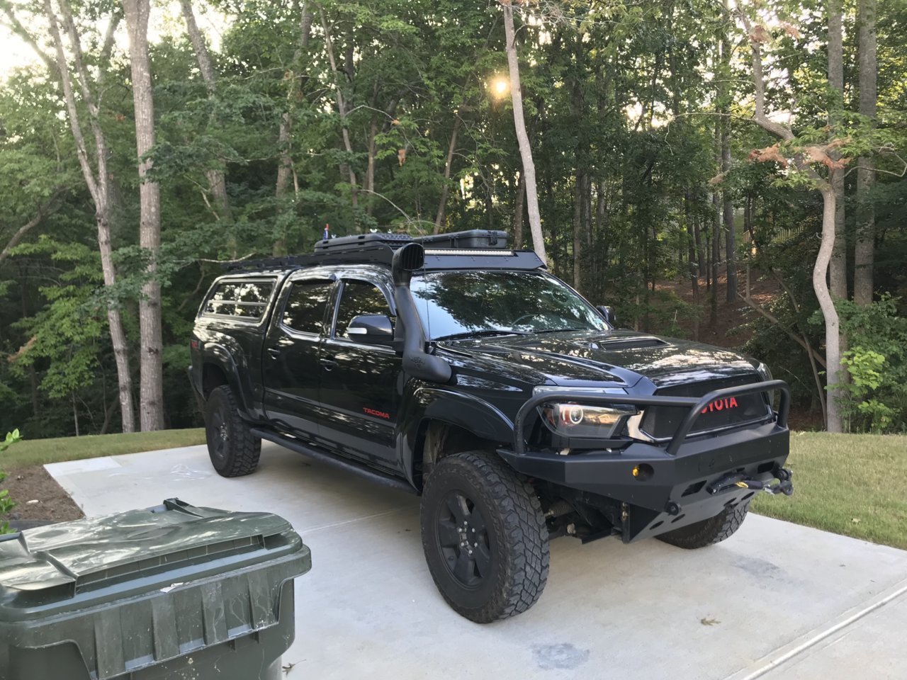

    Snorkel install!

    Cool I like that tire size can't wait to see pics good luck

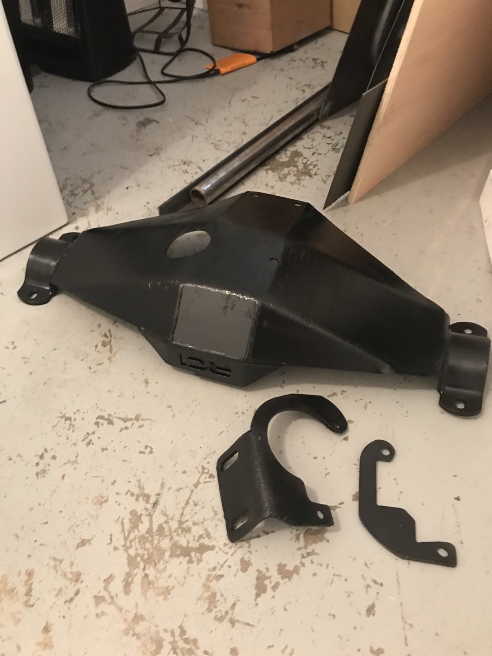

    The other day when I was replacing all my u joints, I noticed my RCI diff skid had a crack in it. Cleaned it up, wire wheeled it, heated and hammered it sorta straight again, welded the crack, and repainted it.
    [​IMG][​IMG][​IMG][​IMG][​IMG][​IMG]
    You can see here how bent the left side is. I heated it with a torch and hammered it back into place with a BFH.

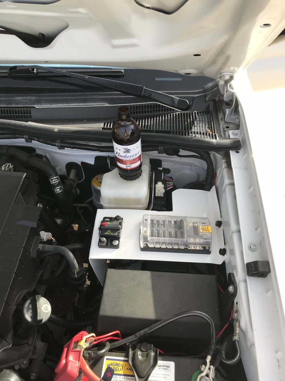

    Love it man! What you gonna wire to it 1st?

    What the F were you trying to CLIMB?
    Did you know that going around can be sometimes easier. ;)

    Sometimes going around isn’t an option :D

    Thanks.
    I already wired up my light bar, bed lights & a couple other things to the battery when I was hurrying to get it ready for a trip to Big Bend NP. I'm going to re-wire all that to this panel & wire in my fridge.
