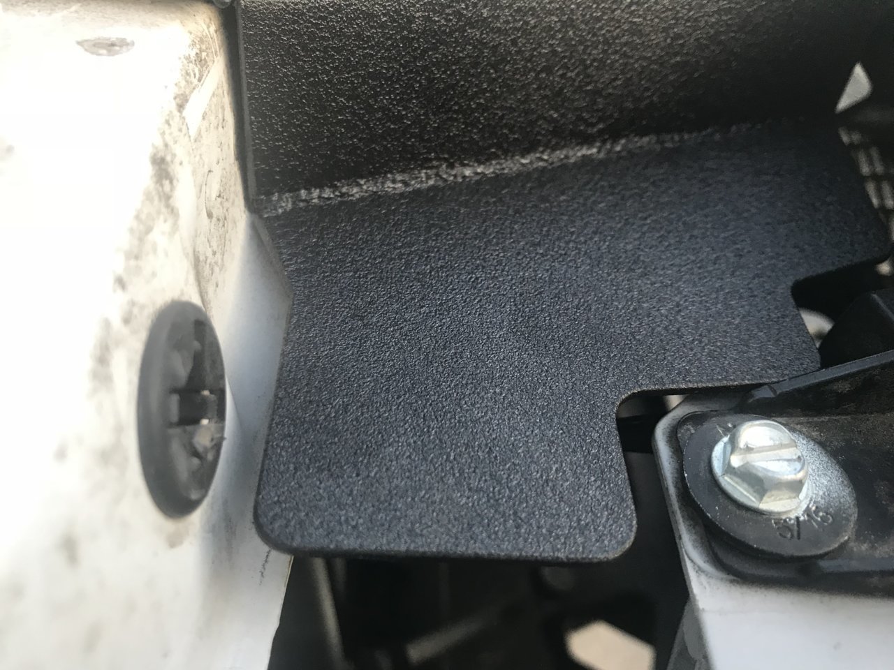

    From memory, the current product was never specifically designed for the 2012-2015 Tacoma and there are slight differences between those years and the 2005-2011 Tacoma under hood design. This one is close, but not perfect. The holes on top where the plastic fasteners are used do not quite line up perfectly and it is a very tight fit to get them to sit in correctly. I ended up getting out my angle grinder and cutting the corner off from several places where the panel touched. I also added a few pieces of black padding in a few key areas where I noticed some rubbing between the hood and the piece. Maybe yours will fit a little better than mine, or maybe they have made some improvements to the original design.

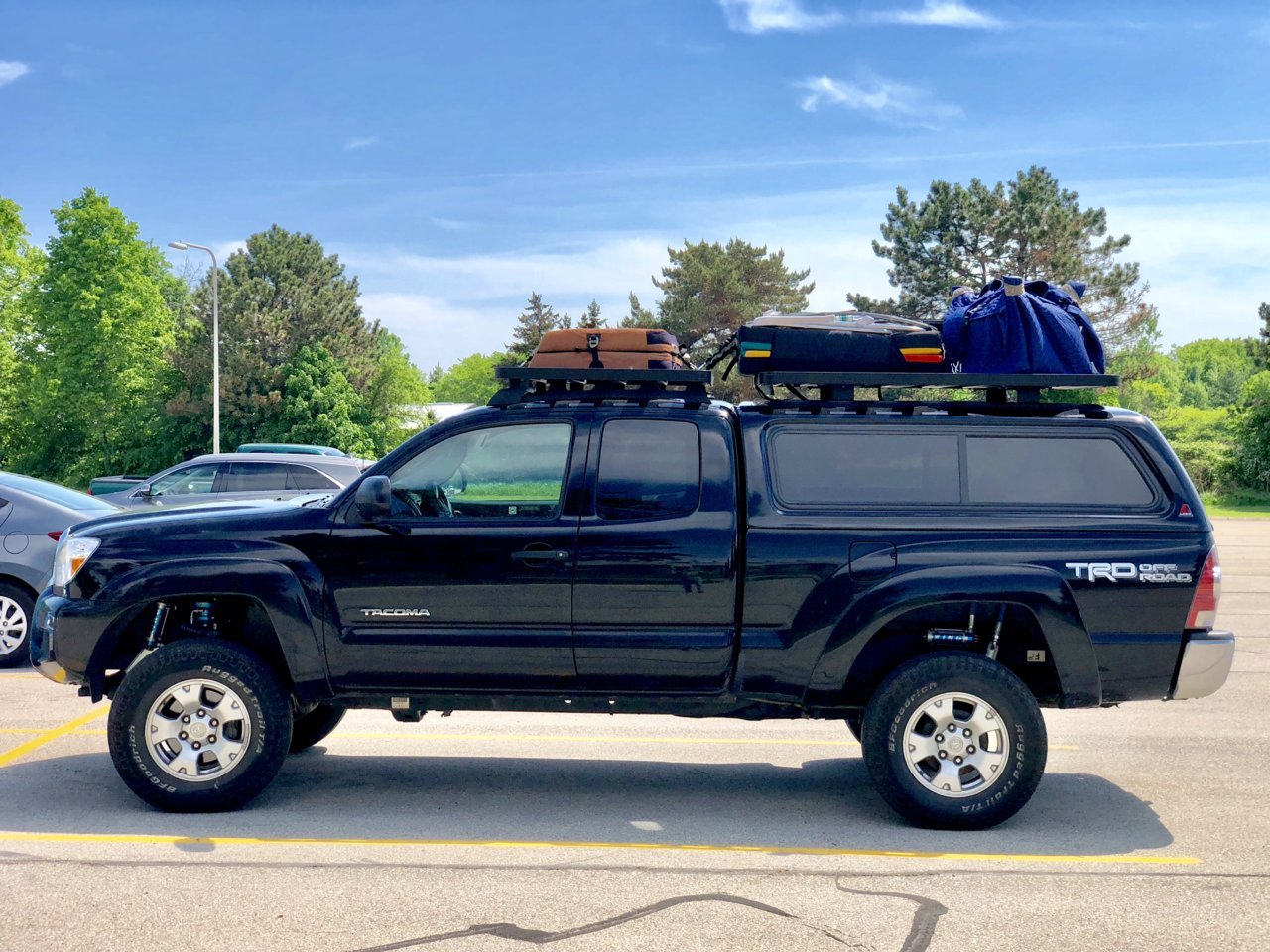

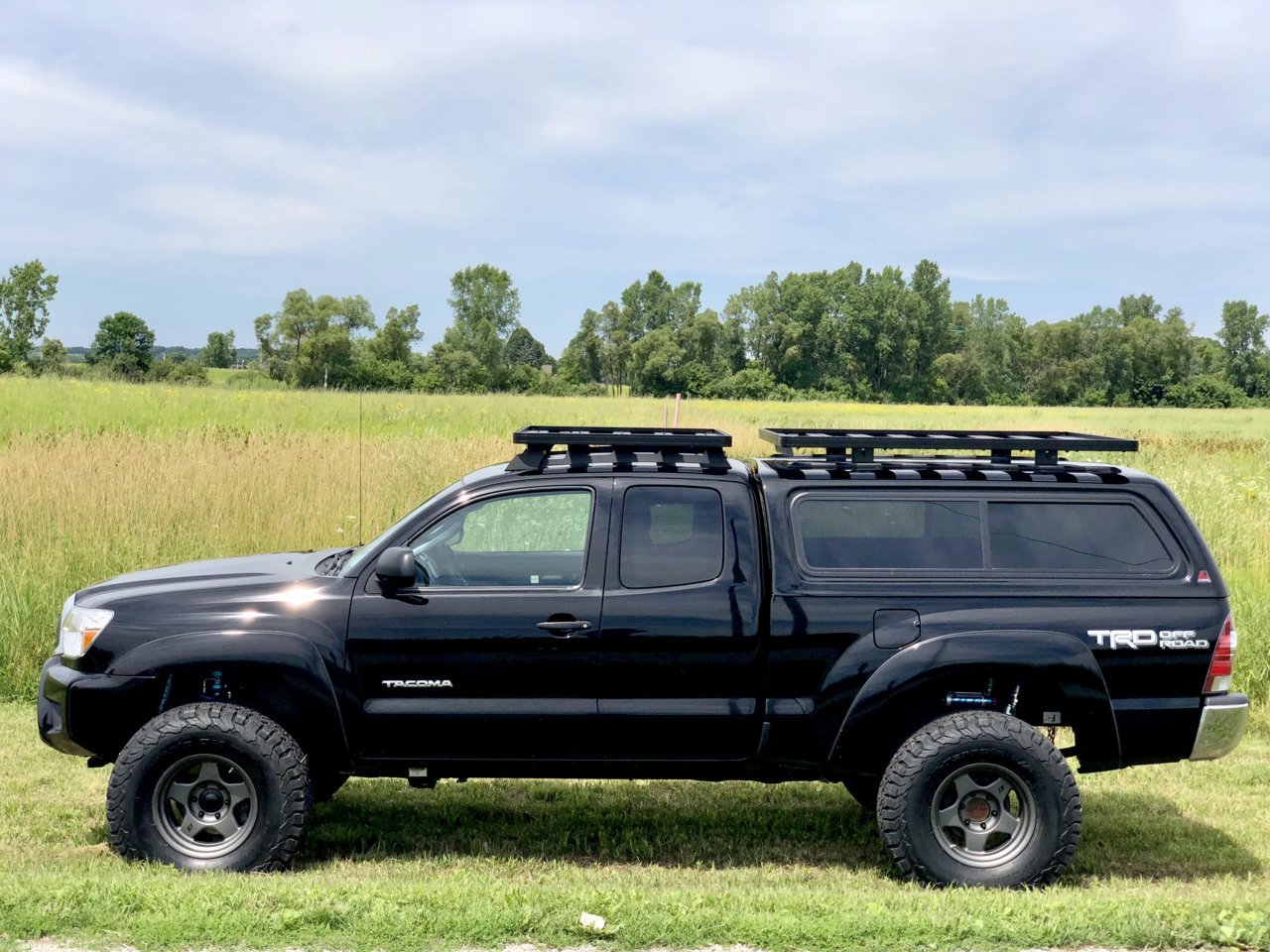

    From this:
    But to answer my own question... I did not chop my cab mount enough the first time...
    So I went from this:
    To this (to be boxed in the next few days...)
    BajaAsh, Bagman, llamasmurf and 15 others like this.

    I had to do the same with my 295s. It’s a great size though and I’d do it all again.

    Is it safe to drive around like that?

    Nope, everything u just mentioned I am having problems with. So nothing has changed! I guess I’ll have to do a little bit of trimming and fitting as well.

    Definitely not :eek::p

    They have a 2012-15 model but it's twice as much. Best to get the older one and trim to fit.
