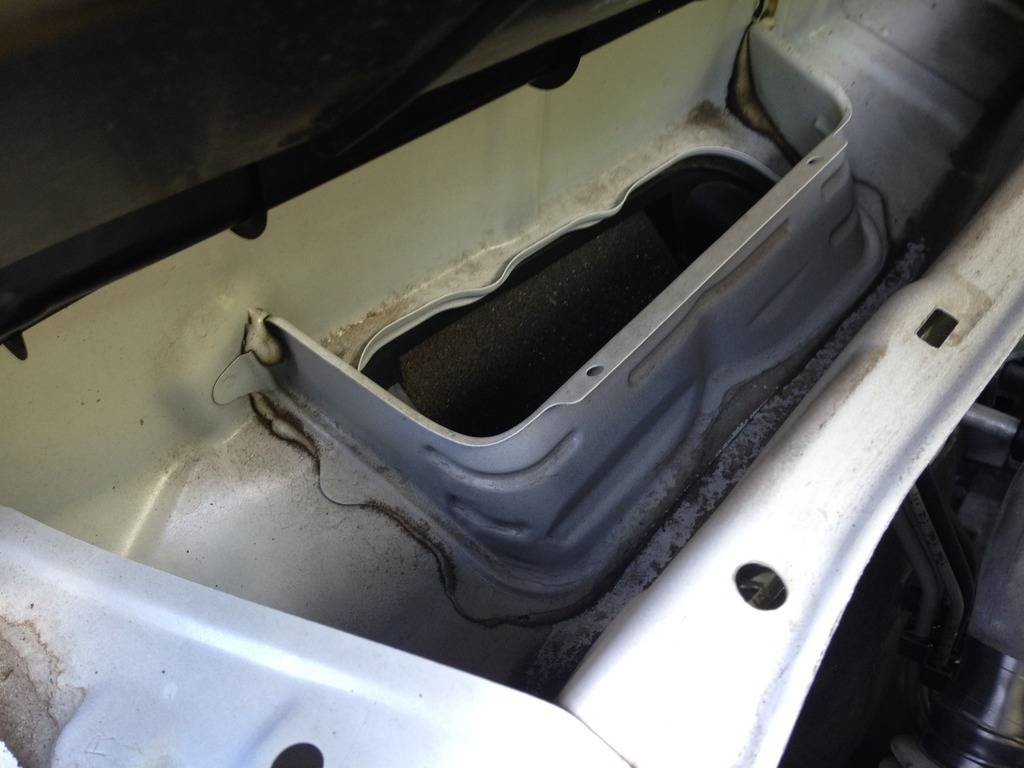

    Out if curiousity I opened up the area and it is both easy to access and looks not too difficult to pre filter.
    There's a clip with a Phillips button ,not an actual screw just pull it up then pull up the entire clip. Then pull back the hood gasket, it's just hooked on to the lip, and lift up the cover. 79412D3D-B6FC-46AD-BA28-19C305860810_zps_cd787fdc88e0d88917dabb1f71cc2599d77aaedb.jpg
    Underneath is the air box inlet. Could probably zip tie some 1/16 mesh over it.
    2964E37F-721B-4916-A586-E4814841C654_zps_8131c6abf9163bbc78934b0038168a29b00a2c04.jpg
    I haven't done it but I think to completely remove the cover for cleaning you would pull the wipers(1set screw each), then open the hood and pull the clips at either end of the gasket, remove the gasket, then just pull up on the cover to unsnap it.

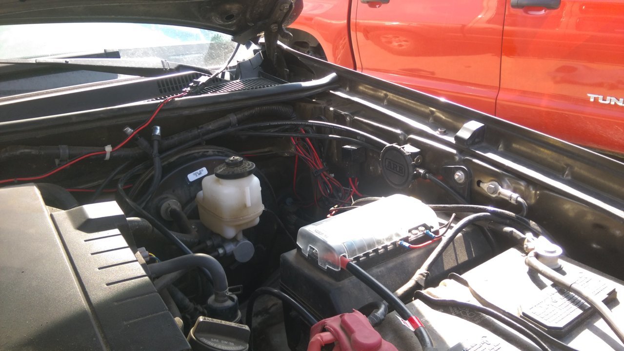

    This and that...
    Over the last few days...
    - Rear diff breather relocate to tail light
    - Installed the auxiliary fuse pannel and transferred all my accessories to it.
    - Oil change with Mobile 1 15,000 mile synthetic. Was on sale for $30 for 5 quarts at Orielly’s. (Will be checking as I approach 5,000 and so on.)
    - AEM air filter ($40 on Amazon)
    - Detailed inside and out, 303 on the seats and Softopper and trying out some waterproof seat covers I found on Amazon for $20 each.
    4D474A17-D17E-4112-AC47-46696C3CEB74.jpg 3BAE83FC-28C7-43AA-8FE4-1EF641973DFE.jpg

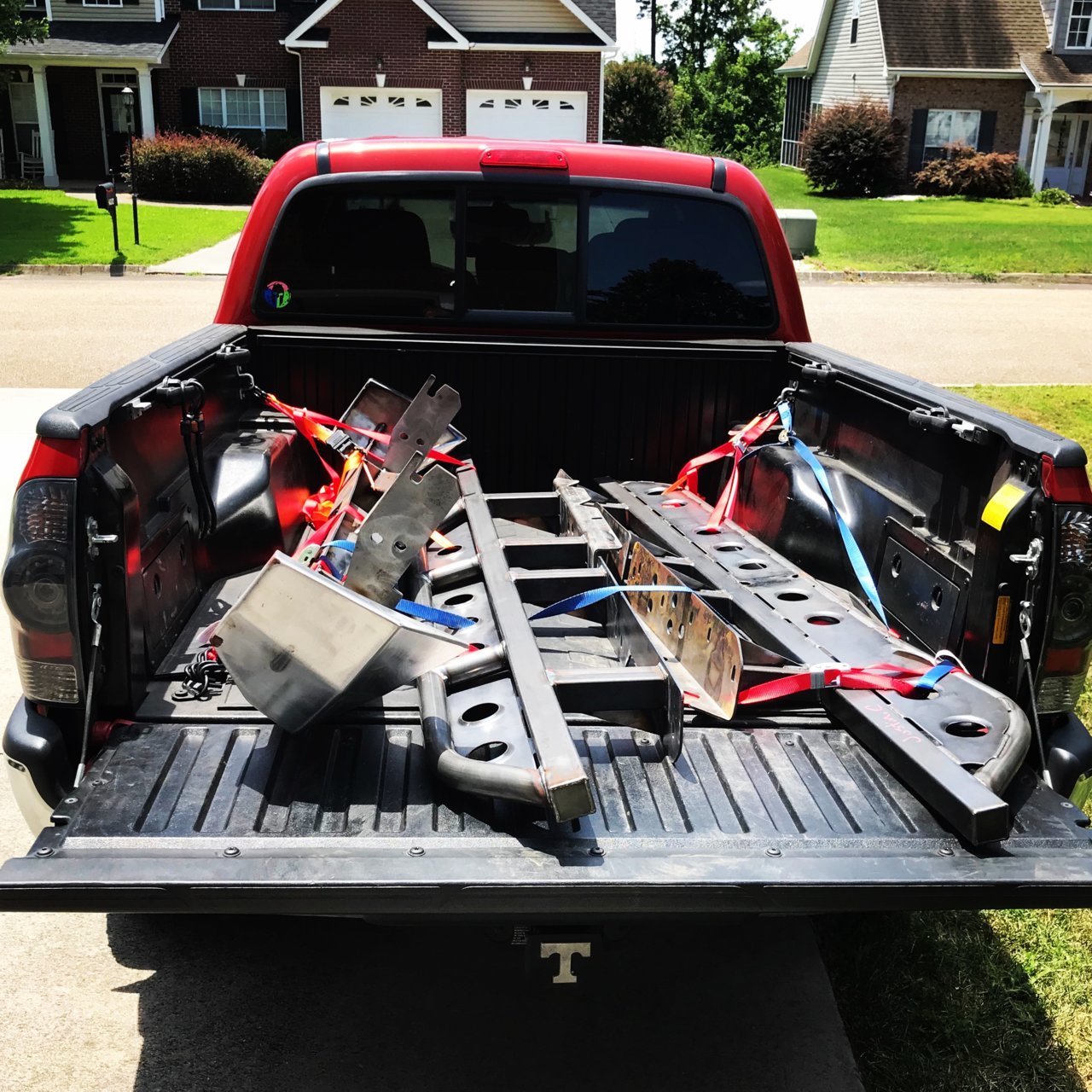

    9342EF8D-6EE5-422F-974F-037F1ACC806F.jpg 1A0E27DE-4F50-4007-8672-2328AA00B8B2.jpg Drove 420 miles round trip to pick up a rear bumper and sliders from SOS Concepts. Then my little guy wanted to help wash it.

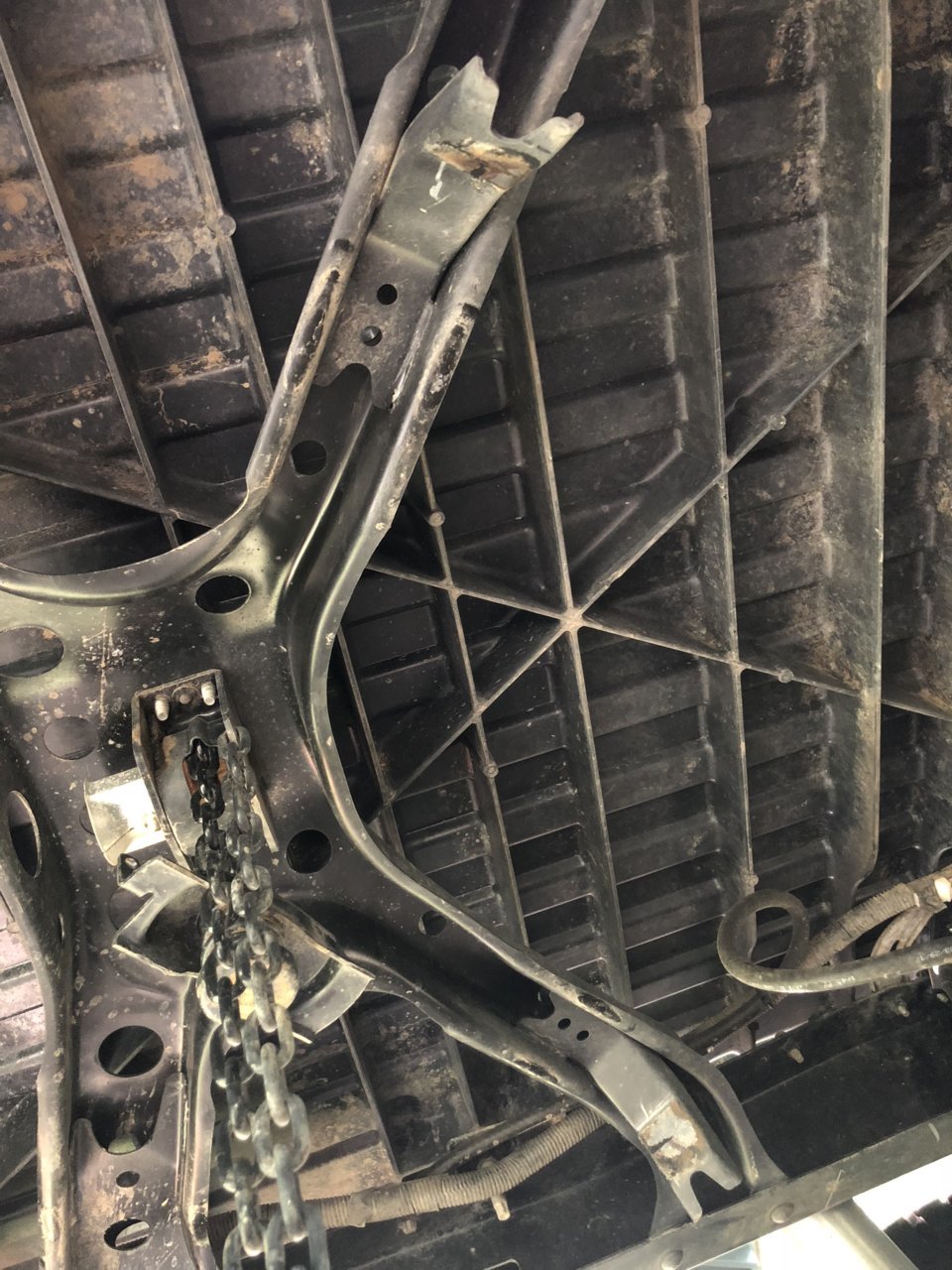

    Not my idea but bought this off a wrecked Taco it was still in great shape so I cleaned it up fish scaled it then used boderite on it to cut down on corrosion. Since I don't have a spare underneath I thought I would make use of the wasted space... The first part of this project I was like WTF am I doing :sawzall:? I have chopped up more than a perfect Toyota or two so oh well hope the bed doesn't crack:popcorn:. Still need to finish mounting it and get the wire harness mounted back.

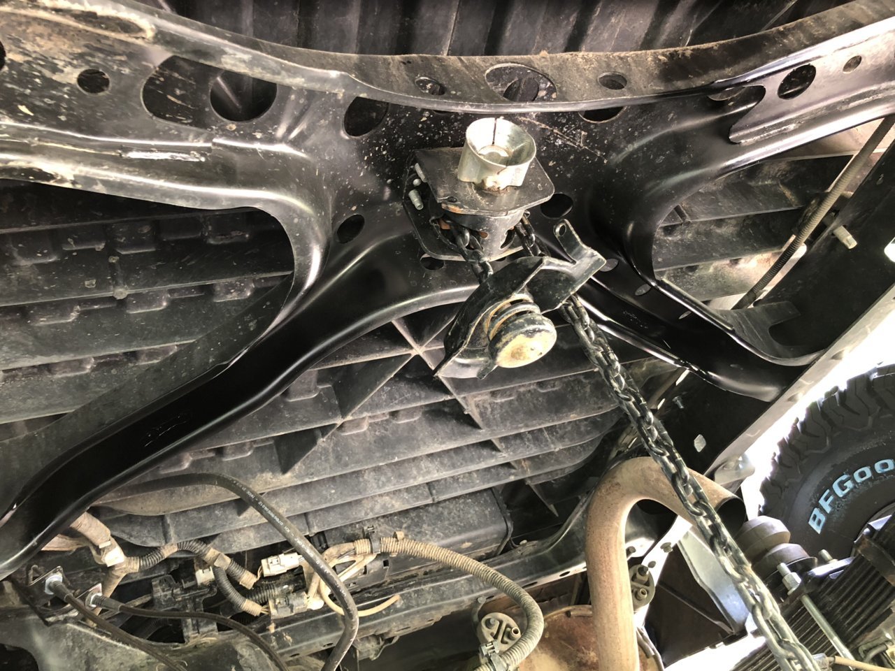

    Stop gap fix while I impatiently await my @Pelfreybilt second gen high clearance dual swing out rear bumper! My 295/75/16 spare barely fits under there with the ears trimmed off.
