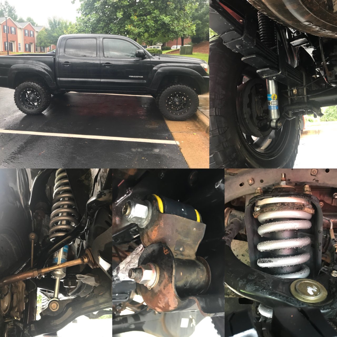

    Picked up the truck from the shop today. 5100s on all 4 corners, toytec ebaich coils. And 4x4 OME dakars on a prerunner :)

    Looks good! Hope you don't plan on doing too much hard riding on those Eibachs. Broke both coils on mine and replaced them with OME

    I won’t Be jumping any ramps or anything too extreme, but I do hope to use it on some trails. Fingers crossed they work out.

    Just know that whoever installs the dakars is going to have to mod your shackles, hopefully they will know how to do it.

    Is this with all Dakars ? Because I plan on getting leaf springs that will allow me to not use blocks when I lift, my budget is hard to come by and need to know all that's involved because it's also my daily and can't have it sittin waiting on parts or some special mod, thx for your time and efforts

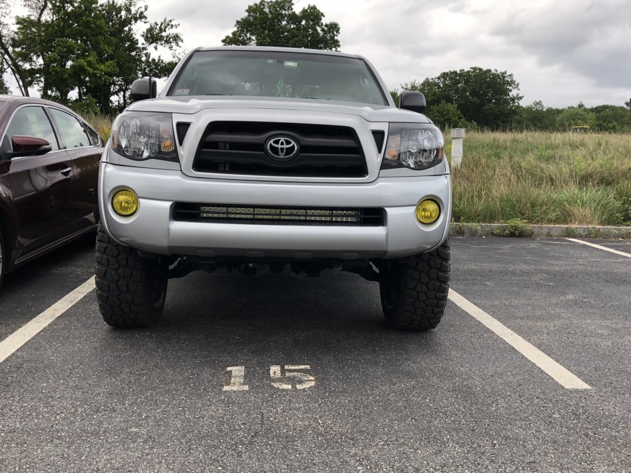

    Had the holes in the front bumper from the license plate filled and whole bumper sprayed.

    OME does not make dakars for 2wd models. The fabbing shouldn’t be too bad, it only costed me $40 or so bucks more. The guy had to drill out of of the stationary bolts and put in a bigger bolt through the Dakar bushing. Hard to explain in text and hard to see on the truck unless you knew.

    That doesn't seem to bad, is there any write ups on this?

    I couldn’t find any. I wish I could make one, but I don’t have any progress pictures to help explain.
