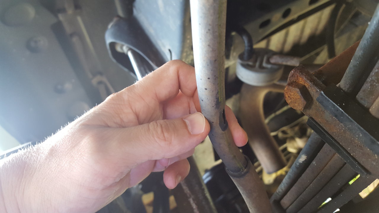

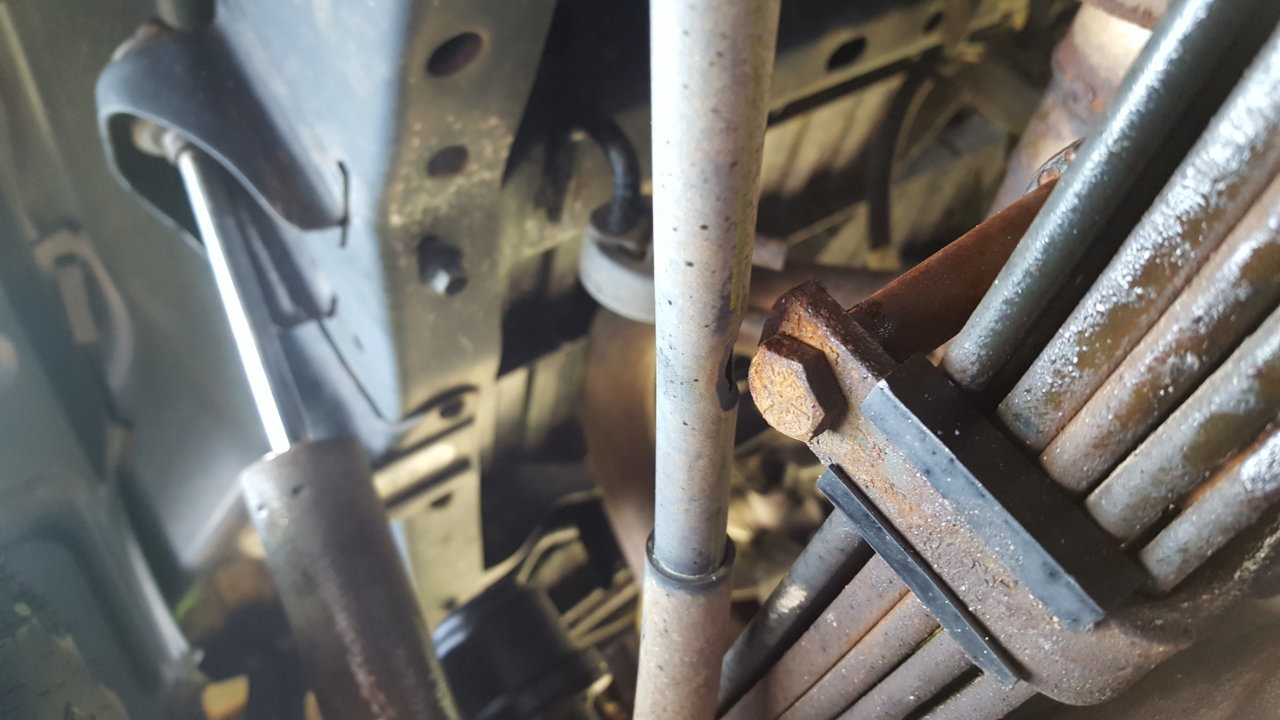

    Dayum. Was under the truck spraying some fluid film and noticed my ebrake cables on both sides are rubbing against my dakars. Thinking about wrapping that part with a padding of duct tape, but does anyone have a more eloquent solution?

    Chunk of an old radiator hose, or more protection abrasive resistant sleeves like what's on some wiring harnesses.

    Slightly larger rubber fuel hose?

    A bunch of eloquently placed zip ties

    cut across a pvc pipe (removing 1/2 to 1/3) and slip it over the line, then tie wrap in place.

    A well placed large spring will do the trick to pull the line away from the leaf spring. And, as previously noted, a rubber hose that does quite fit all the way around the cable will serve as protection as well.

    That might be on par with duct tape on the eloquency scale.
