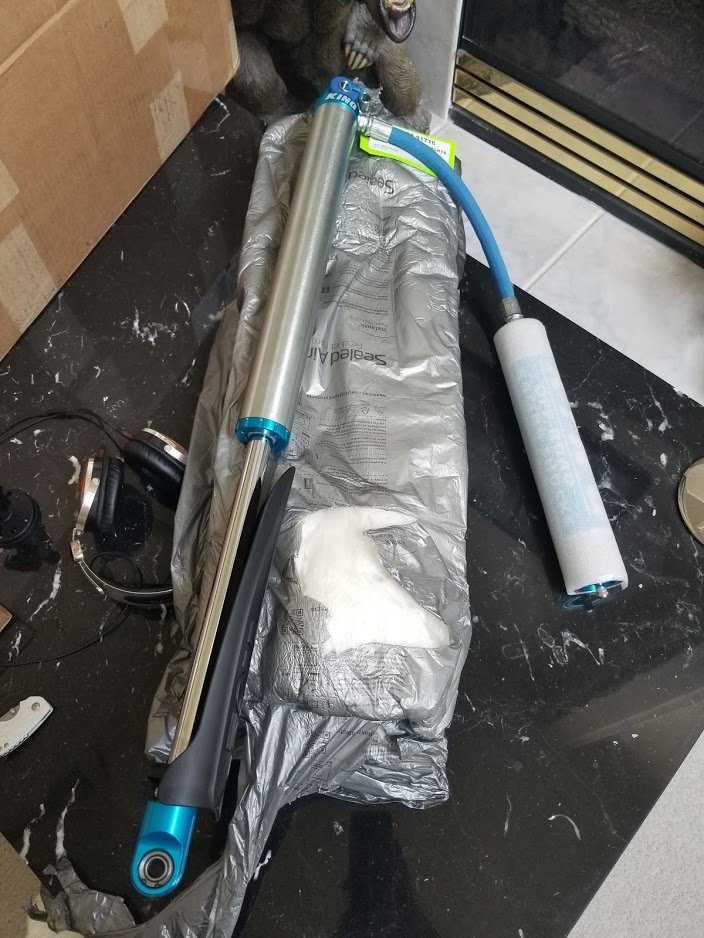

    Think its necessary for the fronts or just the rears?

    Fronts not required for a "drop in" setup like we have/will have.
    But I figured if I am doing the rears (highly recommended), may as well get the fronts done at the same time. Really stiffens up our brakes, and adds to the "vanity" aspect as well. You're dropping like 3K on suspension, don't cheap out on $58 in brake lines.

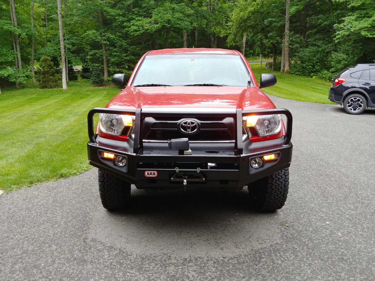

    I absolutely love the look of my ARB. Sure its bigger and heavier than most other bars out there, but I think its worth it. Also, its worth noting that the bar for our trucks (years 2012-'15) (ARB P/N = 3423140) requires cutting and reinstalling the top maybe 3-4 inches of the stock plastic bumper piece. So given your scenario, make sure theres no damage to the top few inches of that plastic before you pull the trigger on the ARB. Dont have a great photo of it right off, but this one should give you a good idea. I stripped the paint off mine so it would match.
    Also, if you do go for it, hit up @eccracer104 and the AutoAnything group buy thread. He can probably hook you up :thumbsup:

    My thoughts exactly. Last thing I want is to snap a line the first time I test out the articulation:rofl:

    Yeah, that would be just my luck. The problem I ran into is when I went to go get an alignment, my LCA cam tab bolts have partially seized. Super common on tacomas, so while you are under there, maybe undo them and slather then in anti-seize.

    How much minus the winch and shipping weight does the bumper weigh? I'm currently contemplating selling my FJC with a warrior products bumper (weighs around 95 lbs without winch) and buying another Tacoma. Going with ARB for the new build with OME heavies.

    I think it was about 150 lbs before winch. Bill of lading listed the skid as 250 something lbs which seemed a bit excessive..

    I was wondering if the top piece of the cover was really needed. Not sure yet if mine is still good.

    Same. I think that gap is too big without it tho..

    I've seen 150 quoted in a few places. ~225-250 all in with a winch, etc.
