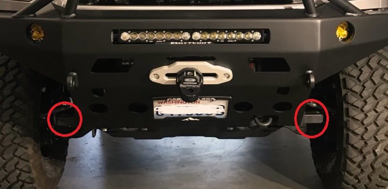

    I kept mine incase I wanna put lights down there... But then again that's one more thing to bang up on trails

    There's a single bolt under each one that allows you to remove those frame extensions. If you decide to put them back, just insert and re-bolt. One less thing to HANG up on the trail.

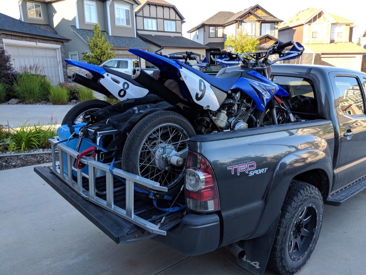

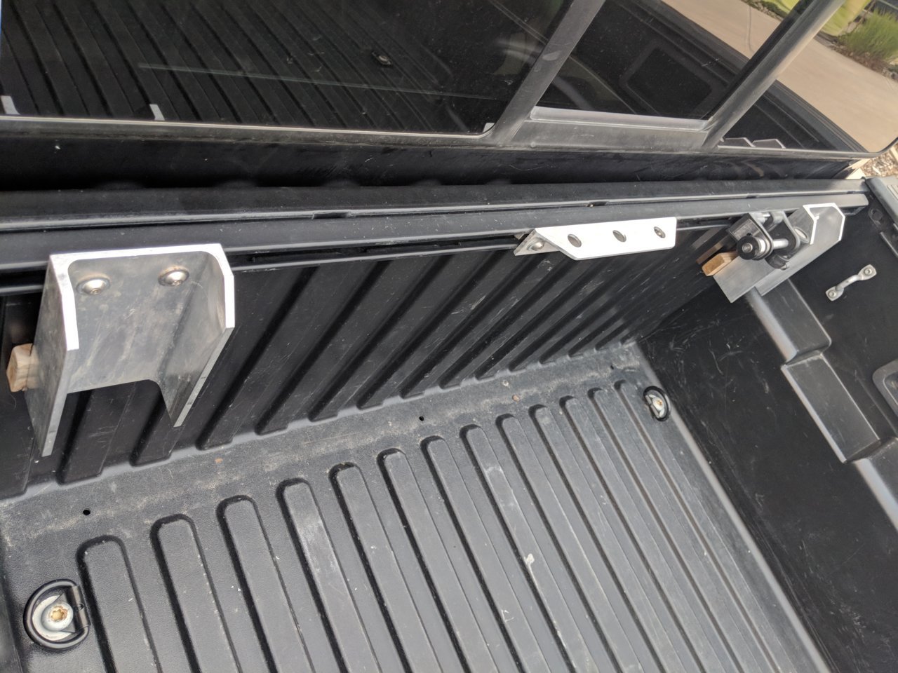

    Wheel chocks and centre tie down for the motorcycles.MVIMG_20180808_201423.jpg IMG_20180722_192121.jpg

    I would suggest not using the bed rails as a tie down point (for a dirt bike it might be fine). They are not meant to take a vertical load and could easily break with too much force. They're really only meant to take a horizontal load. I purchased the following, which replaces the stock rail at the back and also ties into the side rails.

    The setup works fine for these small bikes. But I agree, I wouldn't trust the centre tie down on my 500 lb street bikes. That's what the d-rings on the bed bolts are for.

    the wheel chocks are sweet! where did you get those from?

    4" Aluminum channel from the scrap bin at Metal Super Market. The aluminum cuts easy on a chop saw with an old wood blade. Centre piece is 1.5"x1.5"x1/4" aluminum angle. I used 1/4"x3/4" aluminum flat bar (drilled and tapped) for the anchors. This is a very cheap and functional setup for these small bikes but I don't think I'd trust the centre tie-down with a full size street bike.

    Did the bed rail fail or did the tie-downs get slack and fall off?

    Bedrail/clamps failed and he didn't put any straps on the rear at all, just two at the front on the stupid clamps/cleats (whatever they're called) that they included with the truck. So it was totally his fault IMO.

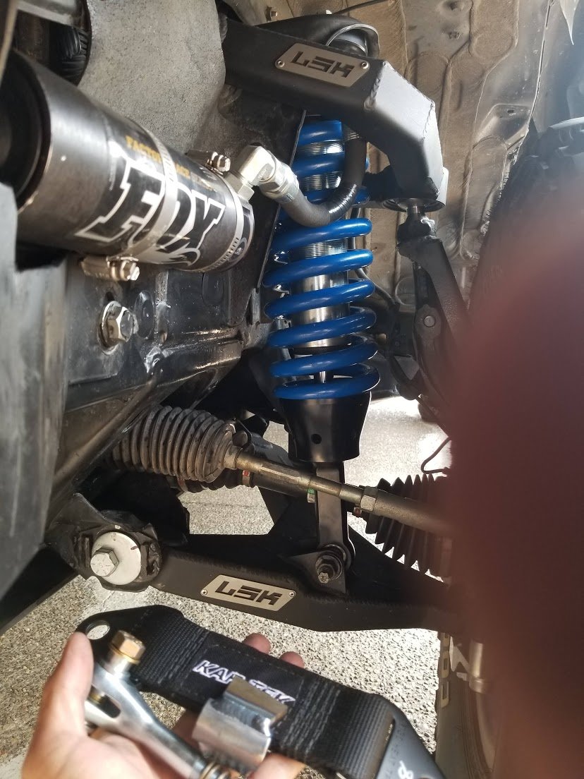

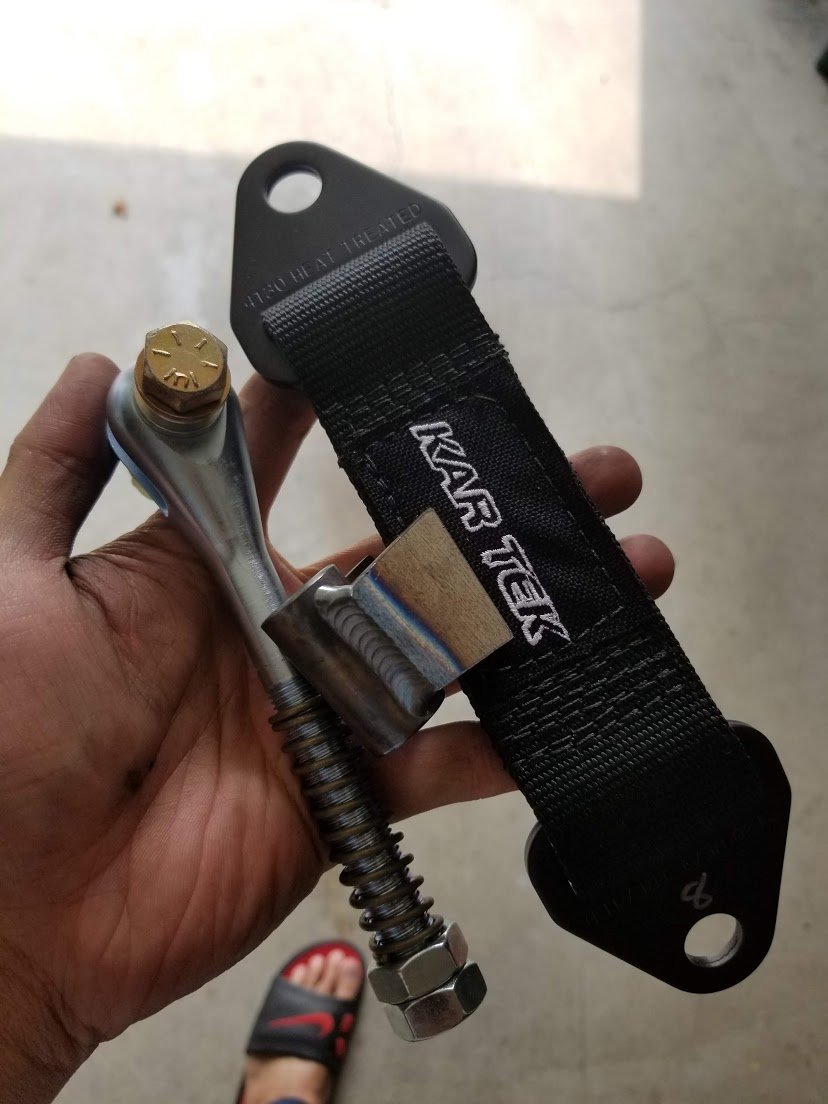

    kartek limiting kit came in
    bKemxDV1CSEmtSlQB-RvwnhmMbaXTW_aFOgCexFM_504bc3722bb8f4b3a15f958662cf2719d1755085.jpgslvXv14O-DUy559xDOPYNiIfYgTXOdcuSTtmsOer_9159702efcb796225d3411ad33fd84b2e4ad11d3.jpg
