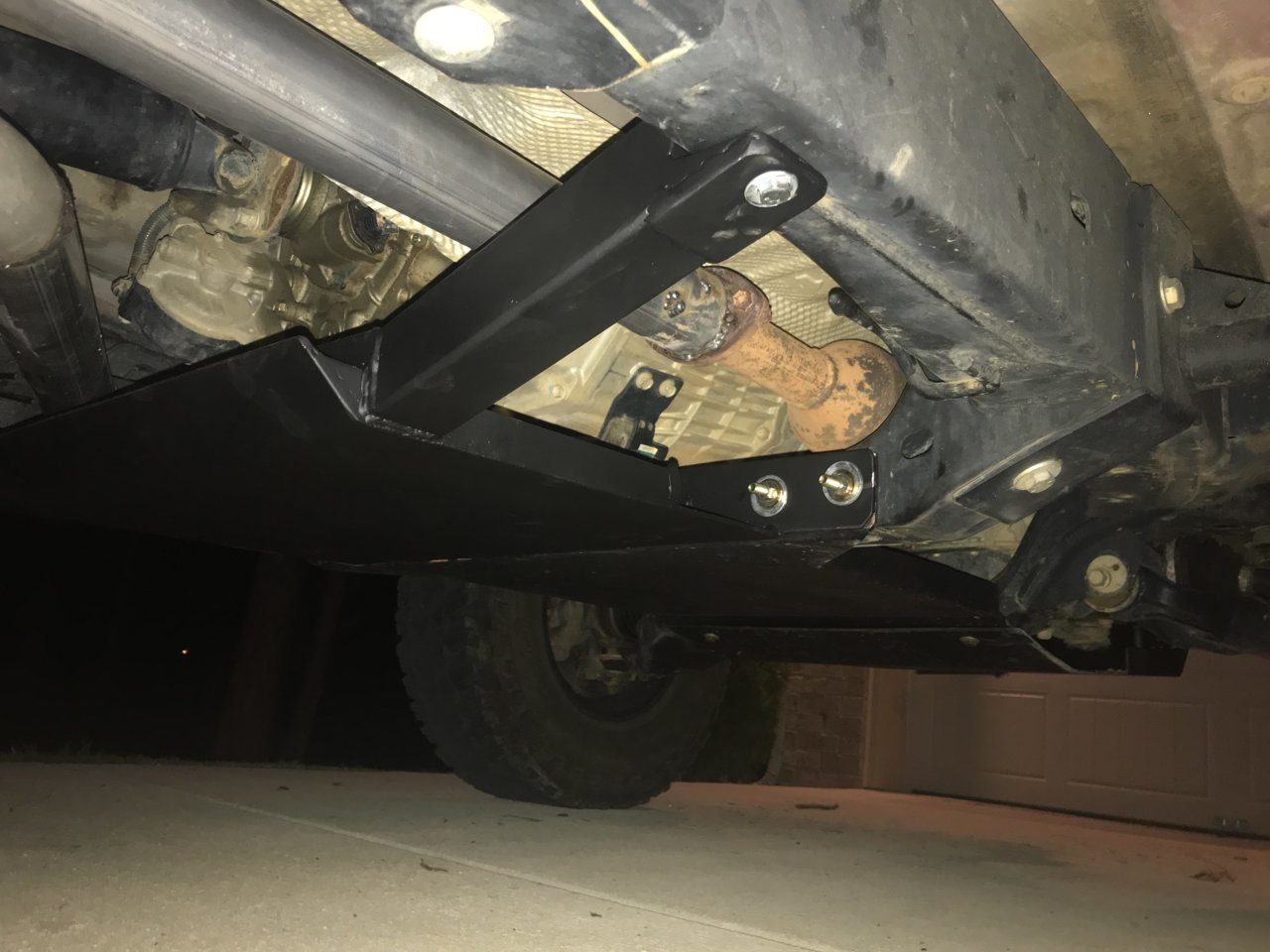

    Home made skids are installed. Finally done with this project. On to the next.

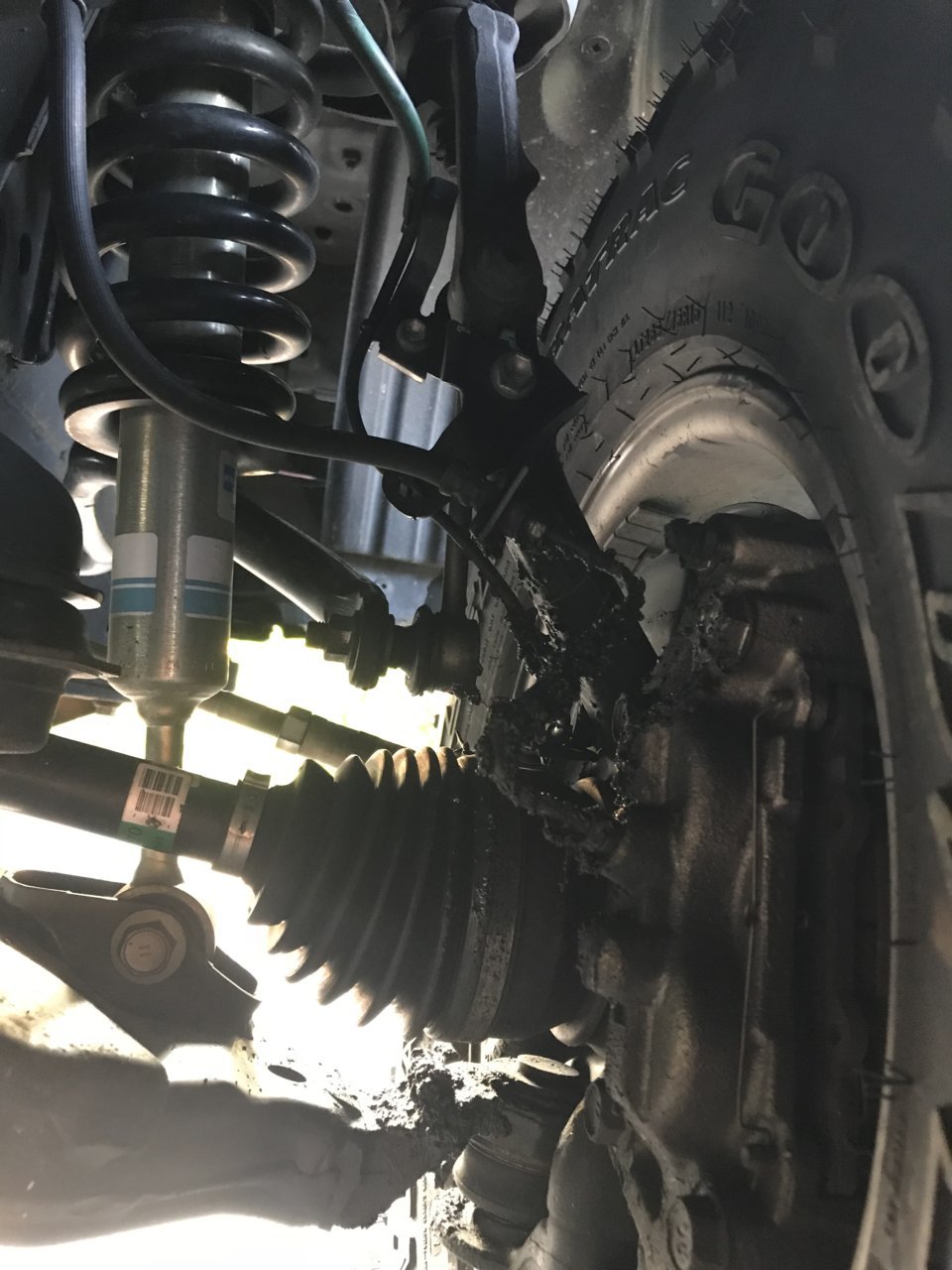

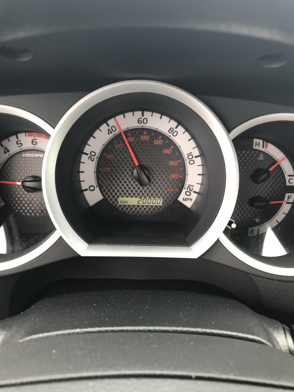

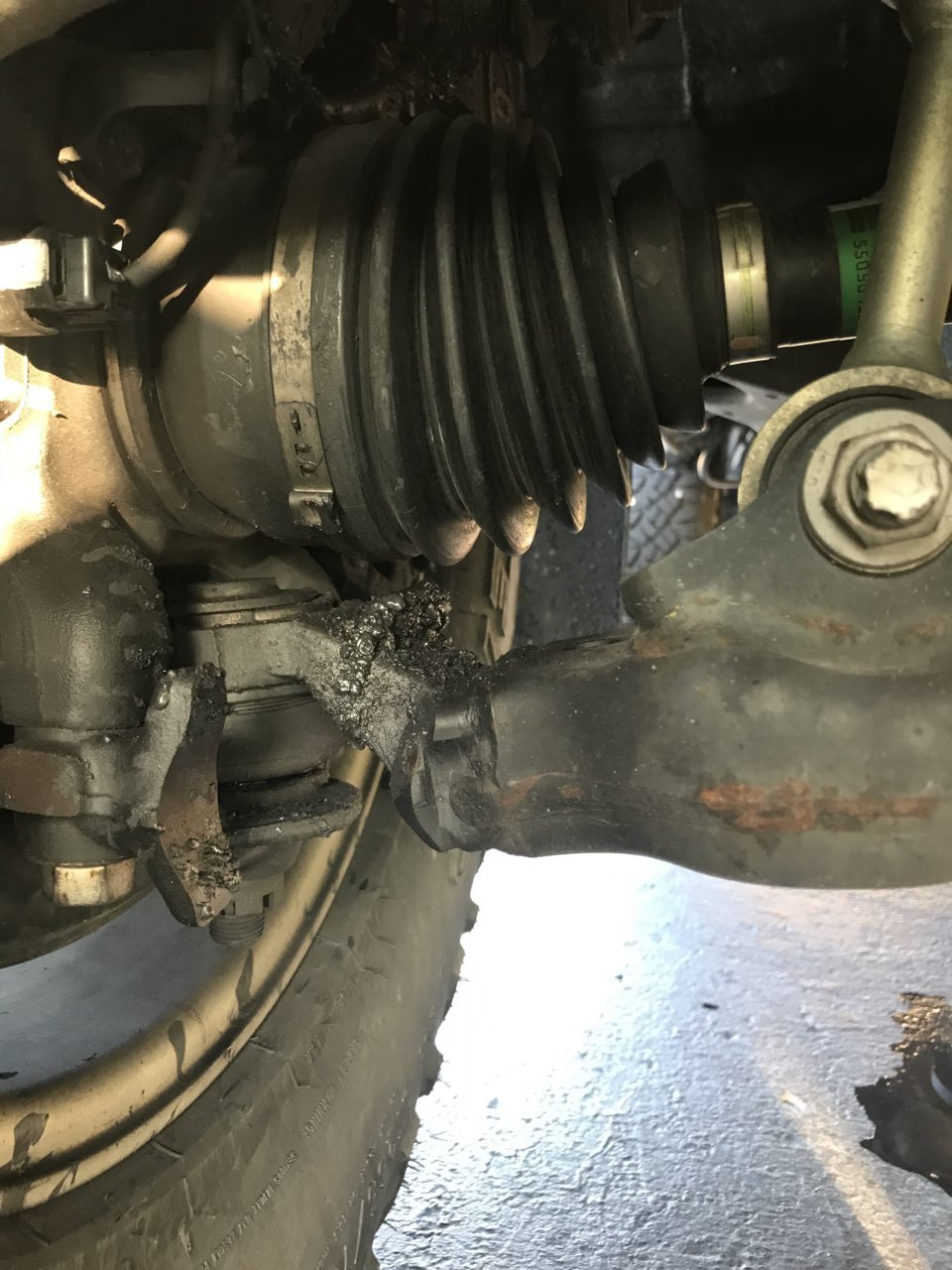

    It rolled over 20,000 miles yesterday. Today I changed my front/rear diff, transfer case and transmission oils using Redline 75w90 and MT 90. I also changed the cabin filter and air filter and topped off the window washer fluid. Then I washed it. I also discovered gunk all over my inner wheel, and CV shaft area when I was under there. I can’t figure out where it’s coming from. The CV boots are fine. I’m thinking it might be the remains of an animal since a couple weeks ago i kept smelling something dead, IDK. I cleaned it off so I’ll just wait to see if it comes back.37C1A895-32F1-4DB2-B2F1-0F7F79323346.jpg69036CAB-83FC-4D68-BE86-50E2BAF9F8A7.jpg B002F0FD-6EEE-4210-A50F-FF4286A37D68.jpg

    I'm almost certain that's CV boot grease. Look reallllly closely at the boot. Even a pinhole would throw grease. Appears to be right on the outer edge somewhere

    Makes sense, thanks.
