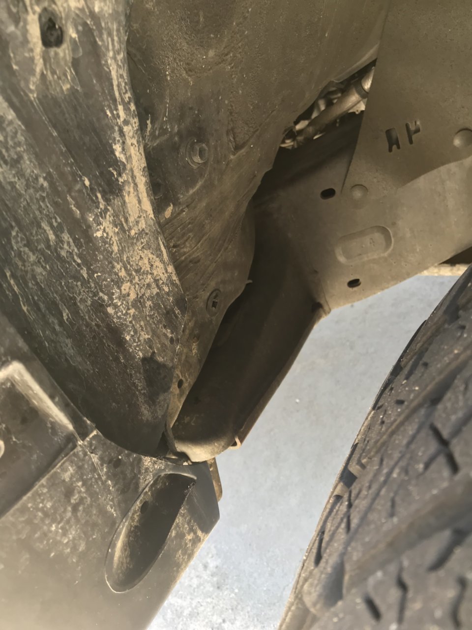

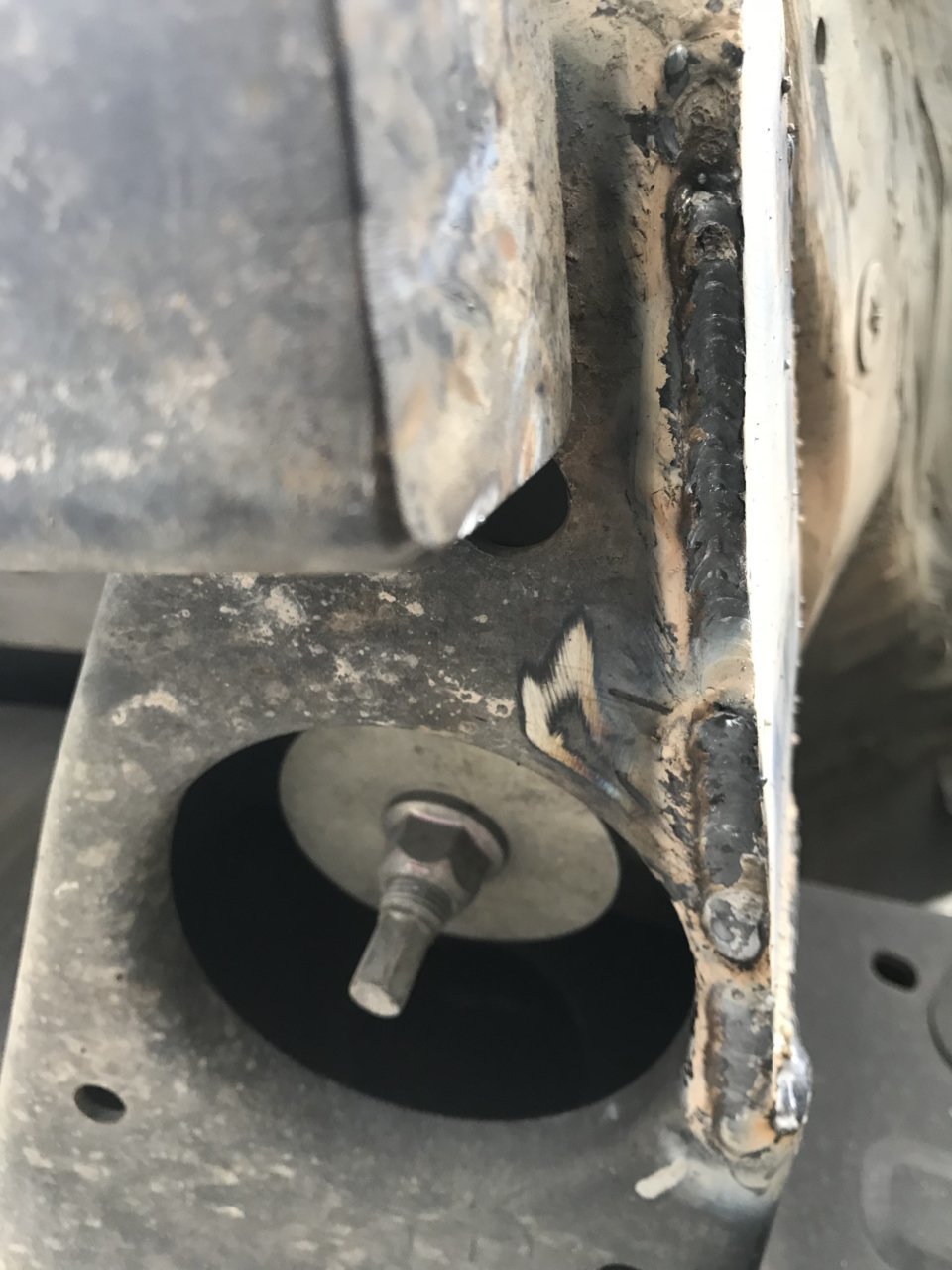

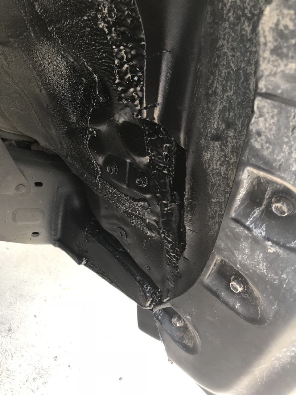

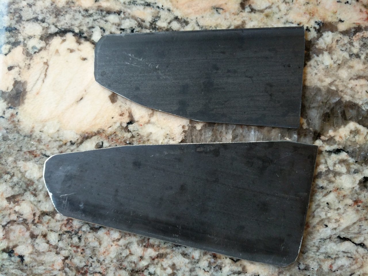

    Before16AF7816-D4EC-4A0F-9250-A10BDA595E01.jpg After...E6677B31-F550-4FCA-860E-B68DF1477655.jpg E25347A0-8F3A-4F82-B5E3-91731ABBA0AB.jpg So I added the relentless fab CMC plates this weekend. Haven’t welded in over ten years but it’s a start!!! I sprayed everything down with undercoating even the pinch welds I banged back. I know I’m not the greatest welder, but IDGAF, it’s my truck and I’m happy with it.

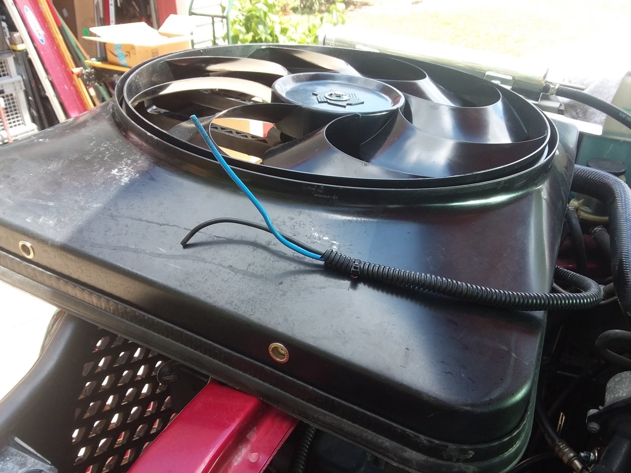

    Modified a little bit, did the mechanical install for a Flex-a-Lite electric fan replacement to replace a failing clutch fan. Wiring it up tomorrow, thanks to help I got on this forum!20180825_125148.jpg

    Nice....does it have a thermostatic control?

    It does - and that (other than it being 103 in the driveway) is what slowed me down today. But, I was planning on 2 days anyway. The controller wants power, and an always on connection to run the fan in cool down when you turn off, AND, a fan clutch switch connection. Which was easier said that done. But, I got advise on how to get it at the fuse block - of course removed. I will be posting pictures. I'm using the Flex-a-Lite Controller.

    I’d like to see more pictures.
    I had flexilites on a 2002 f150 the controller failed on me, it fried. Hope technology has gotten better.

    I do take step by step pix - because it gives me a break time! I will post back to this thread with all. I have not been great at adding pictures, so it may end up an album - but I will link. The controller is electromagnetic (relay - thermostat - hardwire thermocouple). I do NOT do offroad (other than the beach or a field), so my comments probably won't apply to the heavy duty users - but I fully expect it to function properly when well installed. (Solid joints, shrink, etc).

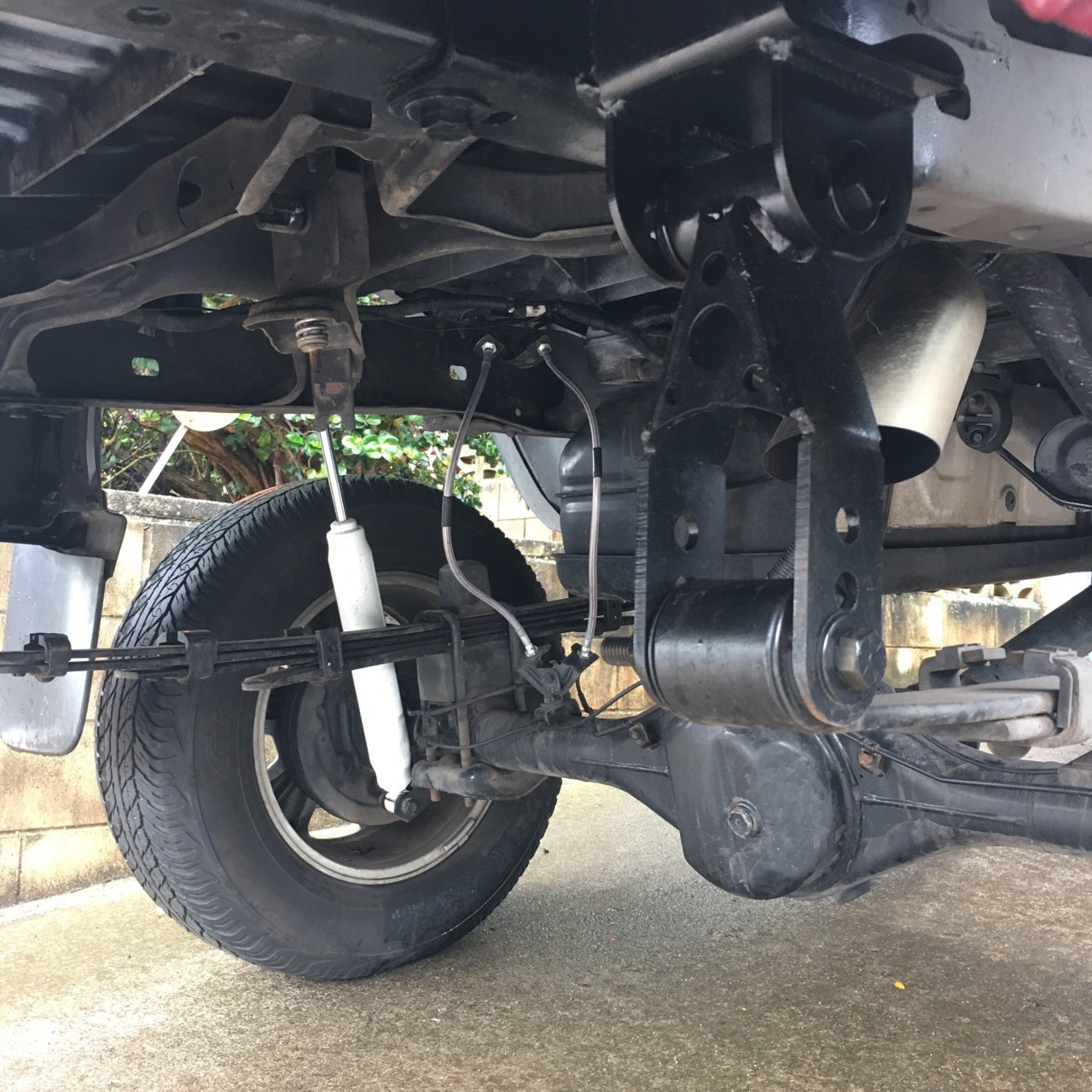

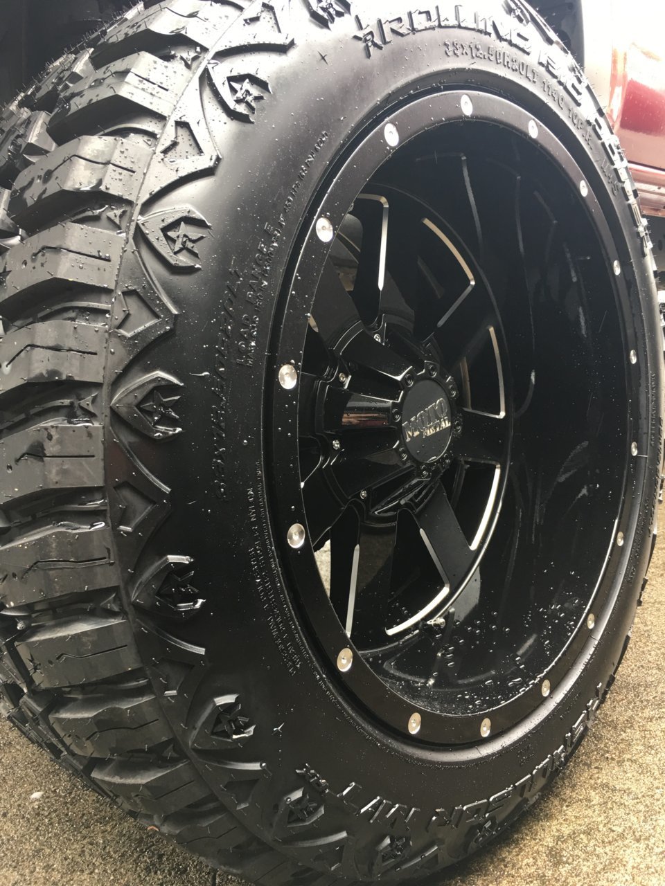

    Got some 20x12 moto metal with 33’s
    SPC upper control arms
    BDS basic rear shocks
    Rear Shackle flip kit with extended shackles
    SS rear brake lines

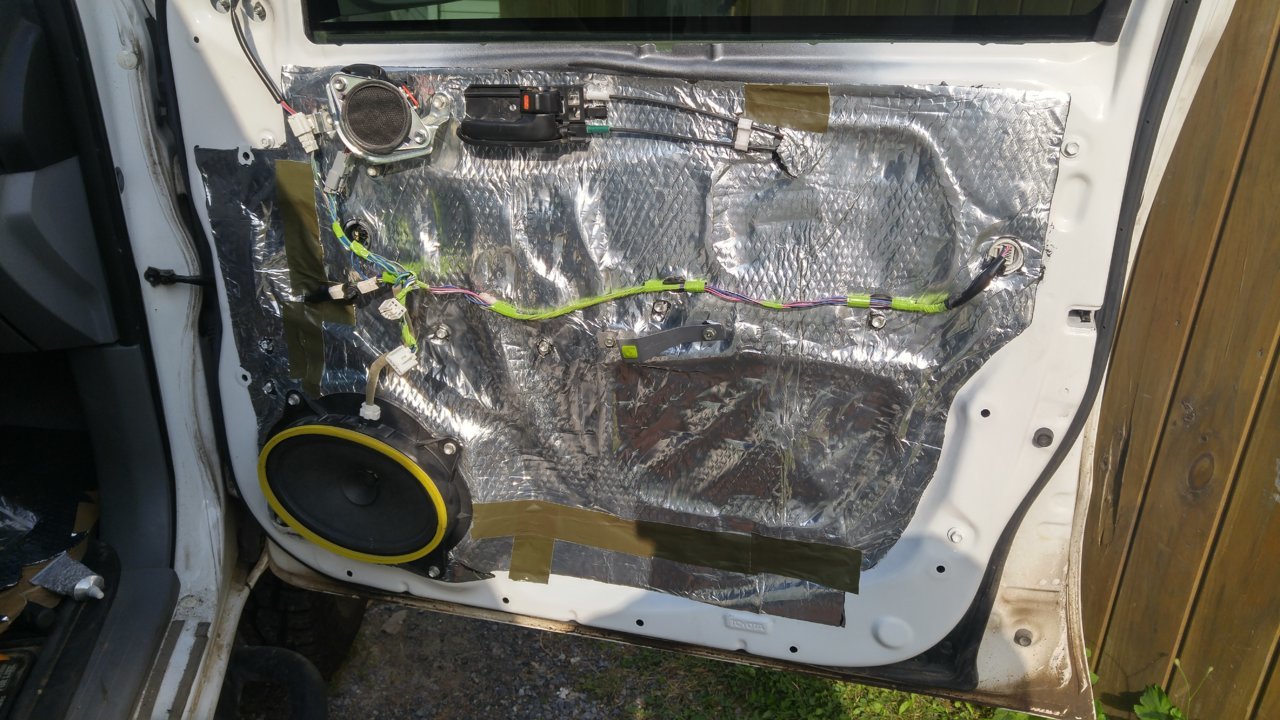

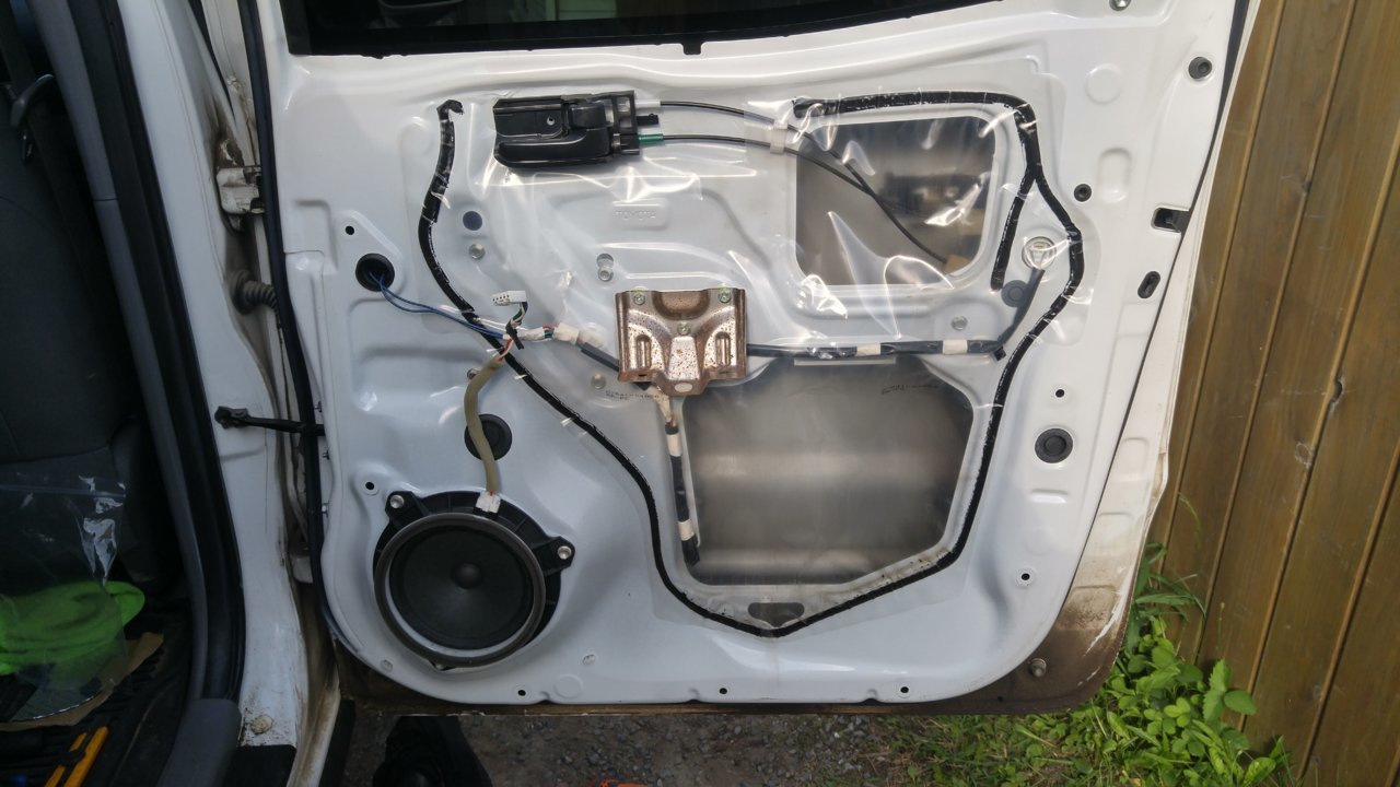

    Do the door skins man, like the most outer part of the door thru the inside. Makes a massive difference. I'm spraying some after I take my headliner out. If u gona do it do it all the way.

    That will be a job and a half now lol
    Can I get away with removing the door inner, in order to have access to the door skin?

    Holy axle wrap, Batman!
