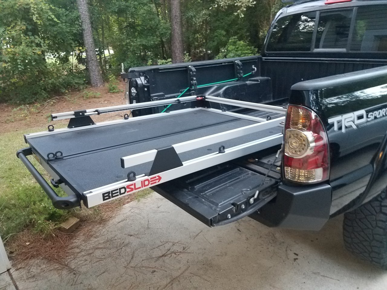

    Added a Bedslide. Still have to put the rack and rtt back on.

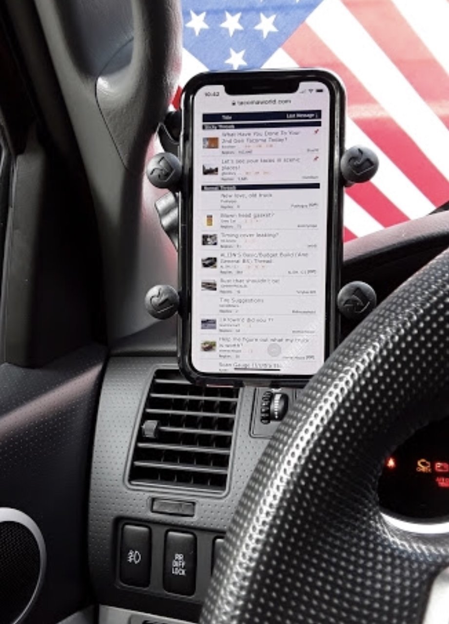

    *A-pillar Ram Mounts mod (hardware from motionridr8)

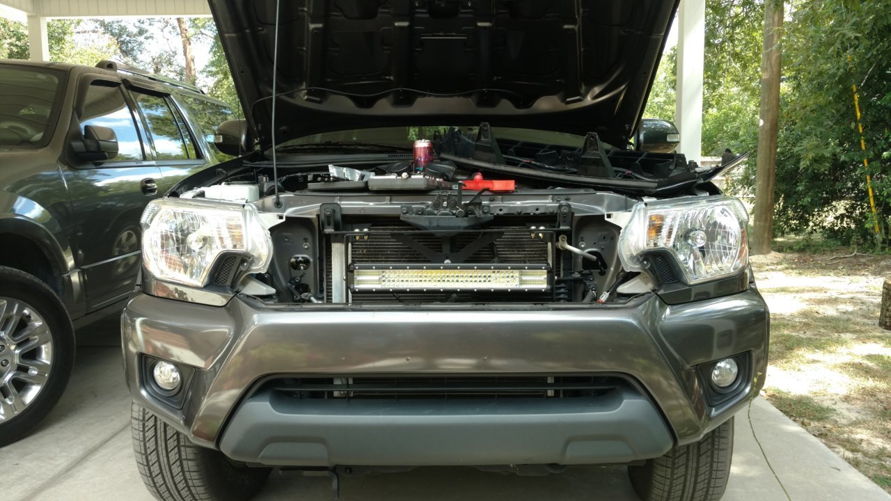

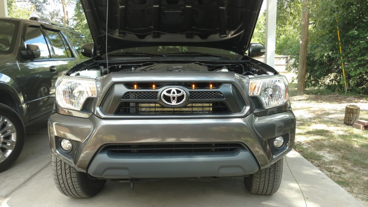

    My BAMF Behind the Grill Light Mount came in last week. So after changing the front pads and rotors on my wife's Expedition I got to finish my light bar install. Couldn't find any install instructions for the light bracket but it seemed pretty straight forward. It did interfere with my horns though and I ended up relocating them. Not sure if that's normal or not...

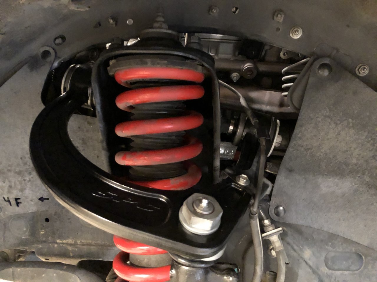

    Added SPC (Light Racing) UCAs for better alignment and extended travel while also slipping in HeadStrong 1/4” anti-lean top place spacers on both sides to my OEM Baja lift. Since my OEM lift already accommodates for the lean, I’m using them for a 1/2” bump up front to run a slightly larger 255/75/R17 KO2 in C-load (same diameter as 275s) without adding weight over my 265s.

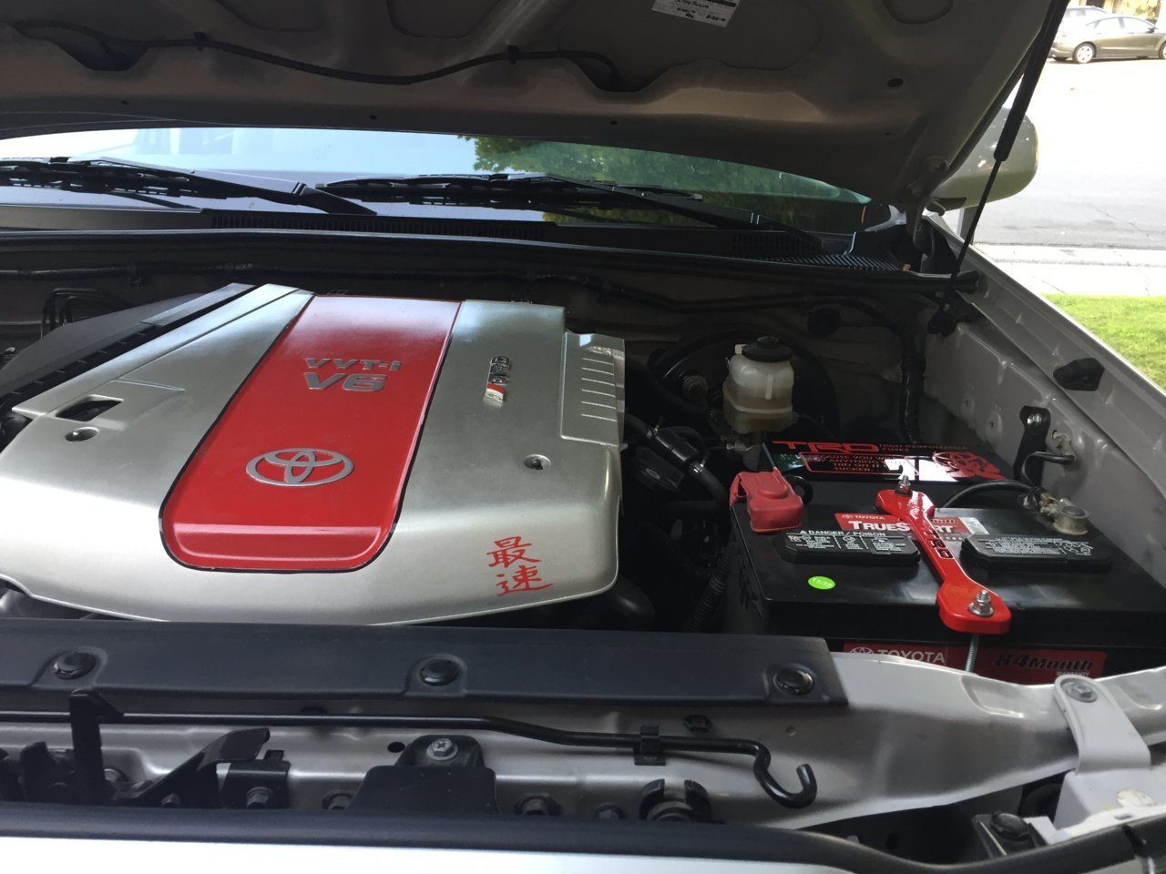

    Had Grandson install the new Battery Hold down and Fuse box cover. The fuse box cover sums it all up. He also washed and detailed Grandma's MinI Clubman. He and his 15 year old Twin Brother and Sister are now living with and he is a car nut. Wish I wouldn't have sold my Gen. 1 but at the time we didn't had no clue what was coming. I will start looking soon for Gen.1 for him to work on.
