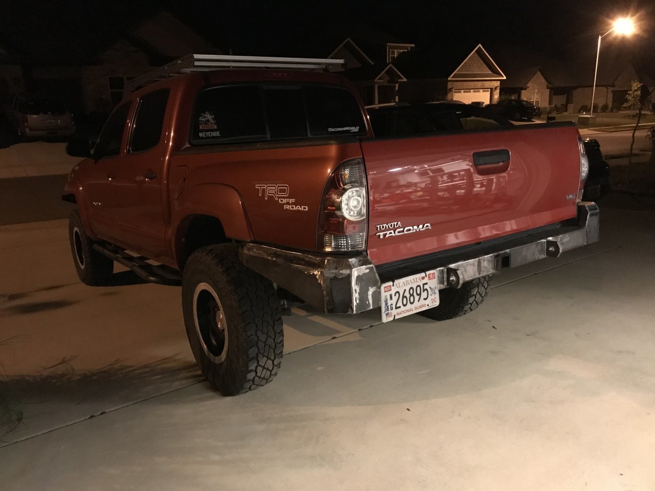

    I need to high clearance my high clearance bumper. Lol. No real issue, just not a fan of the boxy look. I trimmed up the sides a bit and am going to incorporate a bottom plate here soon that will sit at about a 30 degree angle.

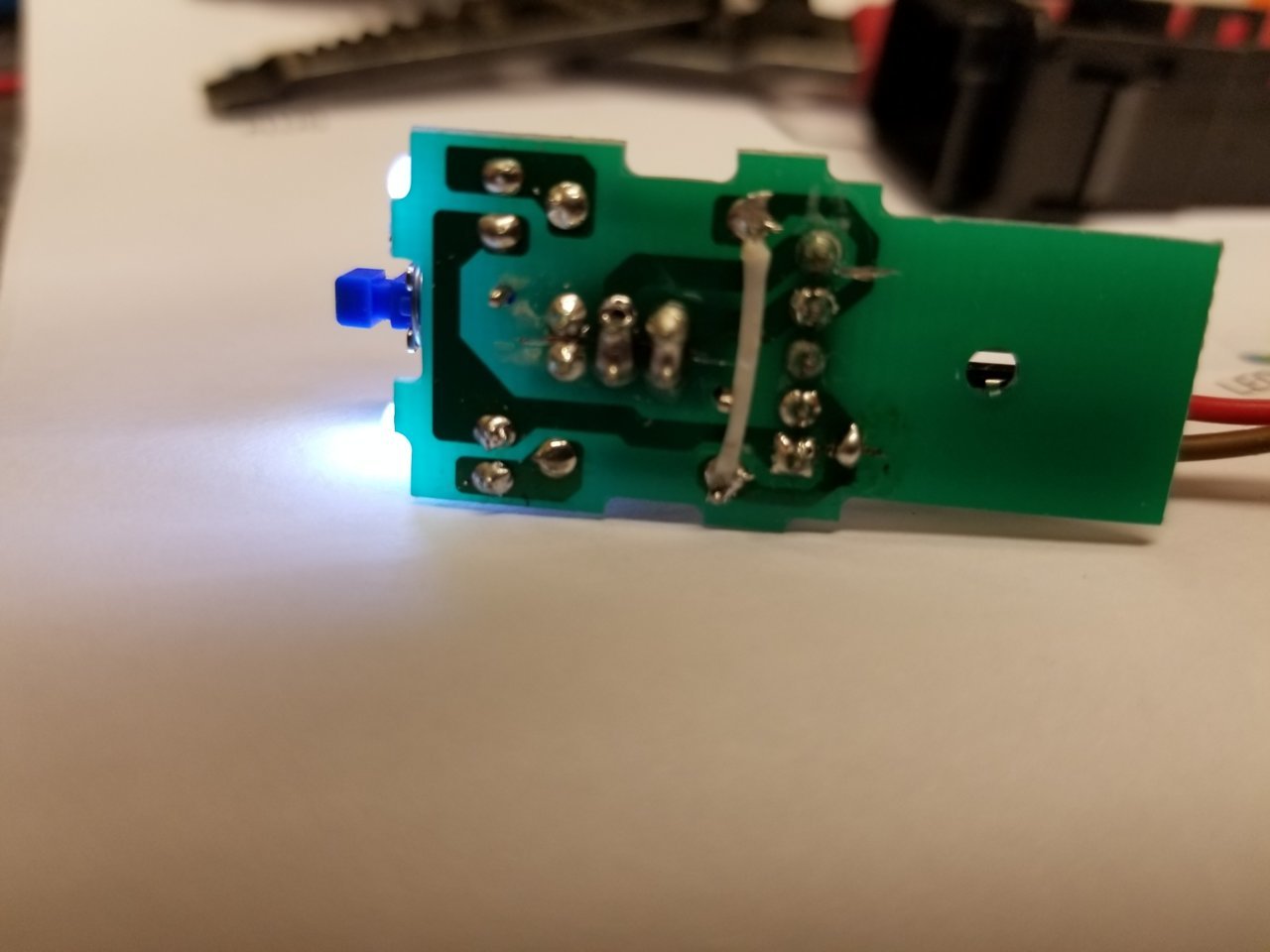

    just did the anytime rear camera mod this weekend... Modified the oem style pushbutton switch to white LEDs and both are lit when dash lights on. I modded the switch to send a ground signal out to the ground side of the relay. This really simplified the wiring... 1 wire to add a fuse, cut the signal wire and wired each side to the relay then had the wire from the switch. Pleased with how it turned out, although the relay click is audible, which might be due to tucking up near the dimmer switch. 2012 O/R and the connector was as described in previous posts. For those interested, I am attaching a photo of the modded switch. Cutthrough the 12v (+) trace to the 2nd (on) LED and ran a jumper wire. The switch LEDs are now fully on the illumination circuit and dim properly. The other two pins have a ground in and out which activates the relay.

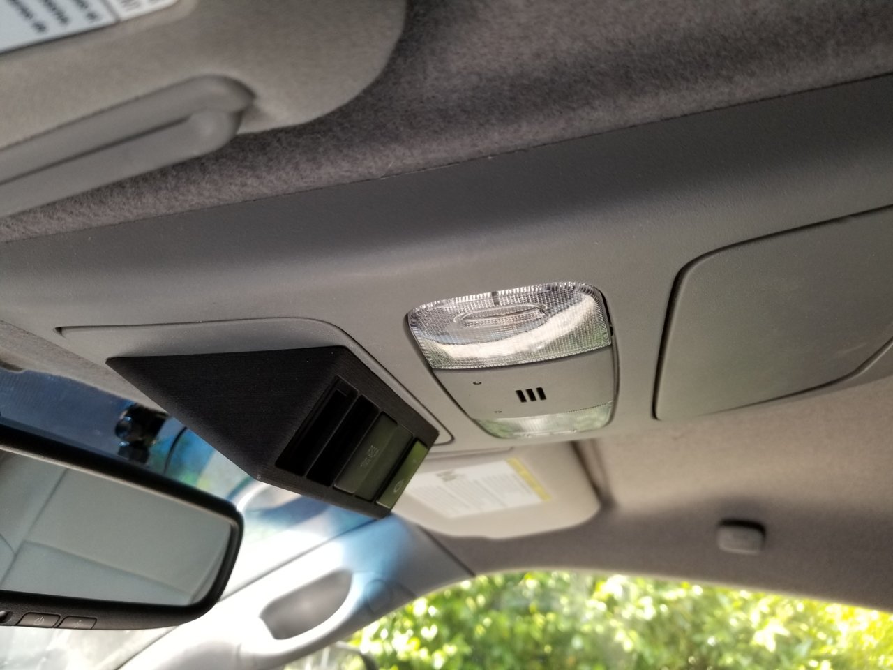

    I also relocated the RSCA, vsc and A-trac switches to an overhead switch panel (cutting, soldering and running new wire bundles up the a pillar). Busy weekend!
