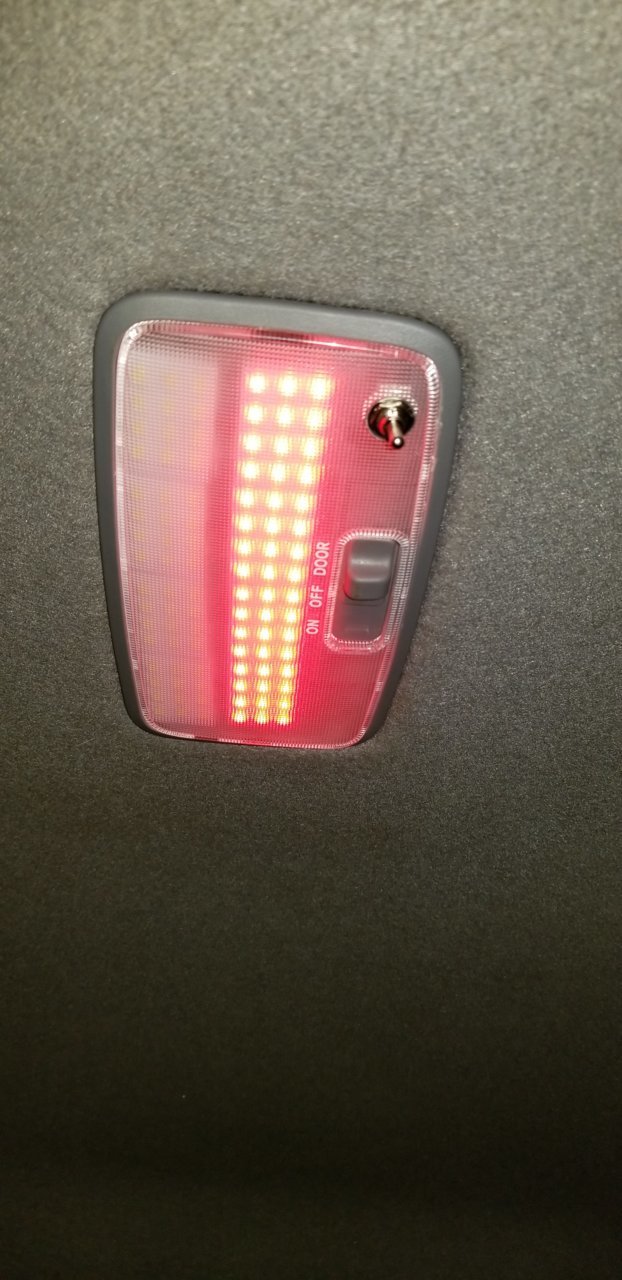

    Made a switched color red/white dome light to go with my switched color map lights.

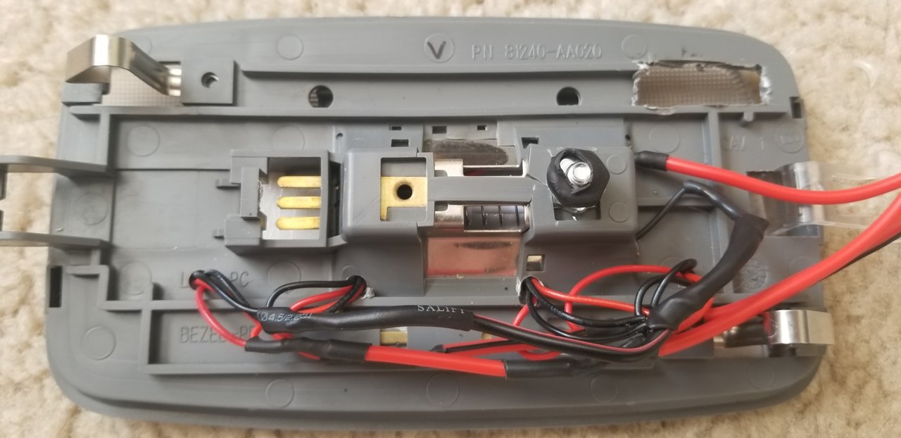

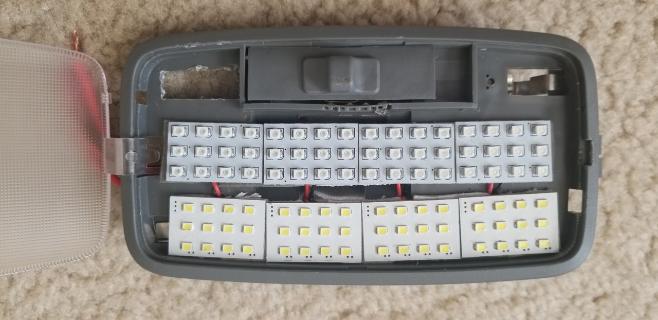

    @308savage
    I bought 4 red and 4 white 12 SMD LED Panel lights on ebay (links at the bottom). I chose the 12 SMD LED because I measured and I don't think the factory housing would hold a larger LED.
    I mounted them in the factory housing and drilled a small hole to run the wires into the back of the housing. I then wired all the grounds together, and connected it to the ground on one of the festoon adapters which the LEDs came with.
    I connected all the red + together, and all the white + together, then ran each of those to a mini SPDT switch (I personally prefer a switched hot instead of a switched ground, but to each their own). So, one pin of the switch receives power from the festoon, then the other 2 pins are connected to the + side of the LEDs.
    I had to dremel out a small channel for the back of the switch to stick through as it's too deep for the factory housing. Then I drilled a hole in the lens to mount the switch to.
    Here you can see the holes I drilled for the wires, and the rectangular cutout I made for the switch to poke through. I don't have a photo of the finished wiring on the switch, but the 3 red wires at the bottom of the photo were connected to the switch:
    Red - https://www.ebay.com/itm/2-x-Brilli...terior-Map-Dome-Door-Trunk-Light/130697513592
    White (I'd personally look for a different white, these are much more blue than I'd like. I'd prefer to find something in the 4000k range, these are probably ~6000k) - https://www.ebay.com/itm/4x-White-1...A9S-Dome-Festoon-Adapters-12V-US/171574618646
    Switches - https://www.ebay.com/itm/10PCS-Mini...ition-On-on-Toggle-Switches-M111/401299688736
    Voltron4x4, siundon, BadDNA and 4 others like this.
