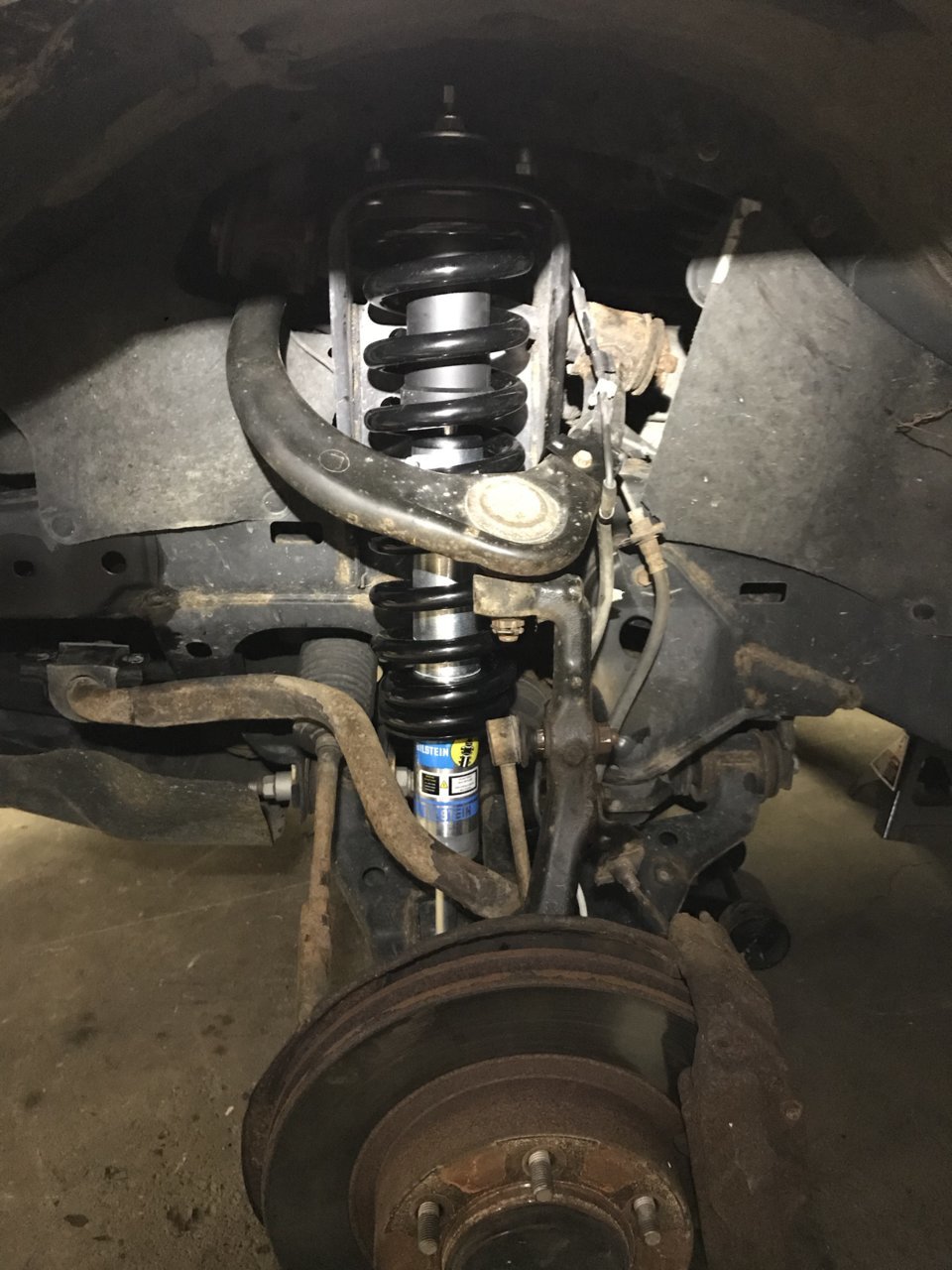

    I hope UCAs are coming soon! Might be just the picture, but the angle of your OEM UCA is sketchy. At full droop it may contact the coil.

    I was on a roll too! After I fought with the driver side, I finally got the old coil over out.. That damned sway-bar and UCA

    It isn't just the picture. There is a lot of droop at the moment and is in contact with the coil. I am hoping once I'm done it will settle

    Even after settling, you'll still hit max droop and contact the coil. UCAs are a must if running 5100s with Aftermarket coils. I have stock coils on mine, and I'm safe at the second from bottom notch. I can't go higher without UCAs. I'd definitely start doing your homework on this. Especially with a top hat spacer. There was another thread where someone was running 5100s on toytec coils I believe with spacers and it was causing his UCAs to contact the coils, which is no bueno. If yours are touching it's also no bueno. I'll be going SPC UCAs and OME 886 coils on down the line.

    I went with the 884 coils from @HeadStrong Off-Road so that I wouldn't need to replace the UCA's but I thought it was due to alignment issues at 3" or higher lift. I didn't think that they would hit the stock UCA at full drop. I have a buddy that did this kit with 885's and didn't have any issues. He had a shop install it though so maybe he just never knew..

    Not always true. Depends on coil length. Typically springs under 390mm are fine.

    Would this contact be corrected after an alignment?
