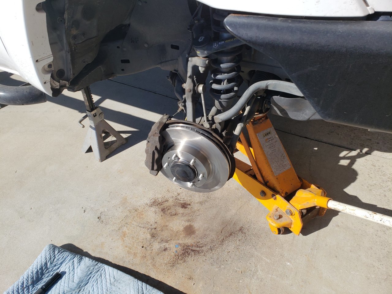

    I ordered new front hubs with wheel bearings last week from 05Taco4x4. Did the install today and also put new rotors and brake pads. Truck runs smooth as silk and stops velvet smooth too. I thought my tires were getting loud but it was my passenger side bearing ...lol
    Pretty easy job with air tools!

    How many miles you get out of the original hubs? My wheel shakes murder from time to time but smoothe other times, im almost at 90k miles. I havent lifted her up to diagnose yet as i have another car to drive but may this weekend.

    I'm at 94k miles. I was getting wha wha sound. Jacked up taco and spun wheel and could hear growling dry bearing. Passenger side was worse and close to complete failure. Metal particles on bearing when I pulled it off.
