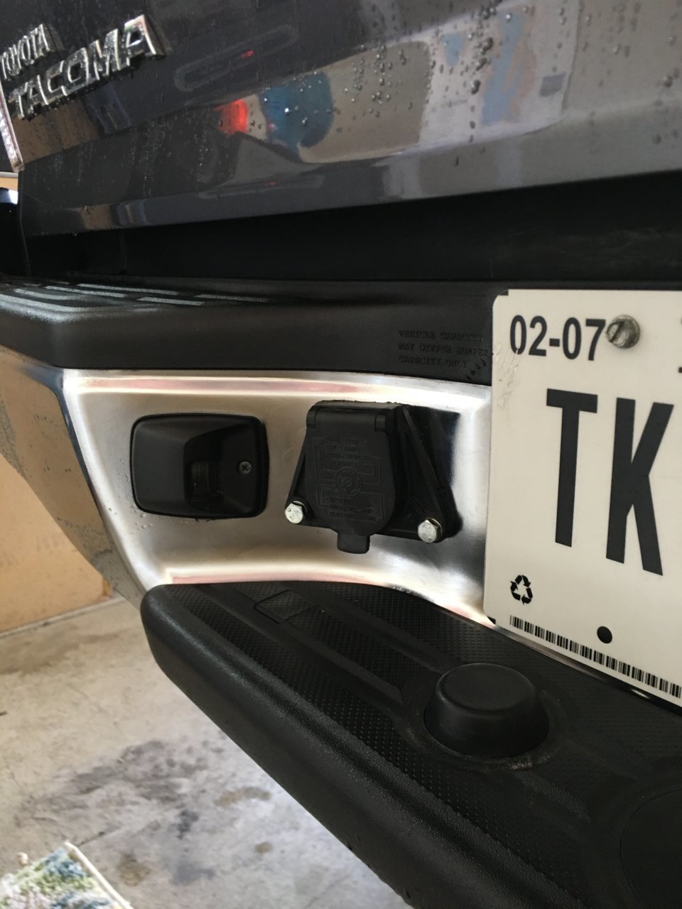

    All you need is a hole saw to fix this issue :)
    Wheel hubs, drive shaft, carrier bering, u joints, drive line angles, that's what I've got off the top of my head.
    Its actually required by law to have red reflective on the back of your vehicle. so yes very illegal. He could be ticketed or even worse towed.

    what size is the hole saw for this? Keep putting it off lol. I figure maybe I'll bang this out one day and paint my chrome, since whatever chrome is left will be coming off or being painted. De-badging to replace with decals and painting the front emblem to match.

    I want to say 2" but I happened to have one laying around when i did the project. I just disassembled everything and eyeballed if it was big enough. Ill measure it tonight and let you know if its different than 2"
