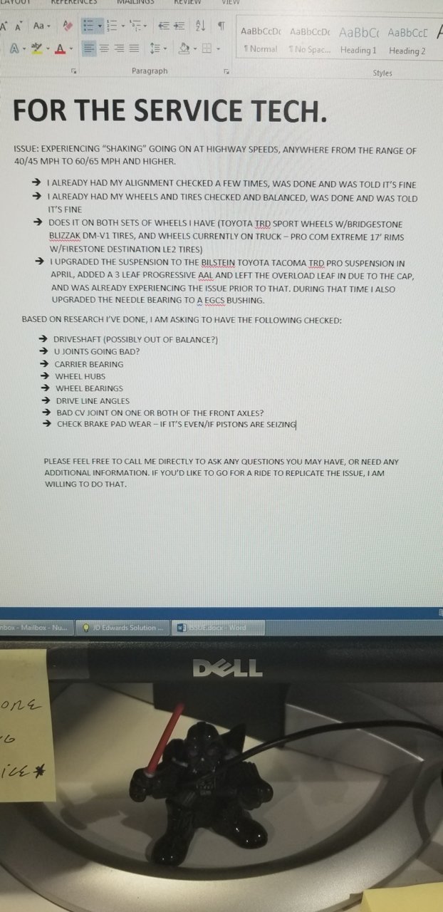

    Rick_Taco

    Here's what I have going so far. Putting together a letter to bring with me, to hand to the person at the desk and taping one in the inside of the truck for the service guy (suggestion from @Breakfast Taco and @vssman).
