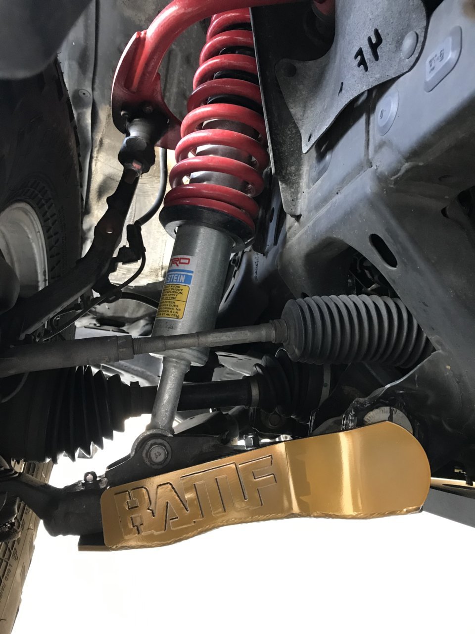

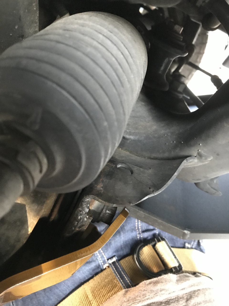

    I notched my lca skids to not interfere with my ifs skid.
    Well there's your problem. Trying to mate a real CAI to a fake one is nothing but trouble.
    Protects the cam tabs.

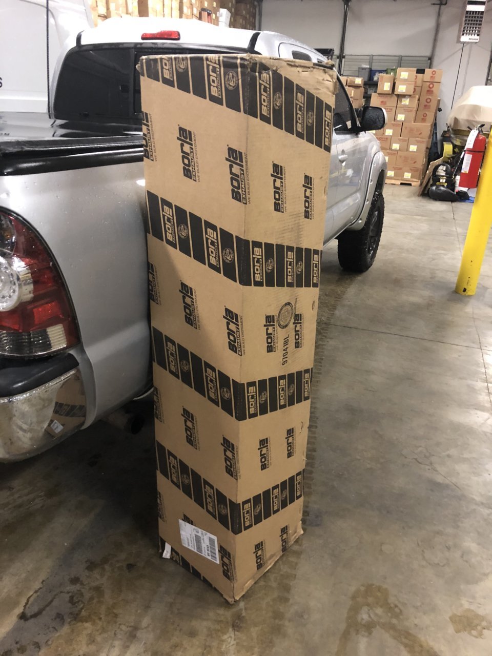

    I have the borla, and like it’s tone a lot.
    Idle is almost silent, but it opens up a bit throughout the rpm range.
    It’s not extremely loud like a flowmaser or magnaflow. But the upper rpm definitely screams.

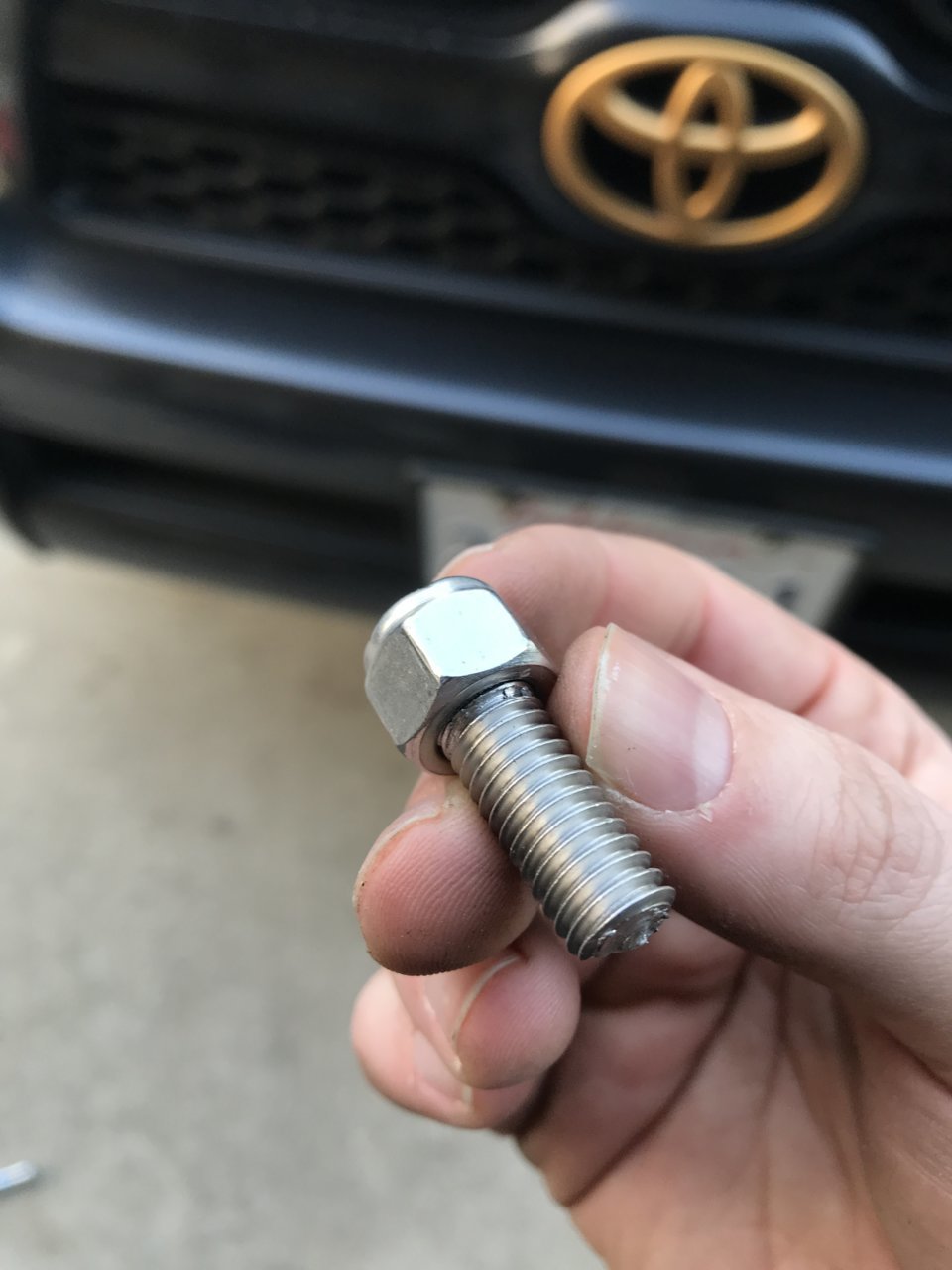

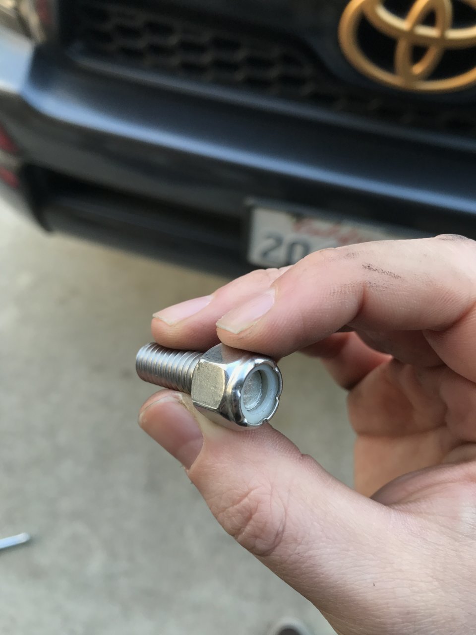

    I deal ALOT with stainless nuts and bolts and it still amazes me how they can bind together. But that is soft stainless, so it doesn't take much to marry them.

    Yeah I’ve learned over the years to use some anti seize or something when assembling stainless under pressure on heat or anything generally

    Yeah I did a little research this evening and luckily was able to return the rest of the bolts and nuts. In my youth, I never knew Stainless galled like that. I think I’ll give the old hardware an oil bath and just use that.

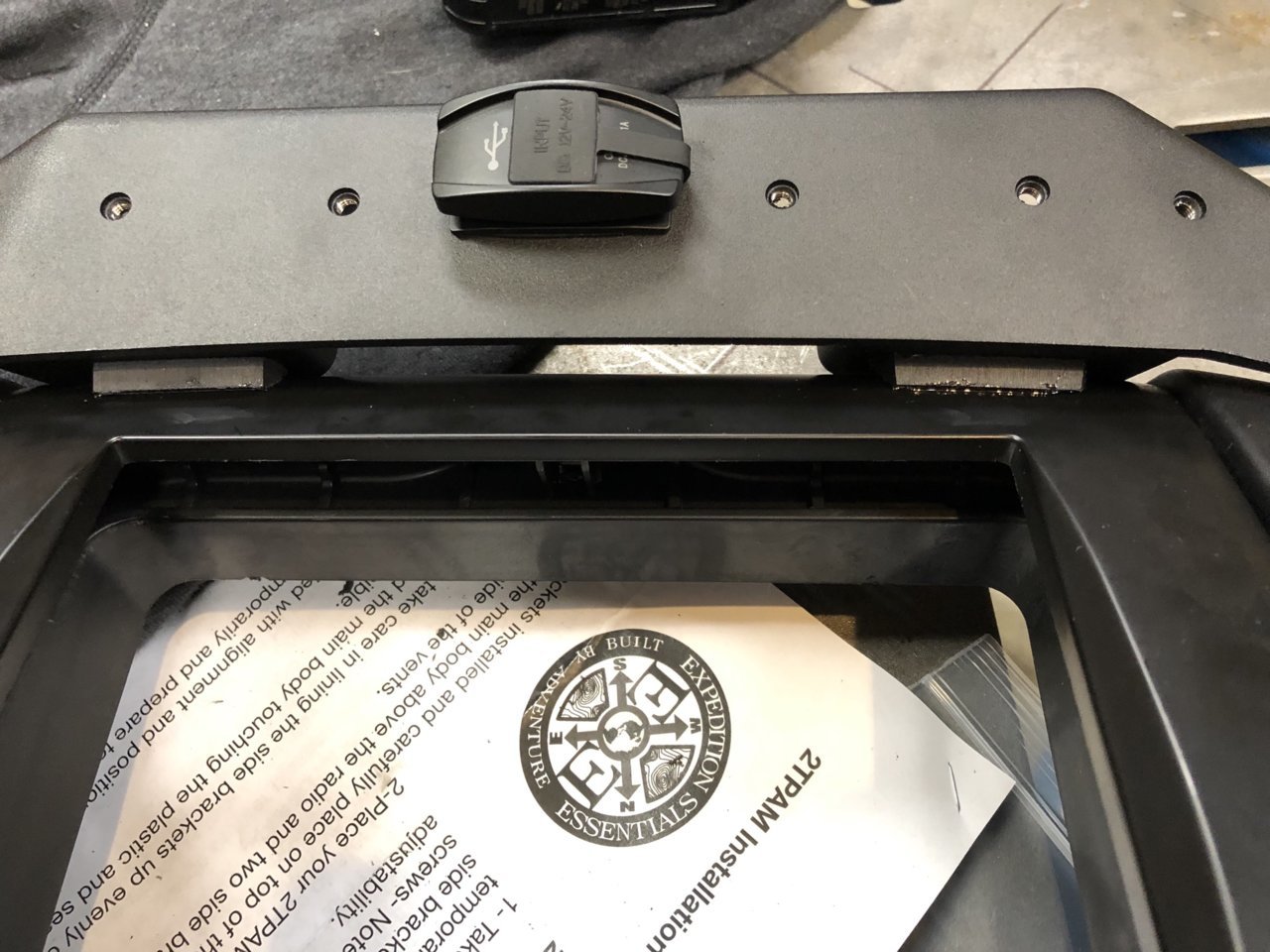

    Installed my Expedition Essentials TPAM today. Turns out if you use an aftermarket stereo with aftermarket dash trim it doesn't entirely fit perfectly. So had to make some spacers in order to make sure it had good tight fitment so when the bolts where tightened it would line up correctly. Wasn't a huge deal to make, and love having a good easy place to put my phone.

    Borla makes some great exhausts. How loud is it?

    Supporting the weight of the truck driving around is completely different than bashing it on a rock while wheeling. Once the arm is bent, it's structurally compromised and needs to be replaced. These help prevent that.

    Cant forget about those wicked speed bumps at the mall. They can rake out a lca as well.
