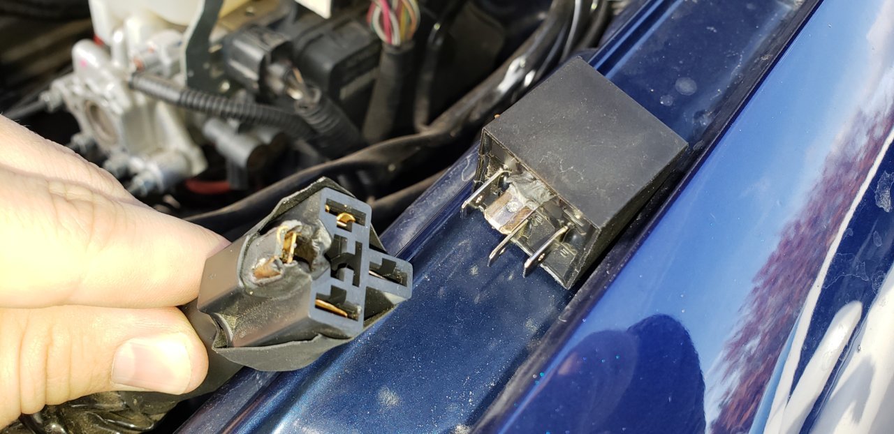

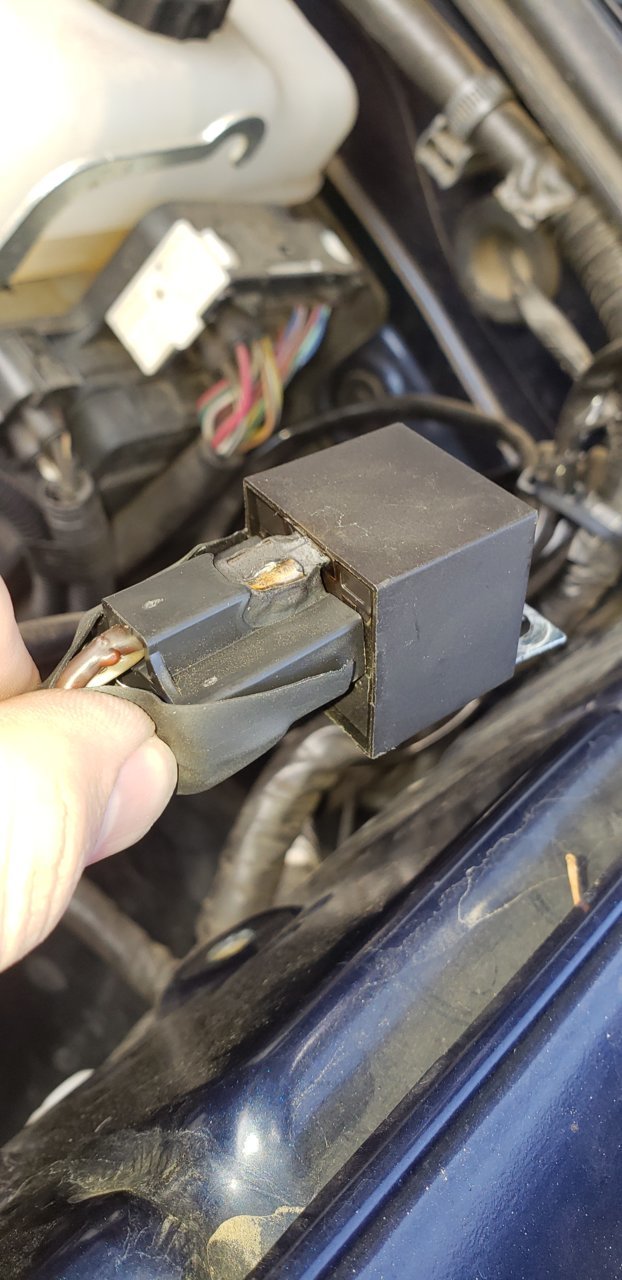

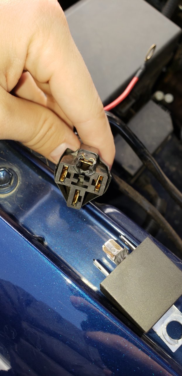

    Has anyone else had their light bar relay melt? I've had it for about 6months and never had a problem. It was wired correctly.

    Which plug was the one that melted? Power from battery?

    Too much draw off the relay???

    Trace that wire. Either u used brown wrap or tge wire looks burndt as well. Look for chaffed wires.

    You a intermittent short or a high resistance somewhere.
    I'd look for a pinched wire first.

    Only time I had that happen was when I didn't use a thick enough gauge power wire that had proper insulation or there was a Nick in the power wire somewhere causing a short.
    Your culprit is shown in your first pic. Melted wire. Need to change it. Go with lower gauge wire (thicker wire) with better insulation. :)
