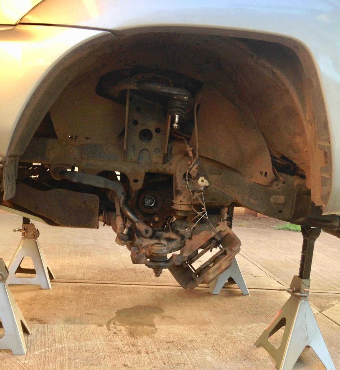

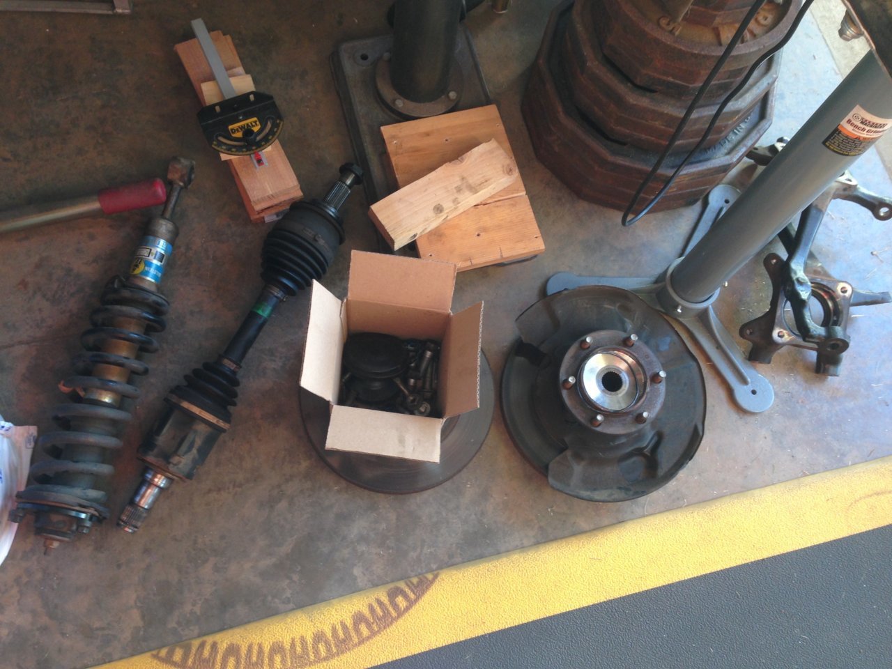

    -Pulled both spindles off to have the Total Chaos gusset kit W/Swaybar welded on this week.
    -Also installed the ECGS bearing because I was getting vibes from my front end. CV shaft came out decently easy.
    -I will finally put on the 1/4 spacer on the driver side to take care of the "TACO LEAN"
    -Will replace the driver side sway bar end link when I get the spindles back because I had to cut the nut off.
    -Finished the Cab Mount Chop I started 6 months ago. I'm running 265s right now it's in preps for larger tires one day.
    -Found out my stock rotors holes where the lugs go through have been wallowing out and that's why I get a clunk when I hit my brakes 1st time, means the rotors are rotating on the hub. So it looks like I'll need new rotors. Time to upgrade.
    -All the red is not rust it's red dirt stains. It's a Hawaii thing.

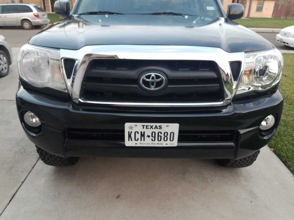

    Anyone know if it's possible to remove the lens, and clean out the water?

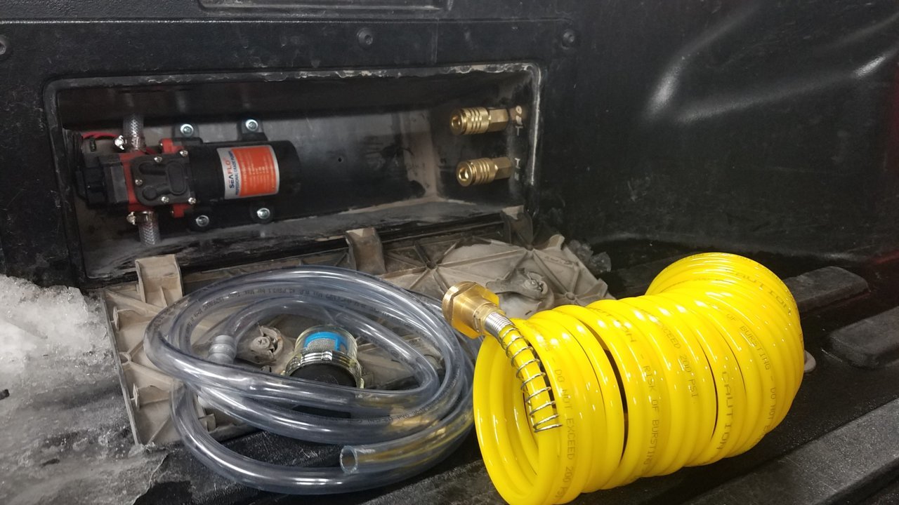

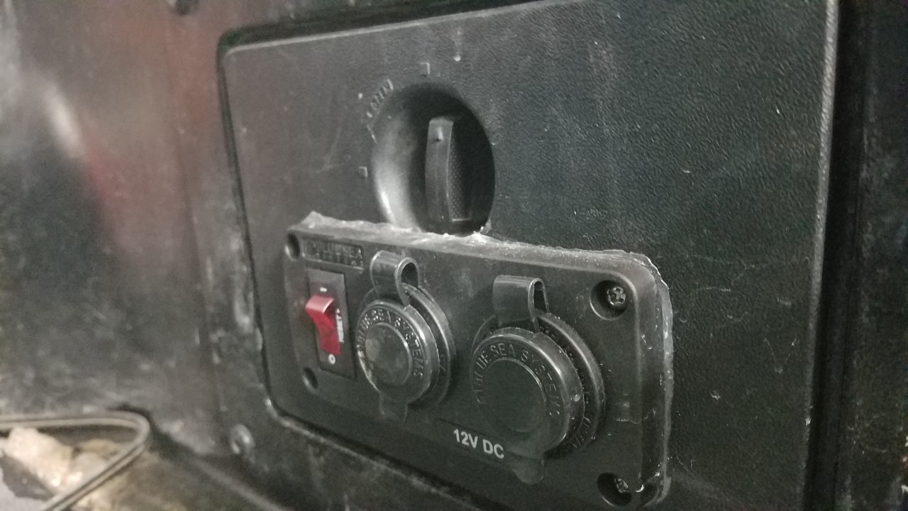

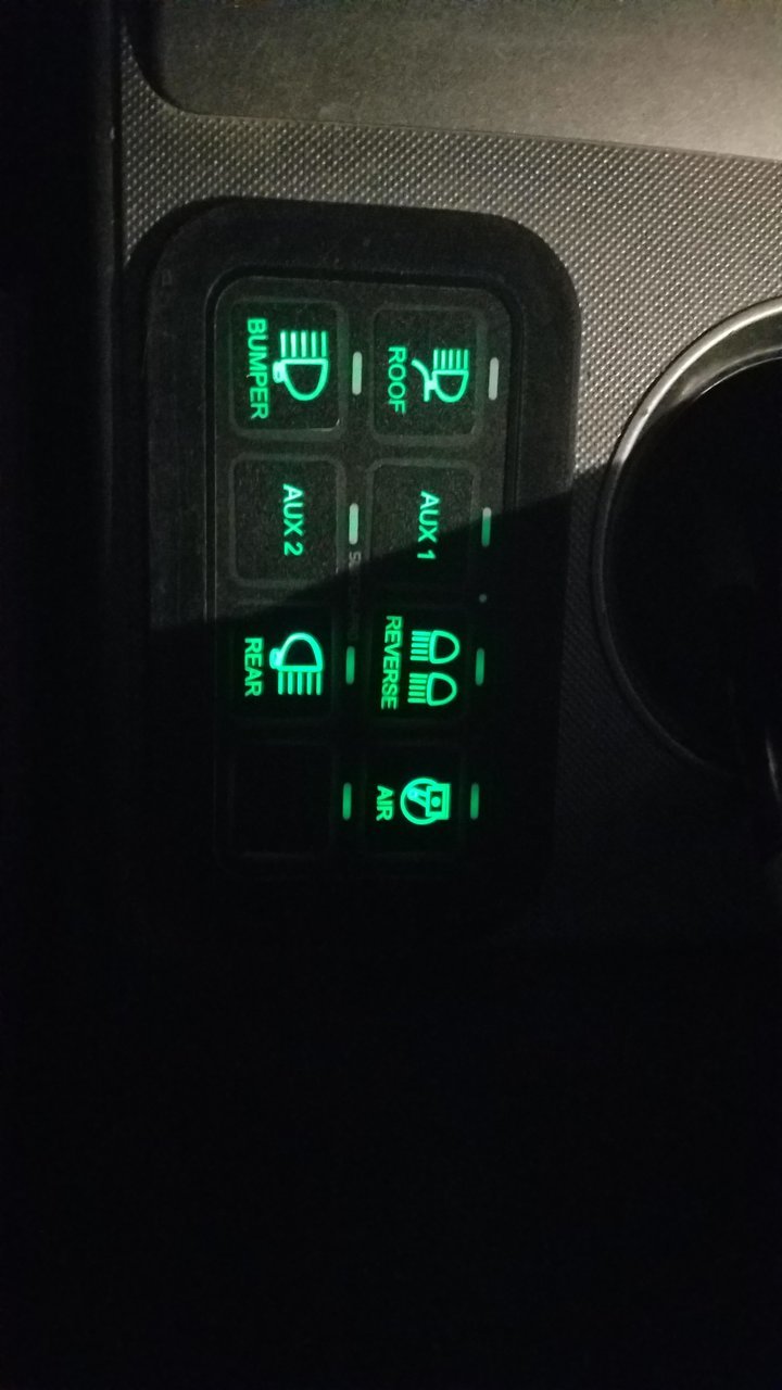

    Added my switchpro decals, a water pump from @ProForce , 12v power, and installed @fatfurious2 's old ARB fridge. Busy night!

    Is a compressor in the bed cubby? If so what make & model?

    Yes its possible, remove the bulbs for the DTRL an side markers, if possible grab a small clean funnel insert in one of the holes an use a blow dryer on a low setting to blow the moisture out.:thumbsup:

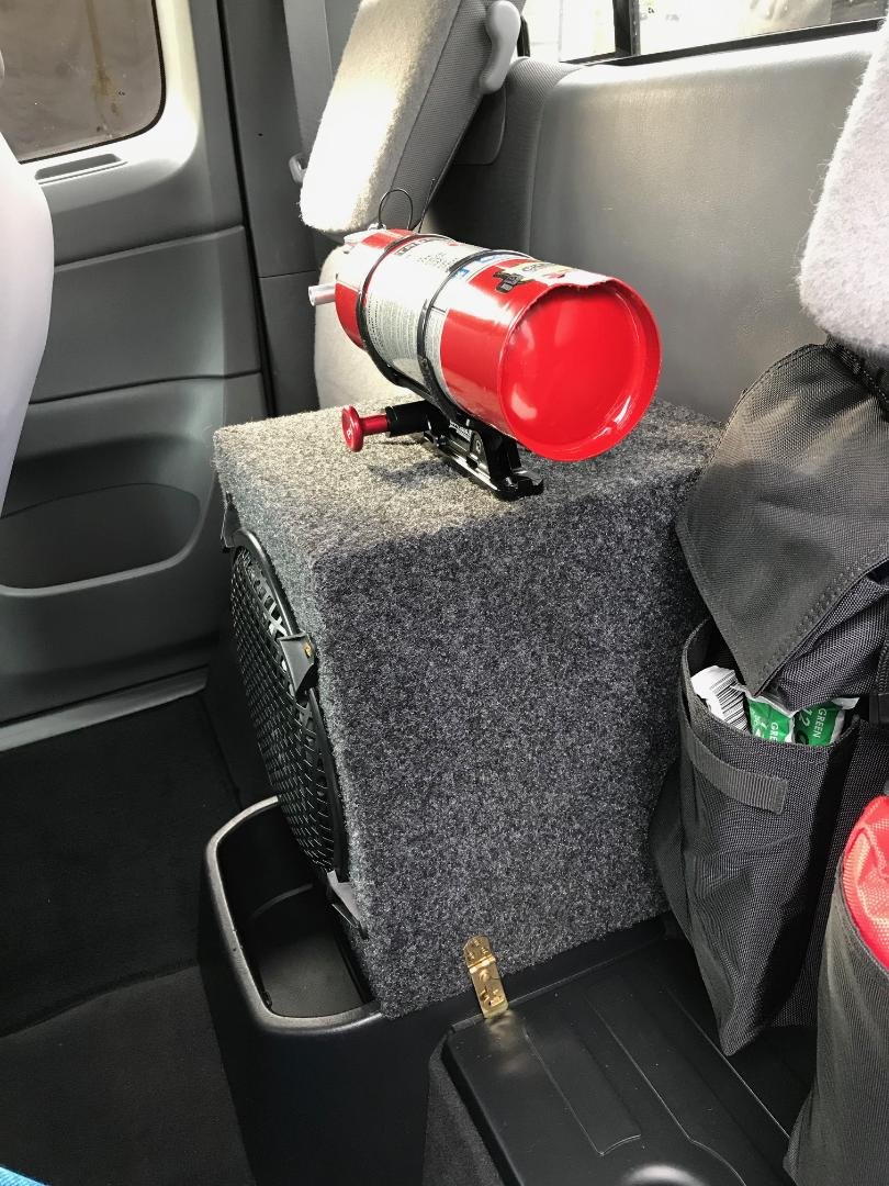

    New anti fire device and mount..and the music sounds much better

    That's actually a nice idea, would it be easier to remove the entire unit?

    I probably wouldnt you may have to readjust the headlight assembly. I would remove the battery for extra working room though if driver side, passenger side Id move windshied fluid resi though its just 2 10mm bolts.

    yes its quite easy actually

    wow that's a brilliant idea! I would do this too if all you want to do is remove the moisture inside.
